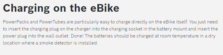

Now I am finding contradictory information: some manufacturers say to do the reverse (plug the charger into the battery first).
I checked my Bosch manuals for my charger and battery. Neither are clear about which to do first. However the illustrations in the manual for the charger shows the charger being plugged into the wall socket first; the illustrations in the manual for the battery show the opposite.

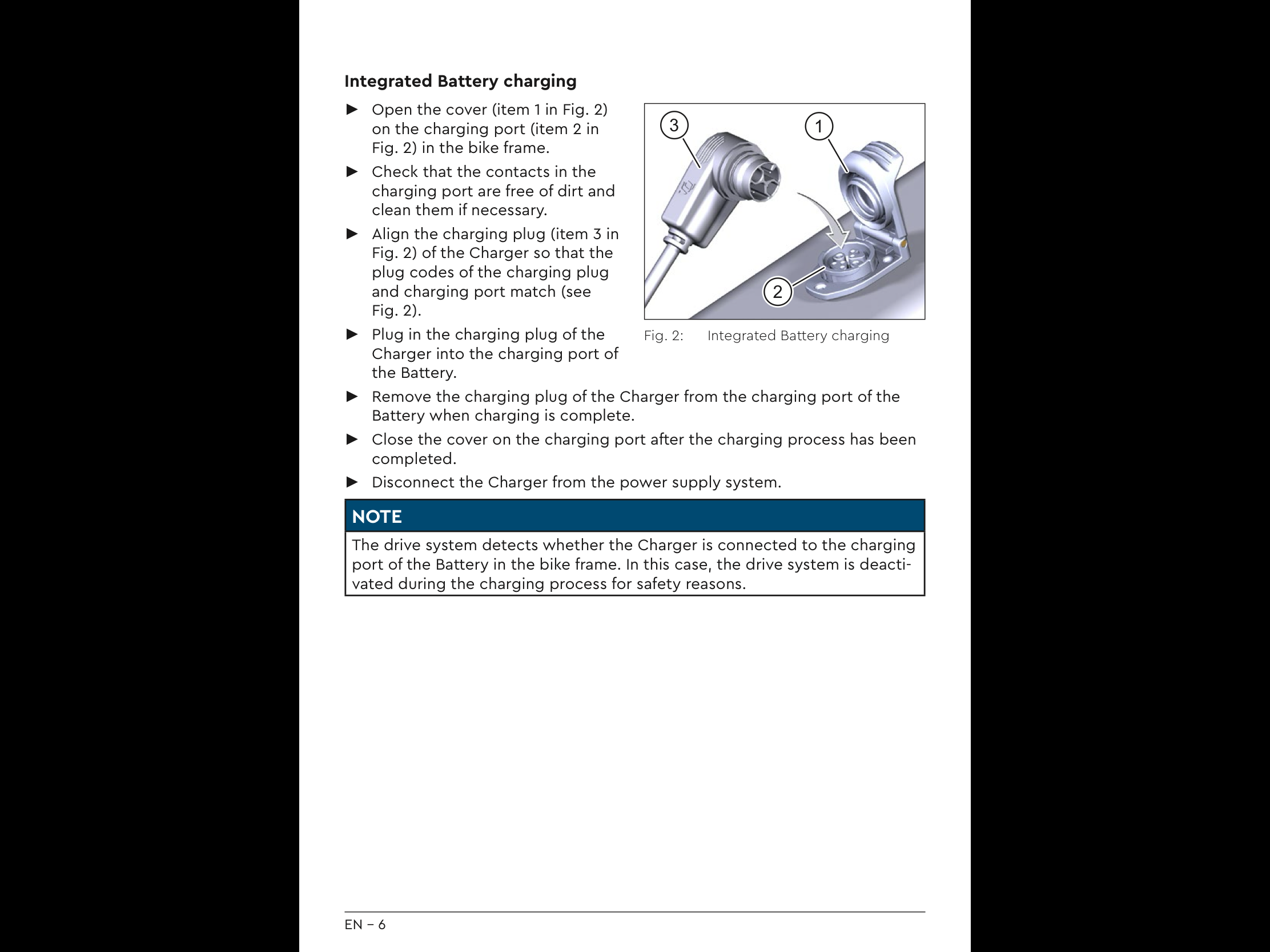

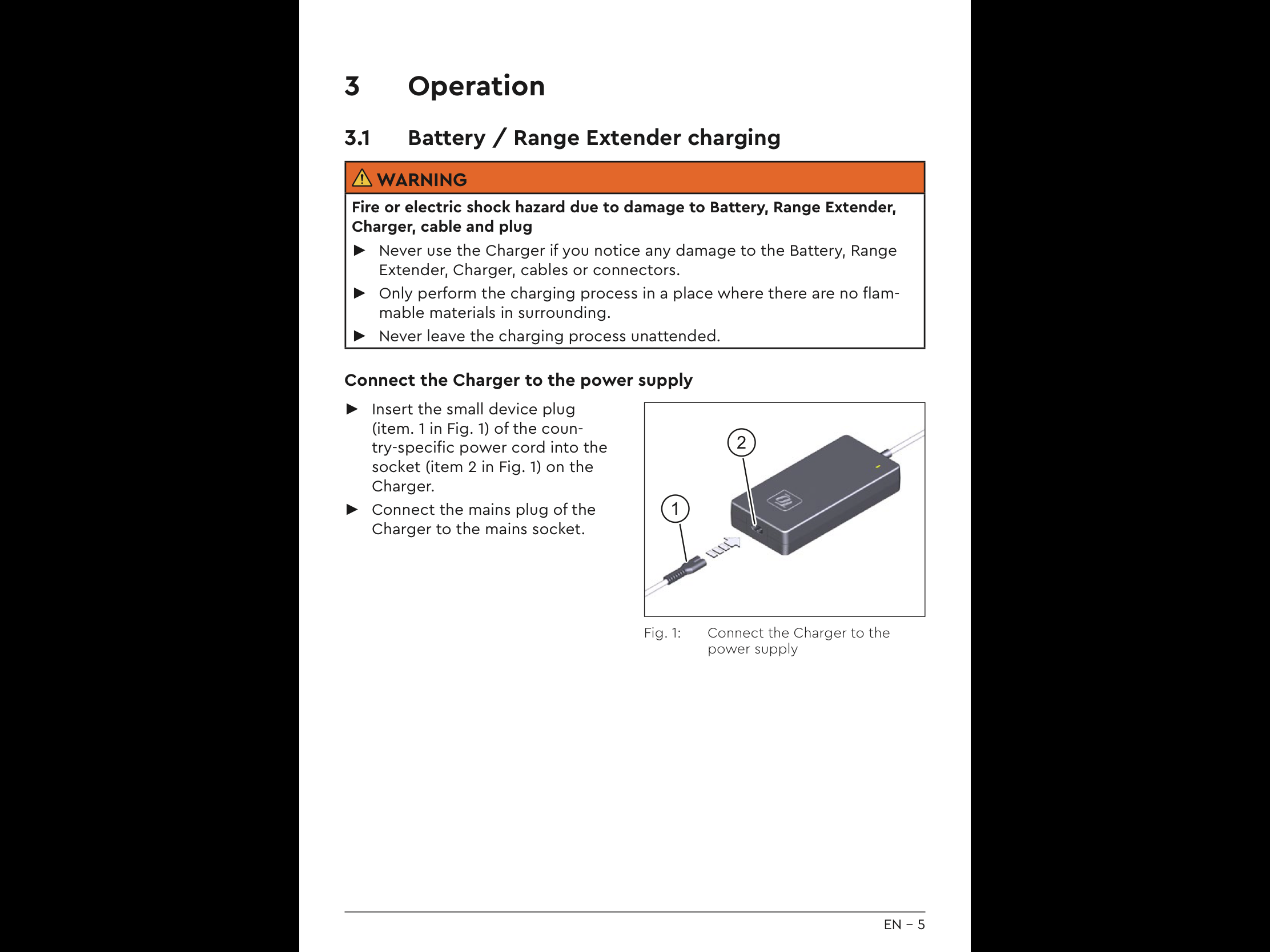

I have the same Bosch manual for my battery.
But the manual for my Bosch charger suggests the opposite:
So here in the manual for the charger, Bosch suggests the first ("initial") step is to plug the charger into the wall, which seems to contradict what's written in the manual for the battery.
