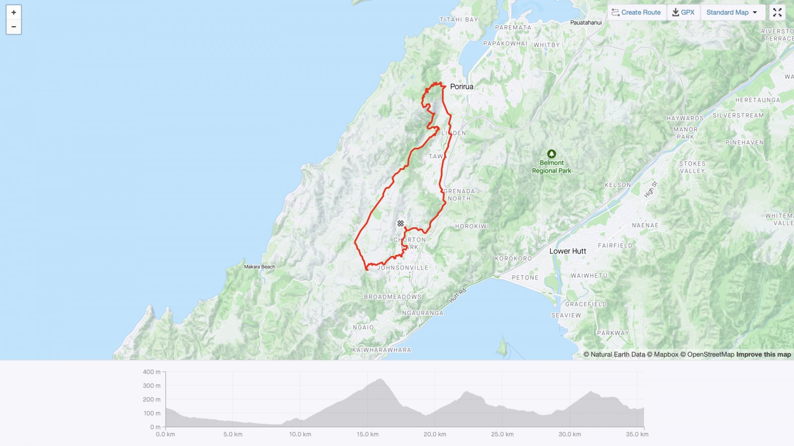

My story is similar to Dave's, I've had my Stance E+2 since June replacing my 2020 Fathom and have now covered over 1700km. The Stance is Giant’s entry level full suspension EMTB and although not top of the range component specifications, all are fairly decent considering the overall price of the bike. In comparison with other brands Giant's "display" is pretty basic, the RideControl One uses LED’s to show battery power and assist level. I have purchase a Garmin Edge to provide better info but you can also connect to your phone.
The suspension is good and suits my riding requirements (trails and downhill MTB tracks) with Suntour XCR forks with 130mm of travel and a Rockshox Monarch R rear shock with 120mm of travel. The Shimano Deore 10-speed setup (11-46 cassette and 36 chainring) provide all I need and seems to work well with the Yamaha motor. The brakes are Tektro HD-M745 Orion 4-piston with 203mm rotors (F) and 180mm (R) providing plenty of stopping power for me as I am not a small person.
The 500Wh battery is OK and one of the reasons I stepped up from the 400Wh on the Fathom. Personally if I was looking again I would aim for over 600Wh. Giant's SyncDrive Sport motor, a Yamaha Motor running Giant Software (250w 70Nm tq) performs well and is quiet, a friend with a Commencal Meta (Shimano) even commented on it's lack of noise.
My experience has been great with the only niggle being one instance of what is being referred to on here as "the sudden off". Reseating the battery fixed this and I've done nearly 1000km without further fault. I recently had an annoying click/squeak that turned out to be the swing-arm pivot / lower shock mount bolt/nut loose.
The current Stance appears to be a compromise between value for money and quality that I think Giant have managed to pull off very well. It is probable the most affordable full suspension EMTB currently on offer from one of the "big" manufacturers. I would definitely buy it again.

I don't think we can talk about range without referencing elevation and the environment. I live in Wellington which is New Zealand's "Windy City", it's also a town built on the hills. As an example my normal ride is a 1hr 50m loop from home, but can be 10m longer, I climb 3 big hills on this route and can finish on anything from 10-15% battery remaining (Garmin Edge 830) down to the flashing red at 1% depending on headwinds. The route is 34km and elevation climbed is 750m. My time and battery usage can vary a lot depending on the headwind, typically here we experience wind speeds of 20-45 km/hr. I have finished with a whopping 20% on the rare days of no wind.
As a comparison one of my other favourite rides is relatively flat 40km ride with only a 130m elevation climb taking around 1hr 30m, this is on a mixture of gravel and tarmac paths alongside the Hutt River. I'm usually able to do this with 20-30% battery remaining dependant wind speed.
I usually ride using assist levels of 2-3 with only the occasional 4 on a steep hill section and never 5. I'm not a small guy at 110kg (240lbs). One of the things that definitely effects battery usage in maintaining a high cadence.
