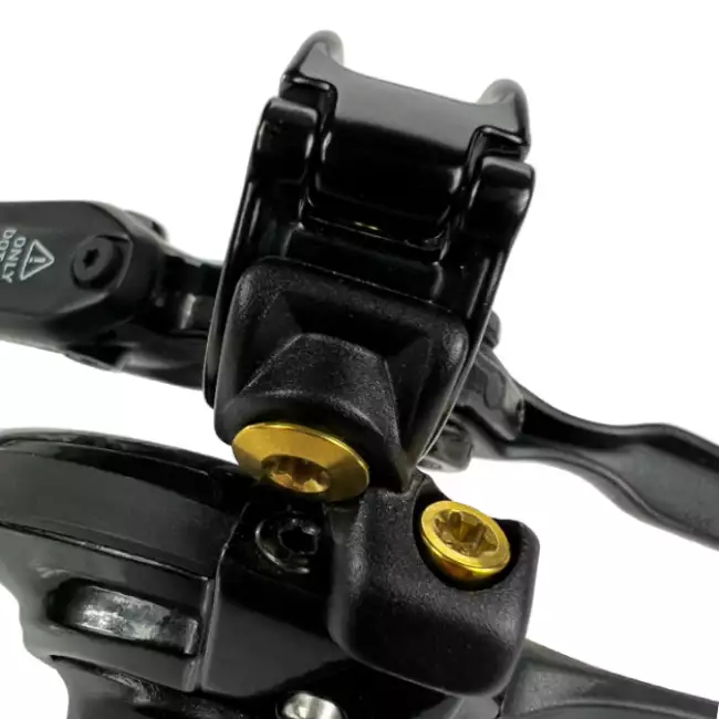

Two things have alleviated my pins and needles in hands. I moved my brakes further down so that my wrists were not as cocked back when on the brakes. I then fitted the ridiculously expensive Revs grips. The combination of the two, the latter on day three of an Alps trip, have massively reduced the problem.
