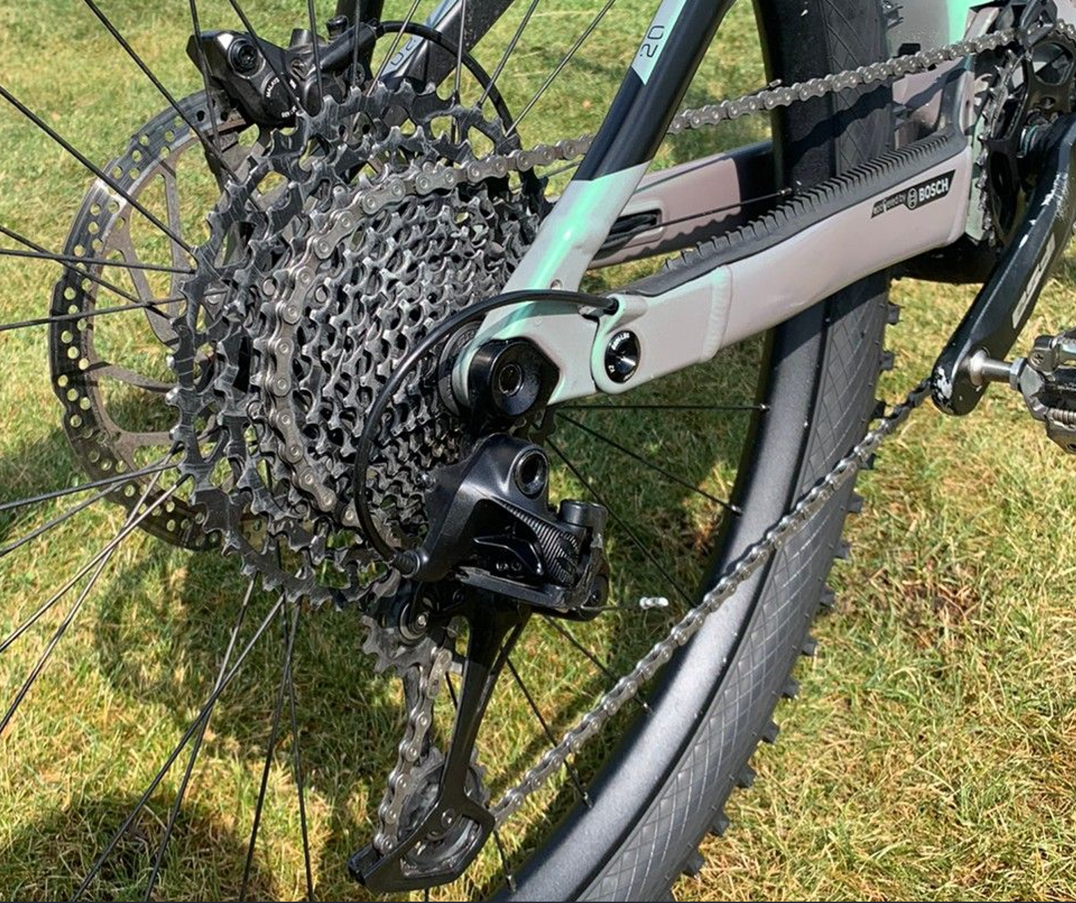

Hi,
I need to replace the chain, cassette and brake pads.
As I can see from the Scott webpage, this should be the original parts:
Chain​
Shimano CN-M6100
It doesn't say how many joints there is on the chain.
Cassette​
Shimano CS-M6100 / 10-51T
What to think about when replacing this regarding quality and lifespan?
Someone says SRAM is better, but everything on the bike seems to be Shimano.
Is this the original parts mounted on this bike? I bought it used, it's about 4 years old.

Hi Kristan
The difference between sram and Shimano parts is subjective imo. I use both. There are different levels of quality within each brand however.
Sounds like you’re doing a basic service, so you’re going to need some basic knowledge and a few simple tools. (Ie; Allen keys and a chain break tool.
Brake pads; clean the calliper, rotor and replace the pads with the same compound. Check for rotor wear. Use a breakin procedure for new brake pads.
New chain replacement; use the old chain to measure or count the same number of links. You’ll likely need a chain break tool. Use a new quick link.
Cassette; depending on the wear, you may not need to replace this at this time. (Ie, 3 chains for every cassette).
Check the chainring for excessive wear.
Don’t contaminate the new brake pads or rotor. Only grease and oil things that need oil or grease.
I’m probably missing many steps here so YouTube can be your friend.
