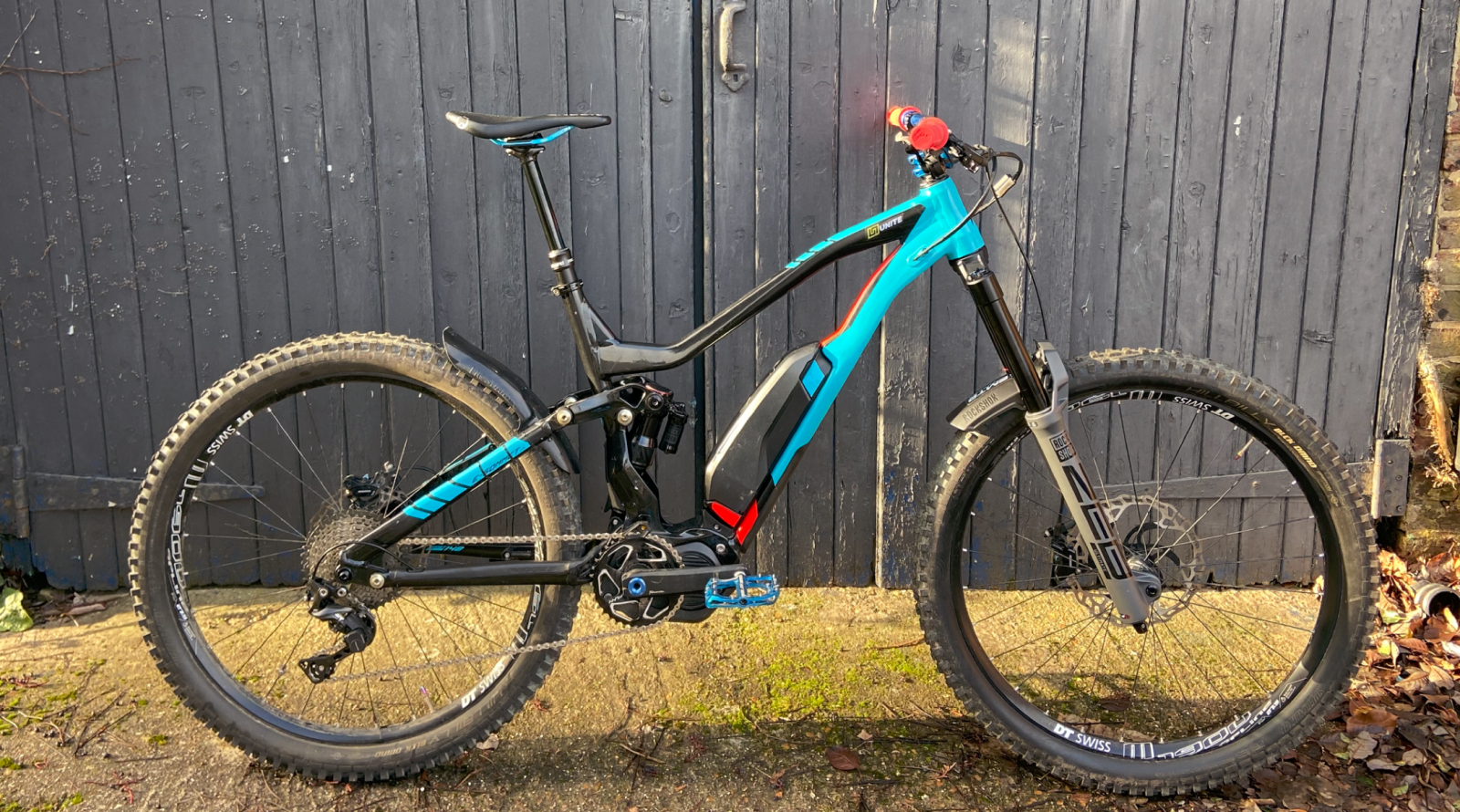

Mine is still going strong, bought in April 2018, though a bit like triggers broom the only original parts left on it are the frame, wheels (though they have new bearings at both ends) and battery. I am about to replace all the bearings and related hardware on the bike, still on the originals which have survived remarkably well, but after 3 British winters they are beginning to go. I never invisframed it or anything, and I am not fussed about a bit of trail patina, but paintwork has held up well considering Vitus haven't had the best reputation for this down the years.
I had a replacement motor in late 2019 - I warrantied it via my LBS direct with Mafsion, as CRC where useless at getting back to me. At the time of the replacement motor I was told that it came with a new 2 year warranty, that wasn't tied into to the age of the bike. Thats the only problem I have had with the bike, and I still love it - I have ridden most of the latest bikes and still wouldnt swap my E-Somett, and have just invested in the new 630wh external battery.
Inevitably the motor will go pop again at some stage, I am confident if it goes within the 2 years since it was replaced it will be another warranty, if not I will use have to fork out for a new one, though it seems like options for repairing them are getting better now.
Not sure how many miles it has done as I binned the main display ages ago, but got to be somewhere around 4k

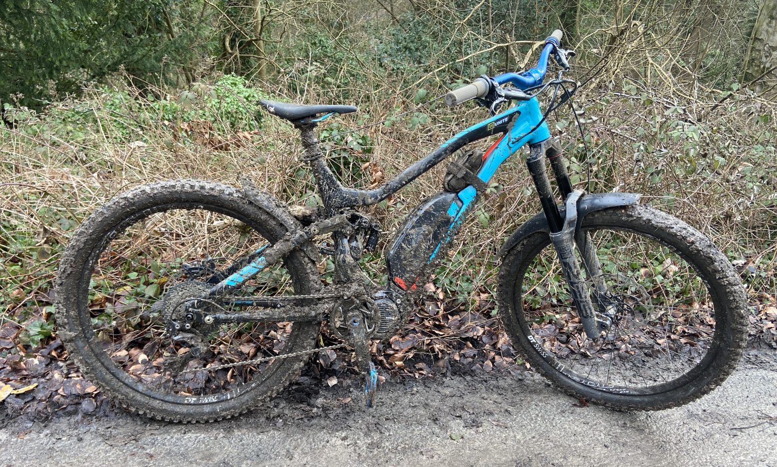

Much the same as R120 also April 18, except I'm on motor #3 and nothing original but the frame/forks which look like new cos I taped it ? . What a crackin bike, can't decide whether or not to sell it now I have a new one...not sure what it's worth now either ...

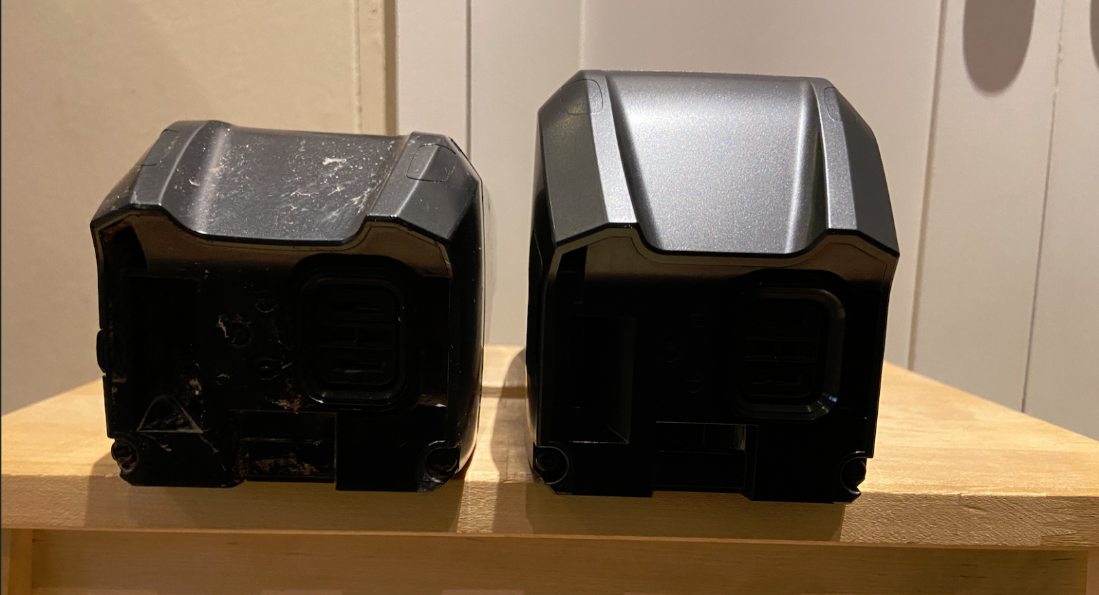

Hi r120
Is that pic with the 630wh battery?

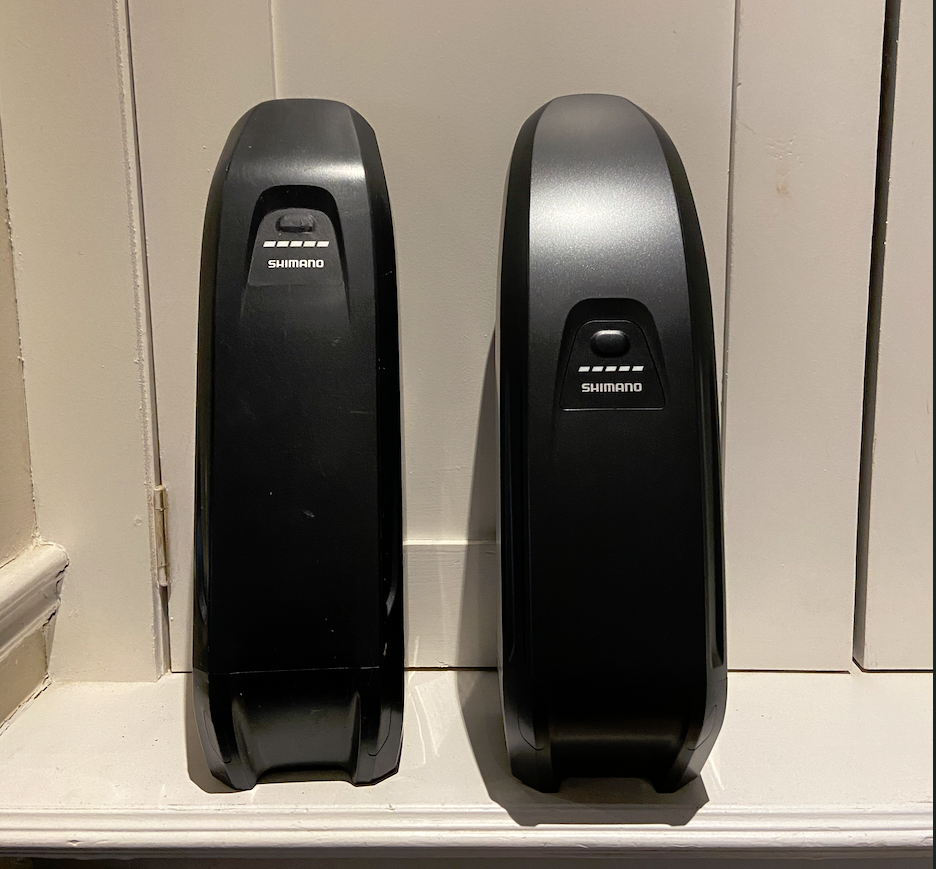

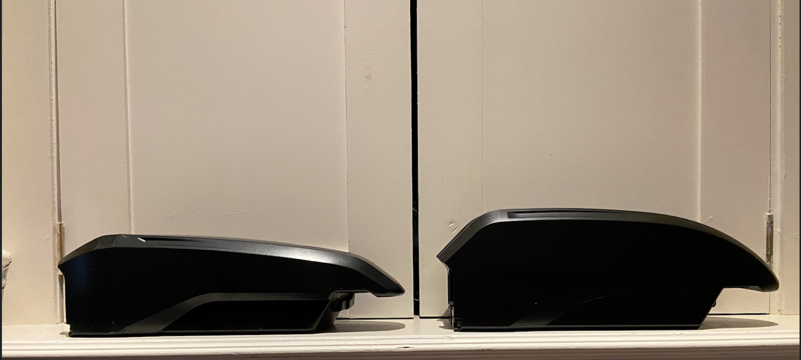

Extra power output from a 1kg increase in overall weight ?
You serious bruv? ?
It'll still be lighter than most internal 630wh battery Eebs
Mike D.
Sep 19, 2020
197
389
Alpujarras
Ah. I see. So... the "power output" is the same but there's just more of it?
Is there any way that the weight of the bigger battery would affect the range of the ride given perhaps the higher usage needed to heft it around (is what I mean)?
9,190
You notice the extra weight but to what extent will depend on how you ride. For general trail riding it’s not noticeable but when getting a bit more rowdy you do.
I still mostly ride with the smaller battery, only going for the bigger option if looking at at an over 25mile ride.
