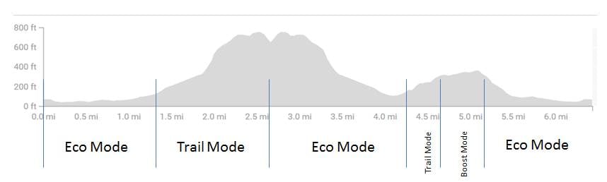

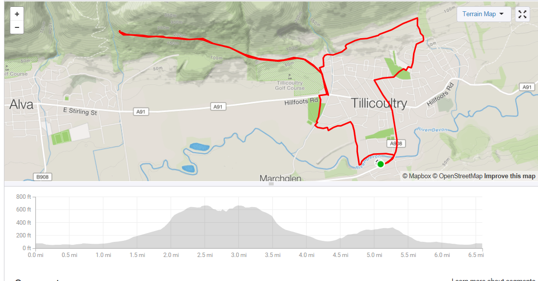

See below for my route - summary is 950ft of accent, 6.5 miles in length which is cycled in the Eco mode for 4.8 miles(eco mode on the road) – trail mode for 1.2 miles (trail mode is uphill on single track) and boost for 0.5 miles (boost mode is across a field). Bars on battery used 3 :-(.... not too good
For the record I am 88kg and cycle with a cadence of 80-90.

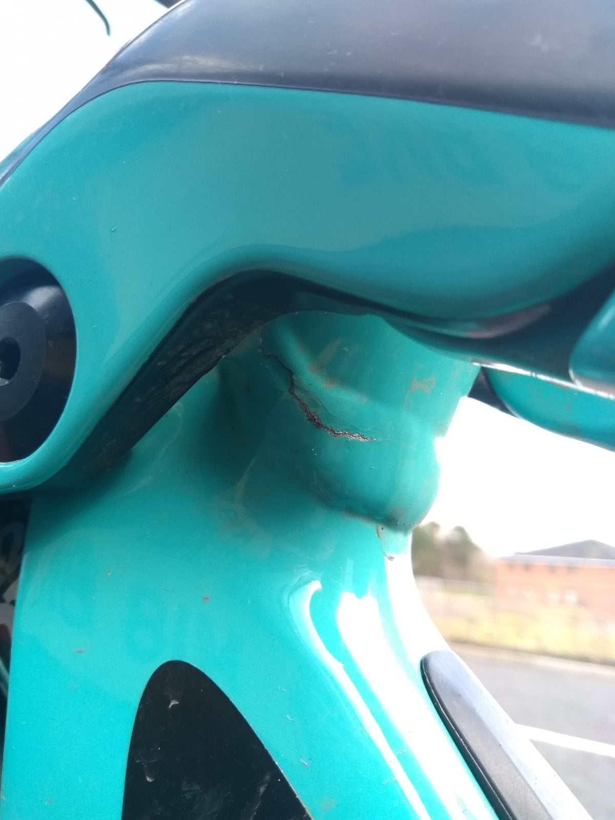

Mine went back to Raleigh for 2 months and came back with a new frame (old one had a crack in it) and still with the same fault (as mentioned in other post) ????
Still in limbo between my local bike shop, Raleigh and lapierre.... Fookin tamping
Mine goes back tomorrow for 2 weeks - second time back - fingers crossed they fix it.
BTW where did the frame crack?
They didn't show me pics but said it was around the linkage somewhere ?.. upgrade me to a team frame (with all my old components) and funnily enough it had the same fault as it went back for ? I think they thought it would magic away if they gave me a new frame ???

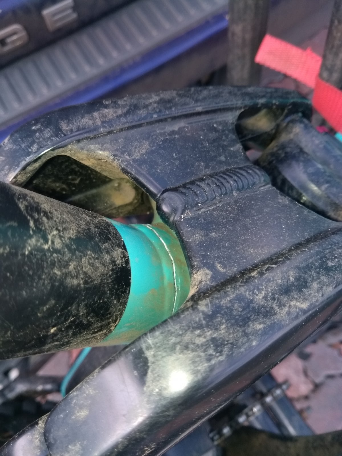

Hi Gareth, quick update, bike we t back to Raleigh on Friday, battery is the least of my issues, cracked the frame almost in half on the seat stay. Requesting a full new bike or refund. Watch this space ...

Update on the charging issues - before i proceed I shoudl also state that the bike snapped in half below the seatpost. as a direct result i requested a brand new bike from raleigh/LP, there were no quibbles from there side and because of all the hassle over the past months they upgraded the bike from a 727i to the 927i FOC. Excellent custmer service.
Anyhow I have had the bike for over 2 weeks now and continue to do the same loop as before - 6.5 miles with 950 ft of accent - time onthe bike aroudn about 55 minutes. Great news is that I can do 4 loops of the circuit on one charge of the battery giving a total distance of 26 miles (40km) with 3800 ft of accent - all modes were used on the bike..... profiel for one circuit is below.
this is where mine has just cracked. after 8 months too! it sounds like they are going to replace the frame. but I'm seriously worried the second one isn't going to last either. it's not like I've done anything different from my other bikes. by previous specialized pitch is still going after 8 years and the bike before I had for a similar time!
Hi Rich, funny that you have just posted, I have just sent back my second bike for the frame cracking, sand place and it's happened within 2 months. Raleigh have spoke with LP who have stated that it was a bad batch of frames and agree giving me another new bike, the did offer me the xduro nduro 6.0 2019 bike as a replacement but the spec on the 927i was much better so have opted for the 927i again. If the 3rd frame cracks then there is definitely a design fault and I will be requesting a full product recall as there is definitely something wrong. For what it's worth I am glad I am not the only one.
Yep IV just had a full refund from Raleigh for my second one ...
