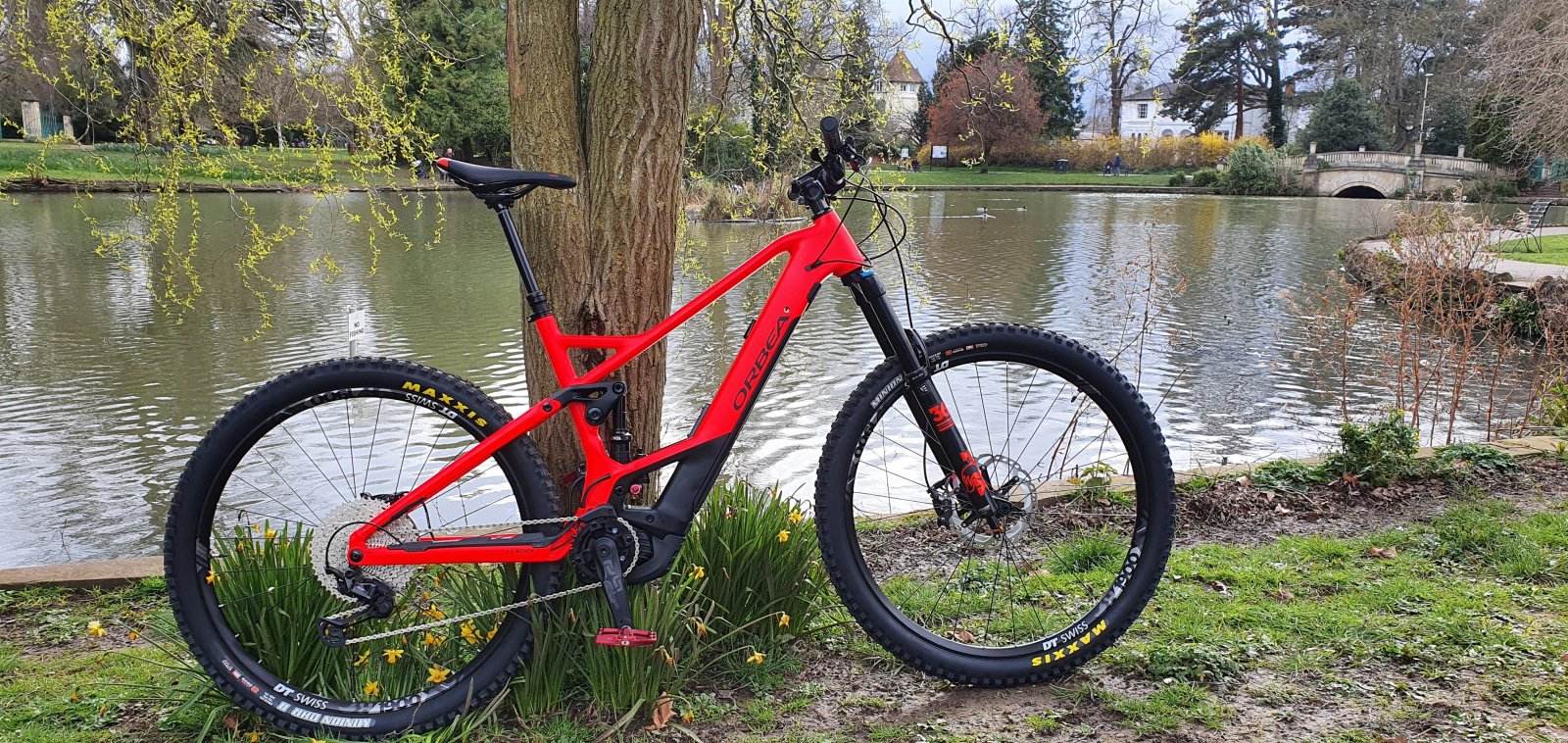

Just a quick note for any new Orbea Wild owners. After my first ride today around 30 miles on a new Wild FS H10 when I was washing the bike after I noticed that the chainring was loose and had some side to side play. I was able to tighten it up by hand and returned to my LBS where I purchased the bike. They took the crank arm off and tightened and torqued the ring to 30nm for me. He even said sorry but it wouldn't be a part that is checked on the PdI as it is all pre assembled at Orbea. Maye worth checking yours if you own one.
