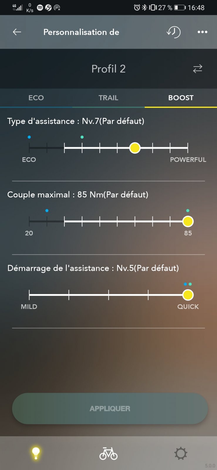

Gismo6303
Sep 4, 2021
67
13
France
My Orbea Rise was delivered brand new with a regular EP8 motor. Not a RS. I get the full 85 nm. Works great!
Hi, my rise come with an ep8 with rs sticker, but unlock to 85nm. But when I bought it it was a demo bike for test, so I don't know if someone unlock it or orbea deliver it with 85nm motor.
I've use it with 85nm, put dont notice a huge difference with setting at 60nm.
Roc
Oct 13, 2021
48
16
Belgium
This maybe simply means that it's a 60NM :)
Gismo6303
Sep 4, 2021
67
13
France
Perhaps, but I can push it to 85 in the app and stunlocker says it was 85nm and 500w max
