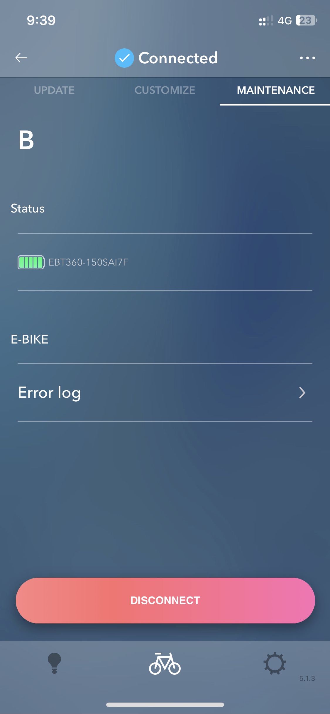

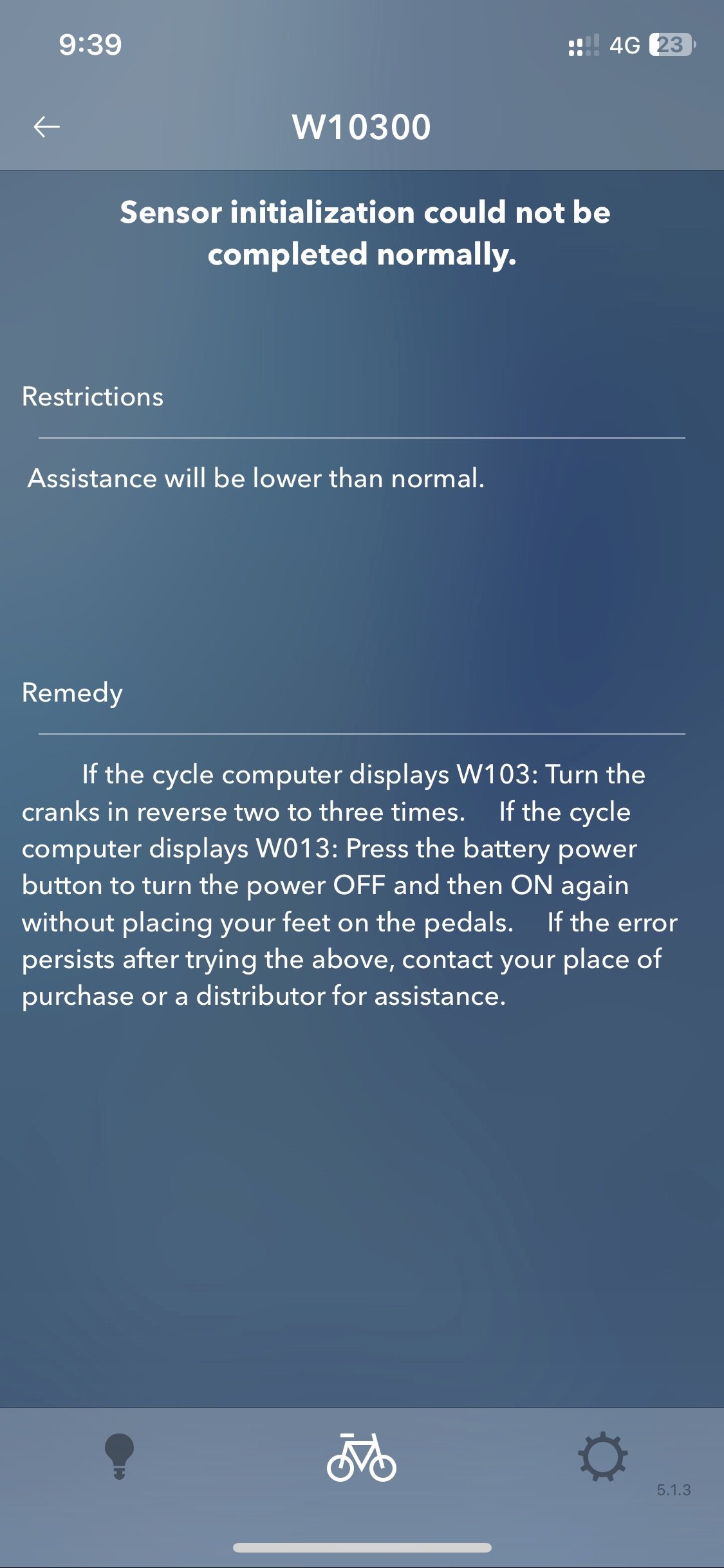

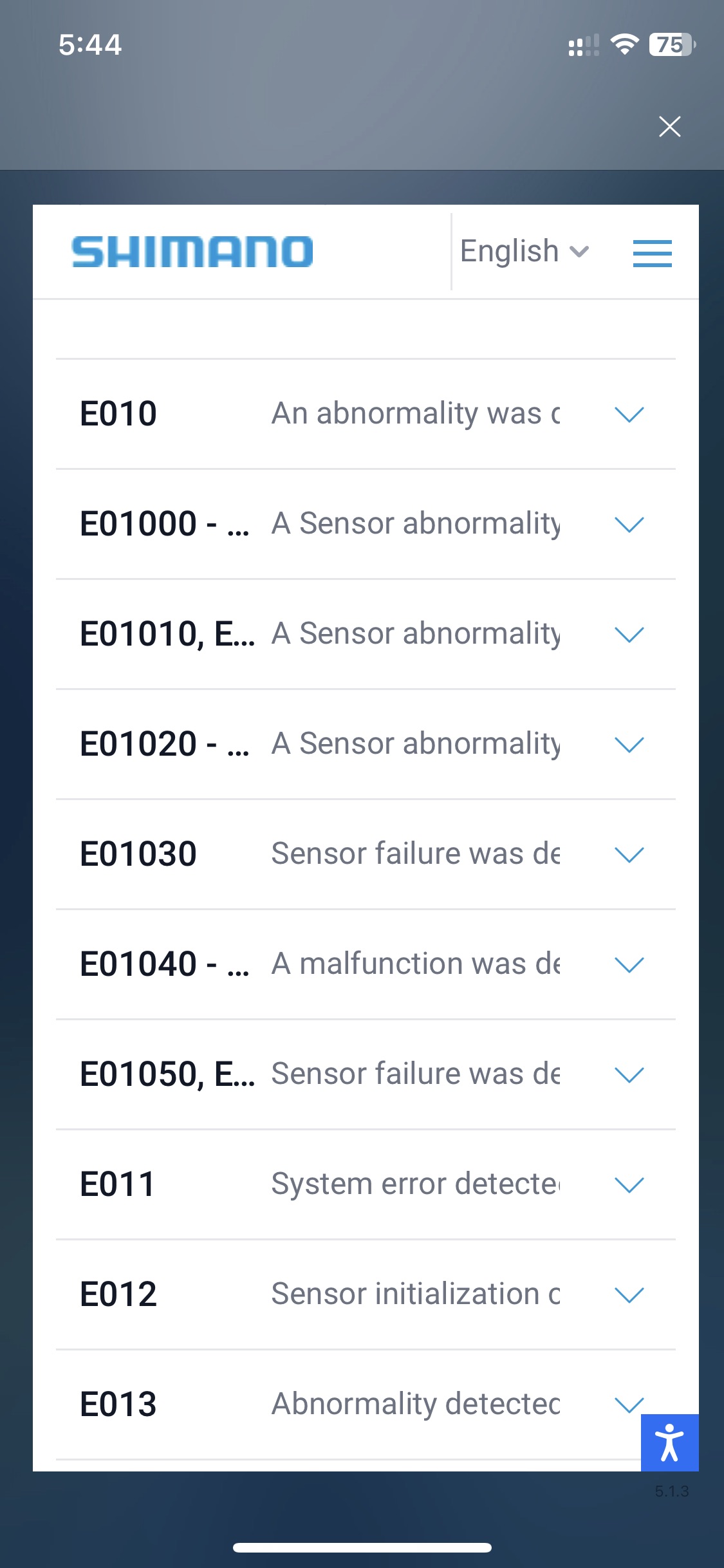

Right so on the ep8 with e tube ride ( correction e tube app, not the ride app) app, there is a maintenance tab once connected to the bike and the motor unit selected (from memory) in there you can see what code has been raised along with a description of that cause and a course of action to take. (Take it to the bike shop usually)
You’ll see that the first letter and three digits are displayed but there are following digits that complete the code. You “may” be able to diagnose something that’s not internal to the motor, eg a speed sensor, and fix the wiring yourself, but the codes are a bit ambiguous and mostly relate to the drive unit so if that’s your code you know where you stand (fcuked probably 😄)
I thought everyone knew this.
If the bike is not connected you can see the codes list by tapping the sprocket button bottom right then error / warning code (wait for it to populate )
Anyway hope that helps. But it probably won’t, if you see what I mean

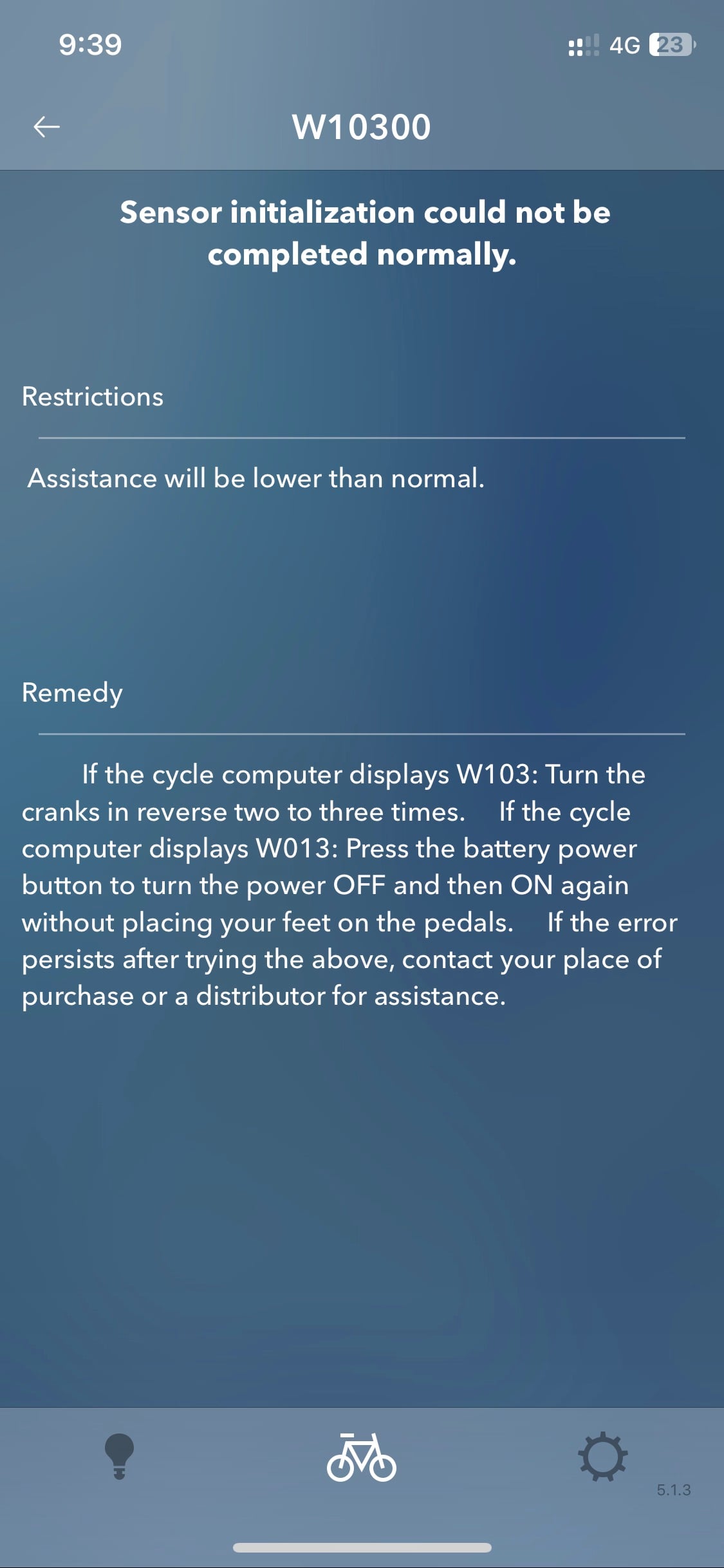

Mine raised this code and didn’t tell me. Presume it’s not a major code as it still drives ok. It was bloody cold at the time and I do get frustrated with the thing when you set off and forget to turn the poxy thing on, so then have to get off agsin to reach the power button by which time everyone has cleared off so your in a rush. Which probably caused this code by riding off before it’s ready
