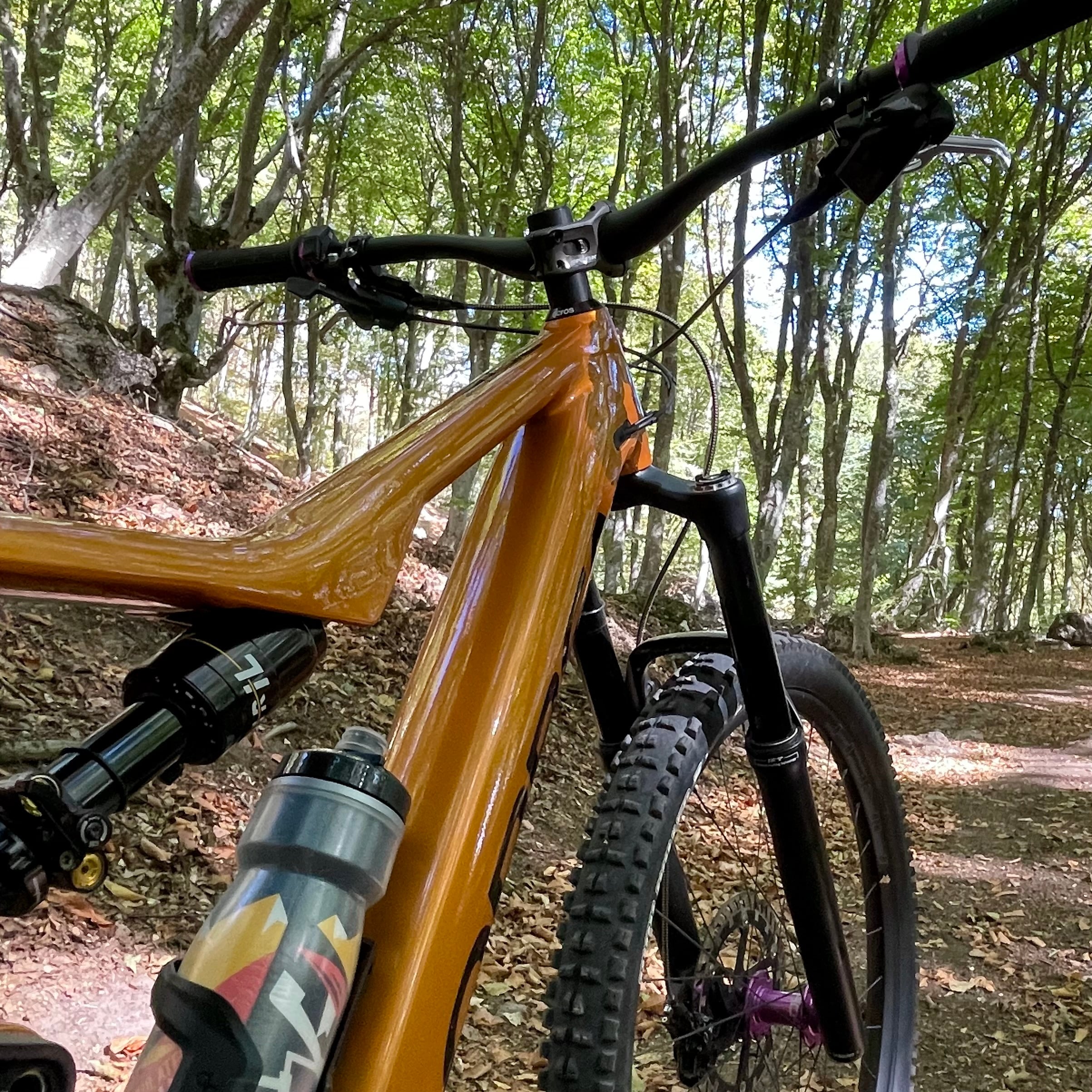

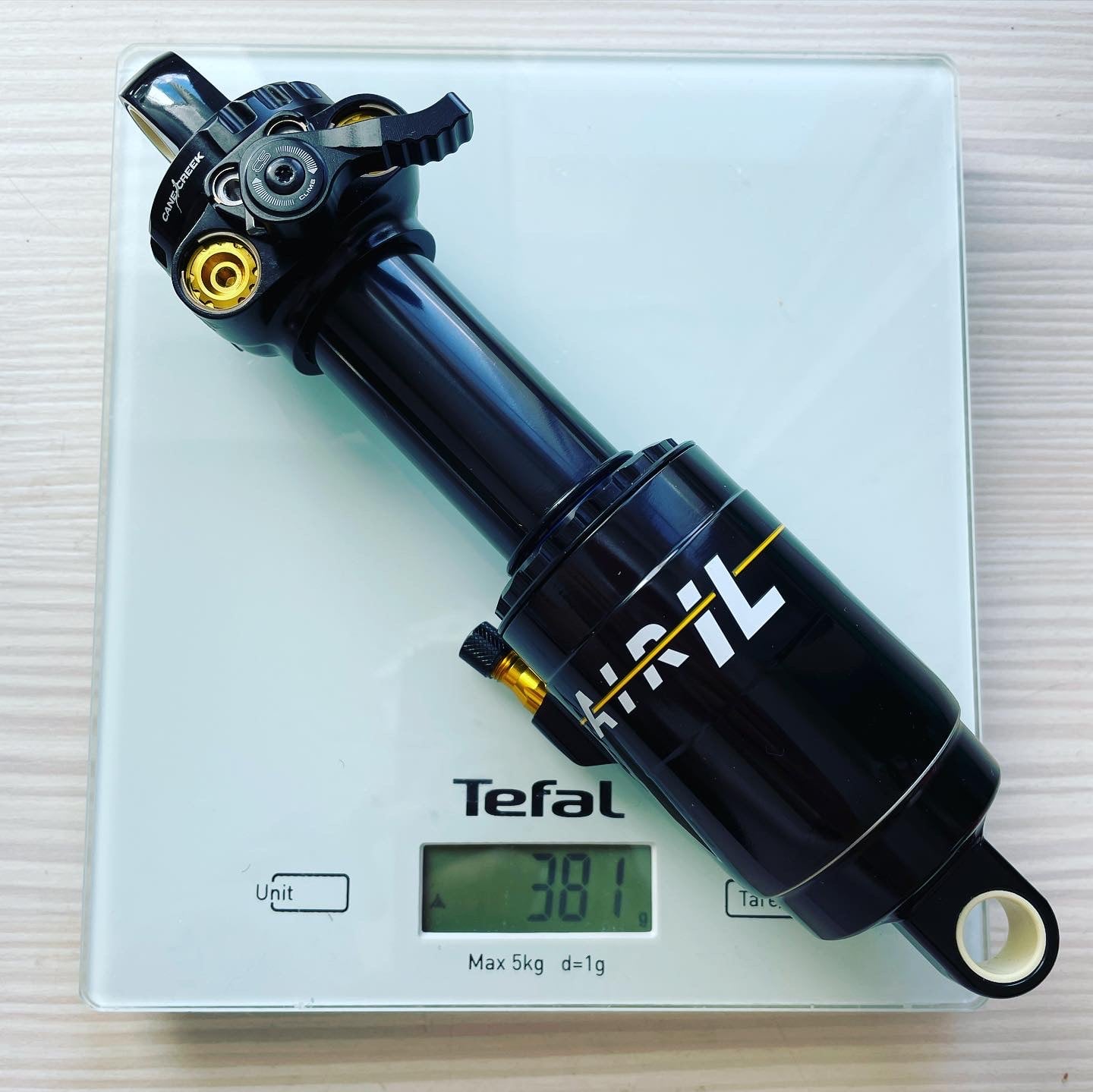

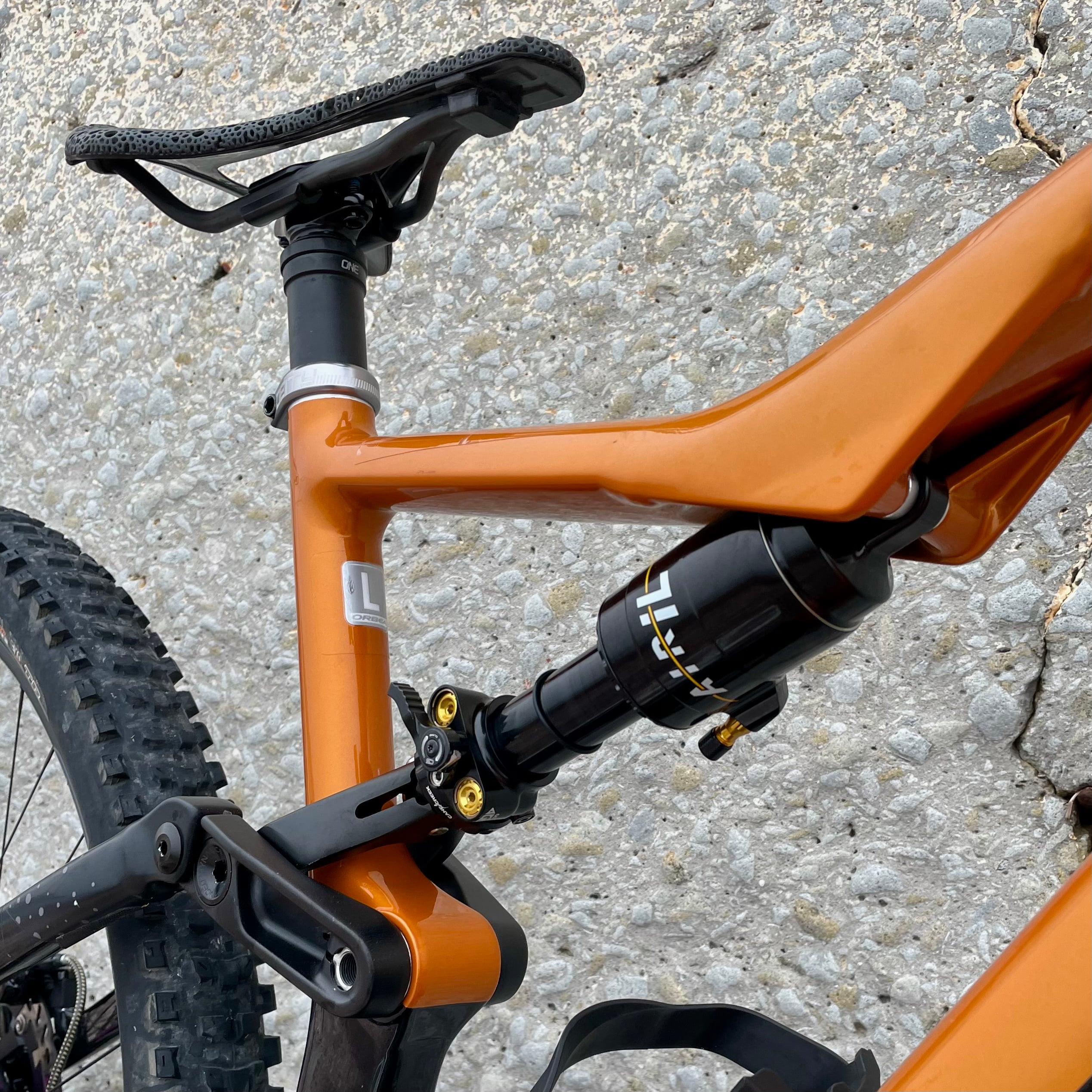

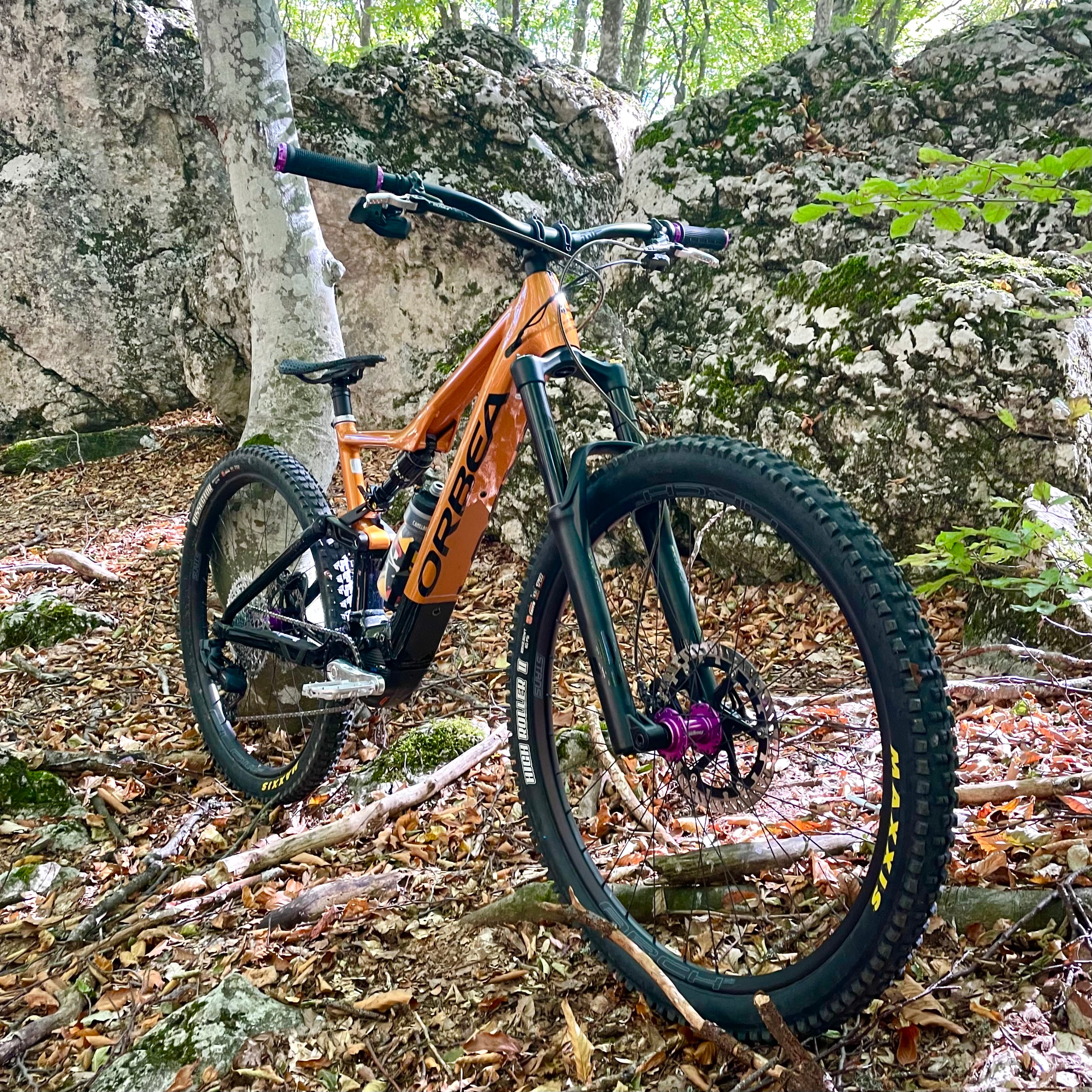

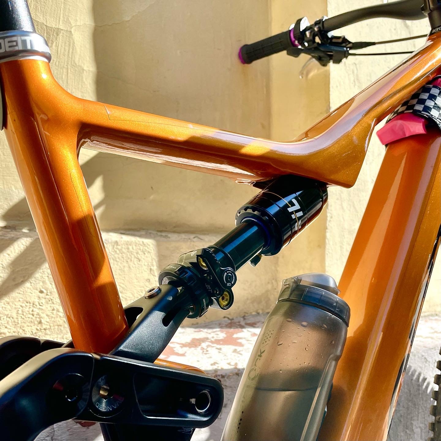

Cane Creek Air IL (next gen)! This tiny demon worked in a great balance with Formula Selva C (coil) fork, and Formula Selva is fantastic fork and best stock fork on the market IMO. Had a few rides on my friend’s Merida e160 with Kitsuma and Air IL feels not very different to Kitsuma Air.
Stock float x is not a very bad shock to be true, but it simply can’t keep up with Air IL. There’s no tokens inside Air IL and HSC is 0.5 of 2.5 turns, so Air IL manages travel very well, though it took a few days to find the perfect settings.
I’m so impressed that I’m thinking about trying CC Coil IL, but it is not recommended for clavis-design frames. Did anybody have experience with Coil IL on Rise? Is it safe to ride?
Hi,
That sounds fantastic. Is the Cane Creek Air IL (next gen) a 1:1 drop in replacement? No modifications necessary and no collisions?
Did you go for the 210x55 as the original Fox X is? And PLEASE be honest...would you recognize the difference in a blind test? Clearly? Can you formulate what is/feels better? I would not be mad to save 100g if the performance is definitely better too :p
THX a lot!

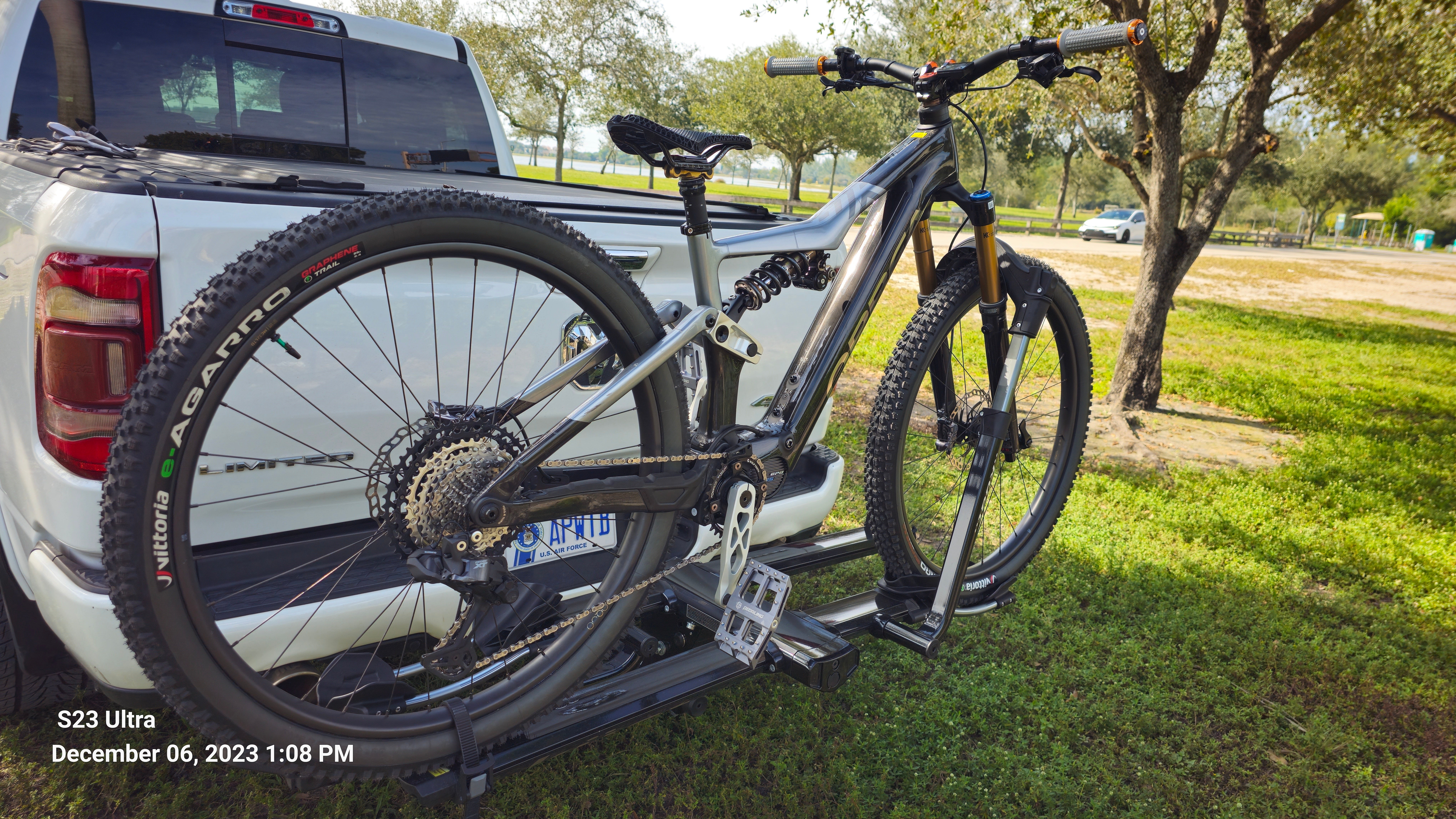

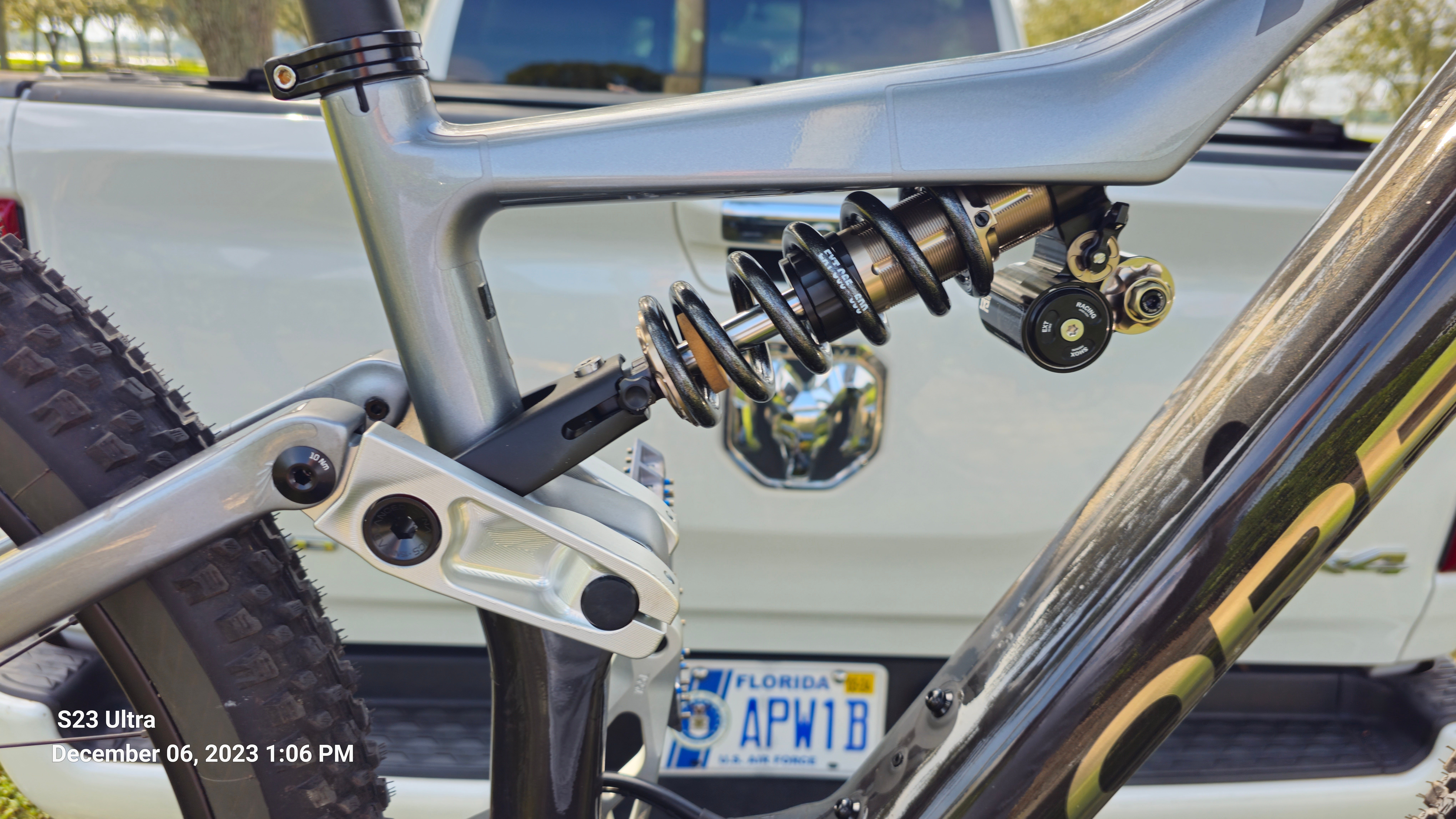

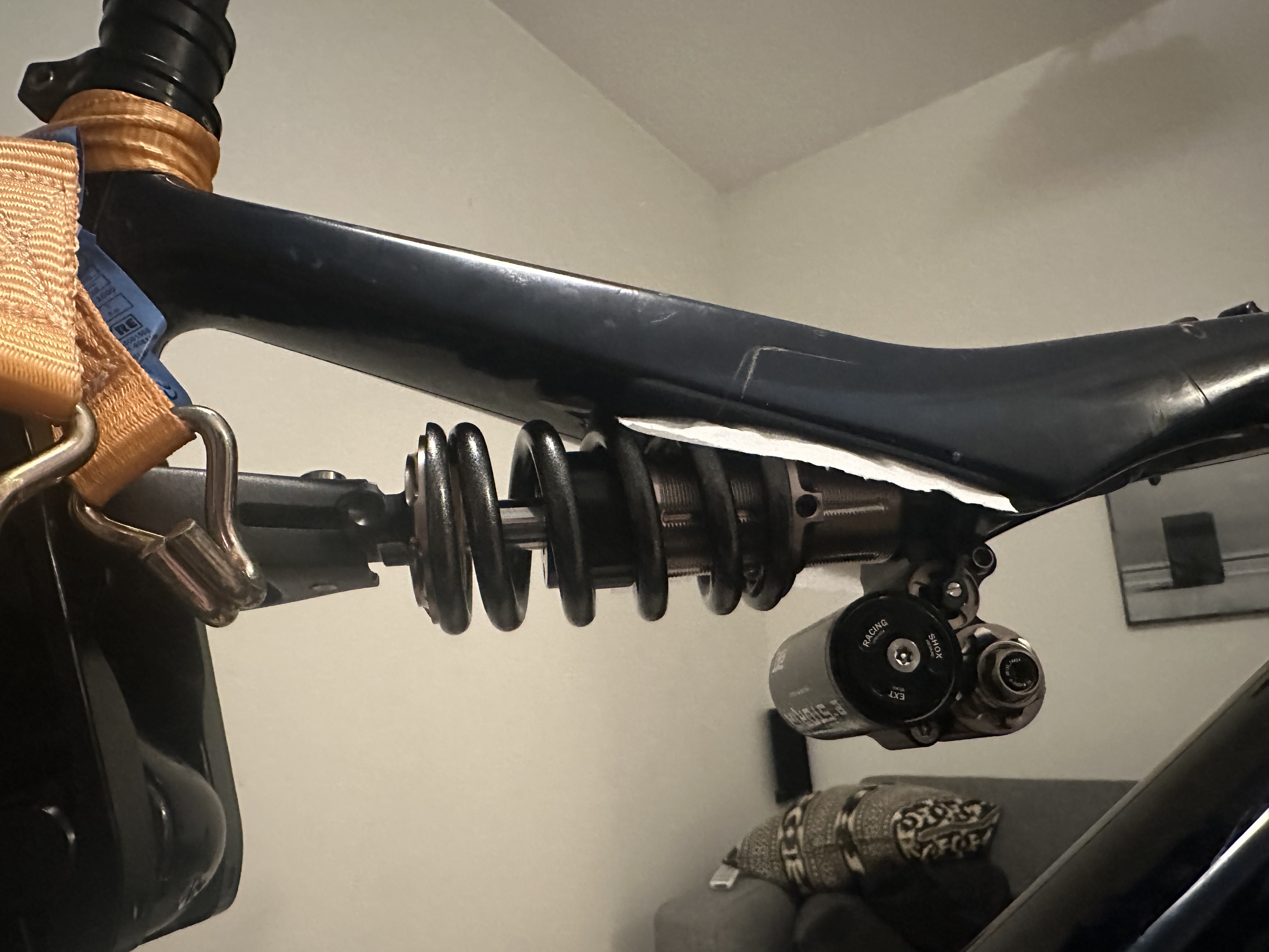

Next week I will receive an m-team 2024 and since I have an Ohlins ttx22 m.2 spring shock absorber I wanted to ask you if you know if it can be installed or maybe it can hit the frame. The size of the bike is an XL
Shjay
Apr 30, 2019
835
491
Kent
Fits on a large
Ameiza
Oct 8, 2019
94
68
Norway

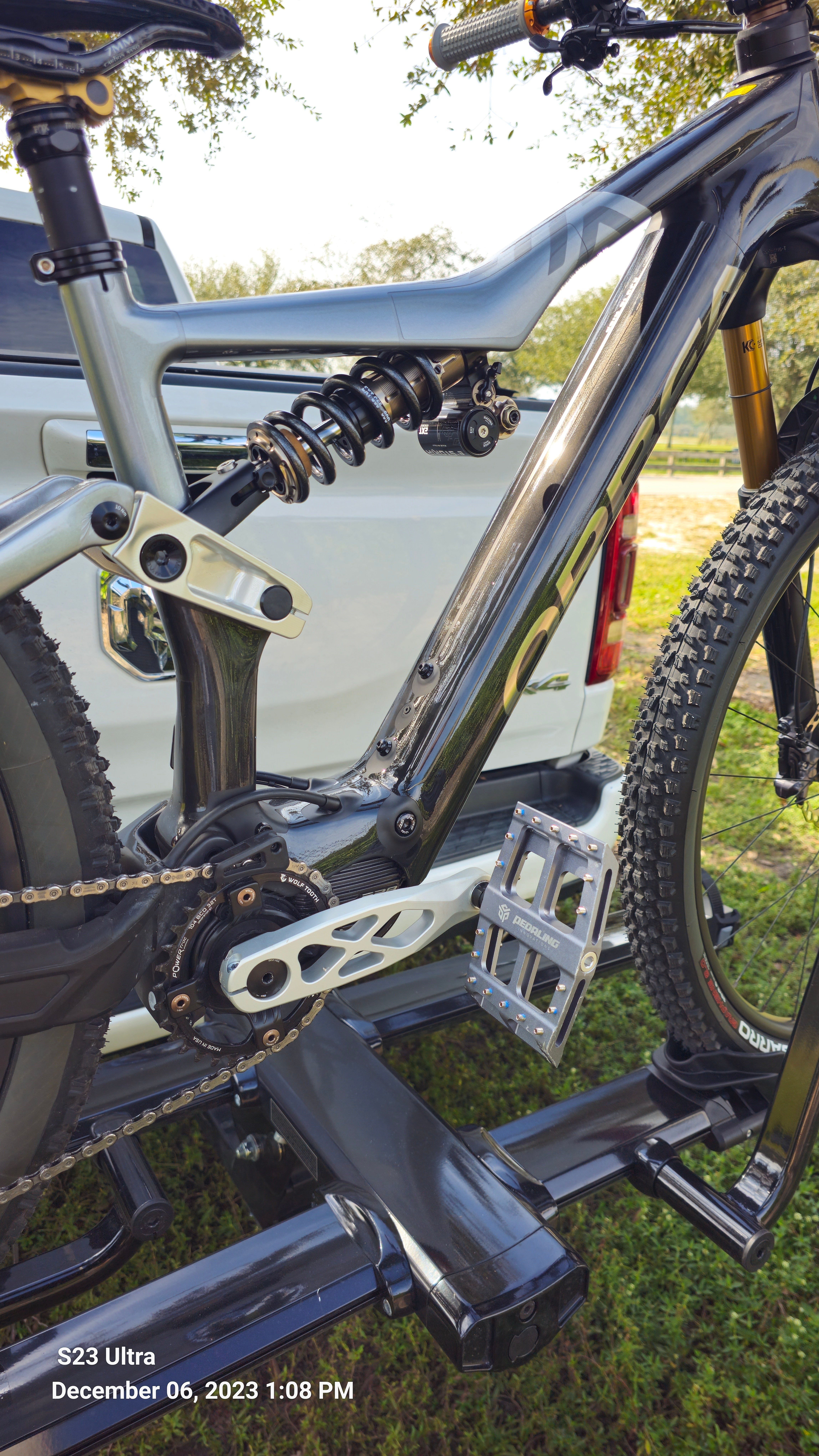

I have the 23 M-Team med. zero problems with the coil. to use the cascade link I had to down grade the shock y fork from the 21".
View attachment 131250 View attachment 131251
The rubbing is only visible under full load. I used two ratchet straps to compress the spring during testing. The white paper piece was stuck.
It may differ depending on the spring rate, since the springs are getting thicker when higher rating.
I would recommend to be careful 😊

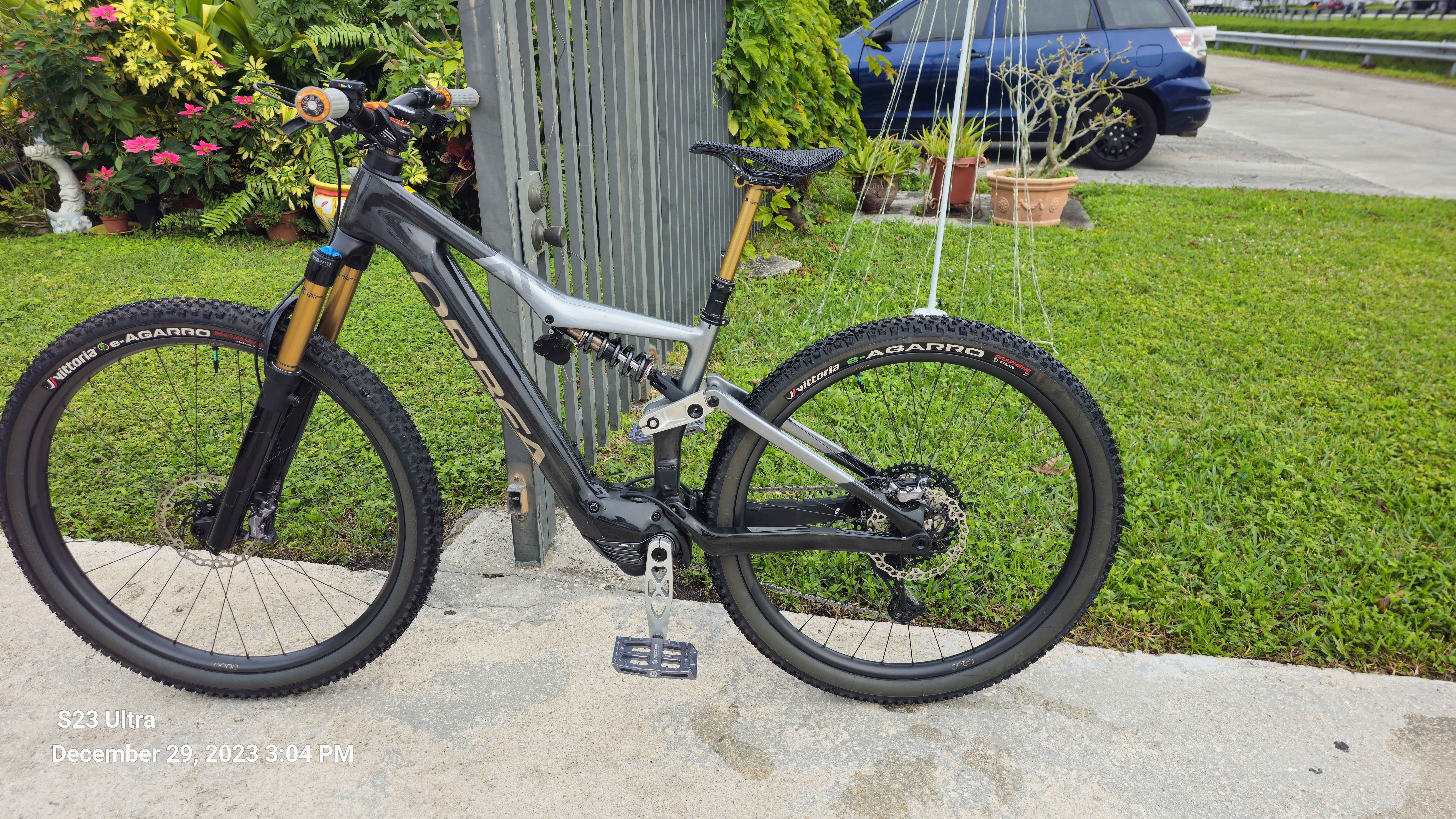

Cascade web page says that the link is compatible with only 20-22 year models:
  • Fits Orbea Rise (2020 to 2022)
I have M20 2023 and wanted to use their link, could you please share you experience of installing the link?
the only set back was removing the bearing to install the shaft with the bushing, than reinstalling the bearing and getting the correct gap. I had to down grade the shaft and the y fork that attaches to the shock. the 23 rise used a shorter Y fork and the shaft is a one piece with the link. I have doubled my traction from the stock setup.
xaw
Dec 26, 2023
TX
Thanks for sharing the information. By any chance do you have some photos of installation process or the guide you might be using? I'd definitely like to get Cascade Link on my Rise.
I’m so impressed that I’m thinking about trying CC Coil IL, but it is not recommended for clavis-design frames. Did anybody have experience with Coil IL on Rise? Is it safe to ride? View attachment 129343
View attachment 129340 View attachment 129341 View attachment 129342 View attachment 129344
what hardware did you have to buy to install it? I've always had problems with my DPX2 and saw that the canecreek is on sale right now.
