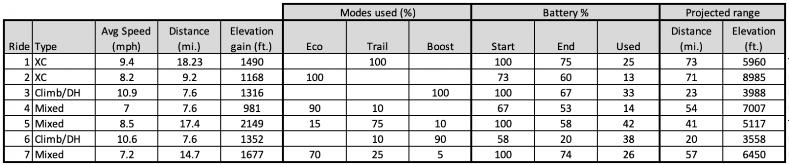

There are many variables of course, but I too have been impressed with the range on the main battery. Orbea claims (roughly, converted to feet) range in elevation as 8200 (Eco), 5600 (Trail), and 3900 (Boost). My experience falls right in line with those claims. Here are some numbers from a handful of recent rides. Size M, about 175lbs kitted up, using Profile 2 with the stock settings. I calculated (extrapolated) the 'projected' figures using the % battery charge consumed on each ride. I've not seen the need to consider the range extender myself.

I don’t see 8600 in eco happening, I forget exactly what eco is in profile 2, but similar to my 2/10 eco setting I used the other day to get 6000. Granted I did use some 4/10 power, but still I’d say 7000 would have been my max in that mode, and that’s pushing the pedals pretty hard. Ya never know until you put it on a certain mode and do a big ride, then you’ll figure out how it will all work out for yourself and what to expect, and that’s really all that matters!
Ducman71
Apr 8, 2021
97
67
Orange County, CA
I double checked and I actually have Eco in profile 2 one step up from the factory setting for max torque, so in other words, max torque is on the 3rd step (one higher than yours), and I'm still getting the range/consumption I show above. Each person's results are of course not directly comparable because there are significant variables that affect range other than the mode used, including things like efficiency and power of the rider (torque applied, cadence, etc.), the rolling resistance of the terrain (hard versus soft dirt, dry versus wet, etc.) and so on. Regardless, I can confidently say that for my riding in my conditions, from what I have seen, the range figures that Orbea states seem entirely reasonable. What I can also fairly confidently say is that if I set off with a full battery and went for a continuous ride with 8200' of vertical solely in Eco to prove this out, my legs would run out of energy before the battery does.

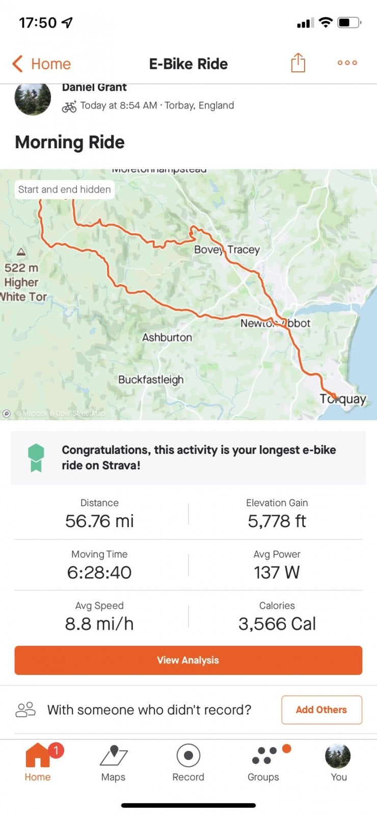

80kg kitted up, med rise with coil
Shock and enduro wheels with inserts. 57miles yesterday, 15 upto dartmoor used 1% then 28miles around and left for home with 35% showing. Was shattered going home and used mainly trail with a bit of boost for the hills. Battery went into safe mode (eco) about 20 metres from my front door.
Forgot to add that was with the extender.

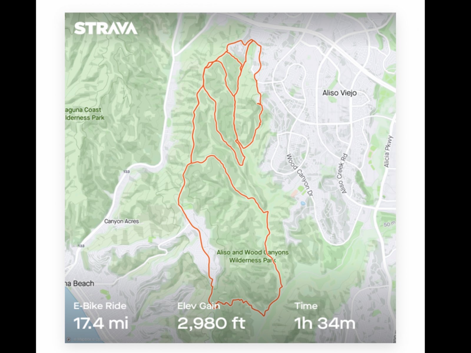

43.5 miles, 5,500' of climbing, assist 4, torque 37nm, rider + water = 160lbs, 17% battery remaining (in-frame battery and range extender)
For these two posted rides, you stayed in the same mode for your entire ride? For instance you stayed in Trail?

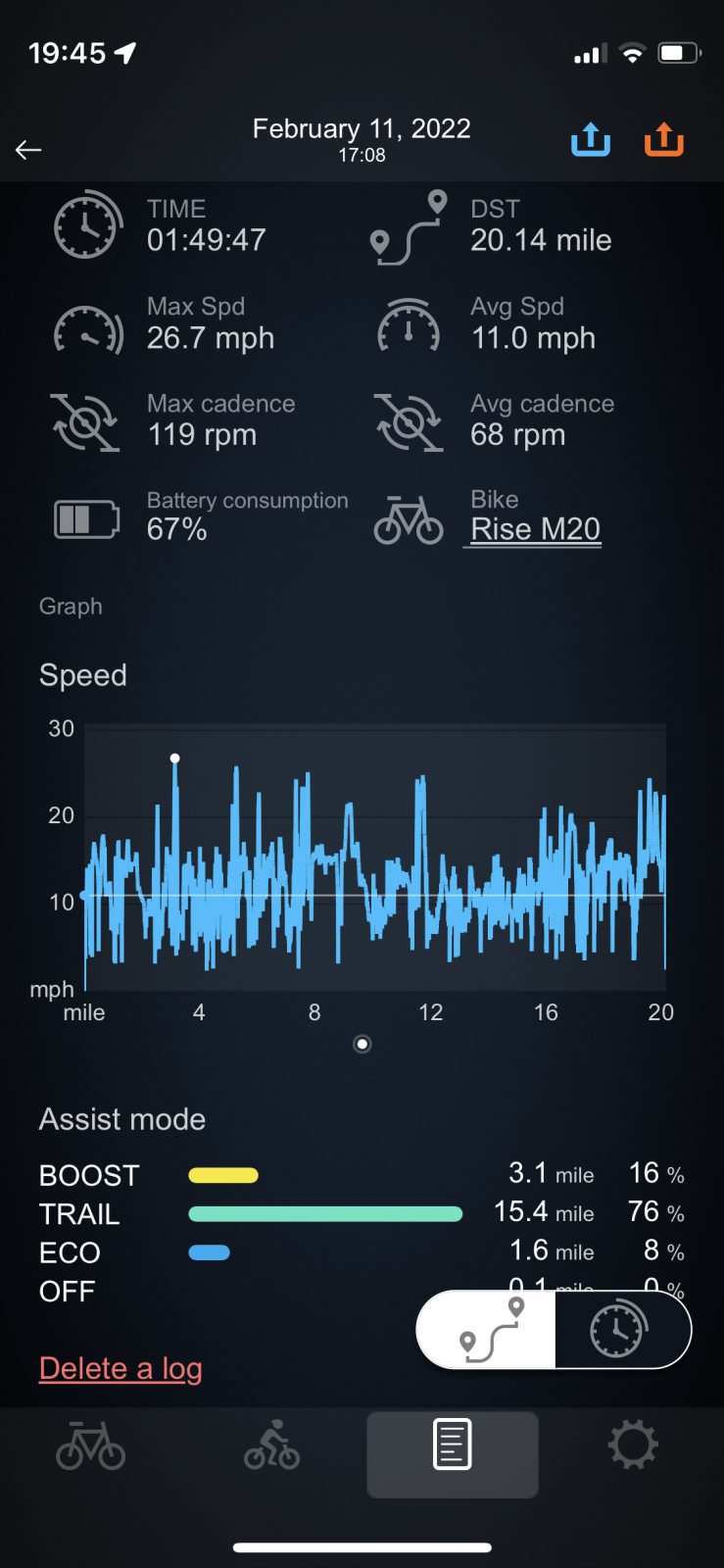

Hi All - I'm probably just under 80kg kitted out in winter gear, had my M20 for a week now and clocked this detail below, elevation was 2250ft from Strava - plenty of single track and fire roads mixed in and one long super steep hill which I cleared in boost (could never make it to the top on my acoustic bike even when I was younger over 20 years back:) I reckon there is another 10 miles ish in the battery which is plenty for my riding profile of 1.5 to 2 hrs typical. Using Profile 2 btw trail and boost are default and i've just upped the eco by one notch but its needs a little more to make it worth while. Using boost on those hills you just wouldn't attempt on the acoustic really opens up the terrain. I'm pretty impressed with the std suspension and with a few more tweaks to the pressures and settings it's more than capable in my book, looking forward to the trails hardening up a bit, its heavy conditions on the trails at the moment so its defo good for 30 ish miles in trail mode that's plenty of range for me and its doddle to pedal with no assistance if that's your thing - Happy days (y) Scroll down for the mode percentage detail.

Hia Sal,
Not sure you can get the heart rate through the Shimano E-TUBE RIDE app, I run my heart rate through Apple Watch to Strava as I’m not using Garmin, which seams to work well from all accounts. Mileage, battery life, distance, avg speed and vert is more than enough for me. Loving the bike too. It’s a Great choice. 👍
