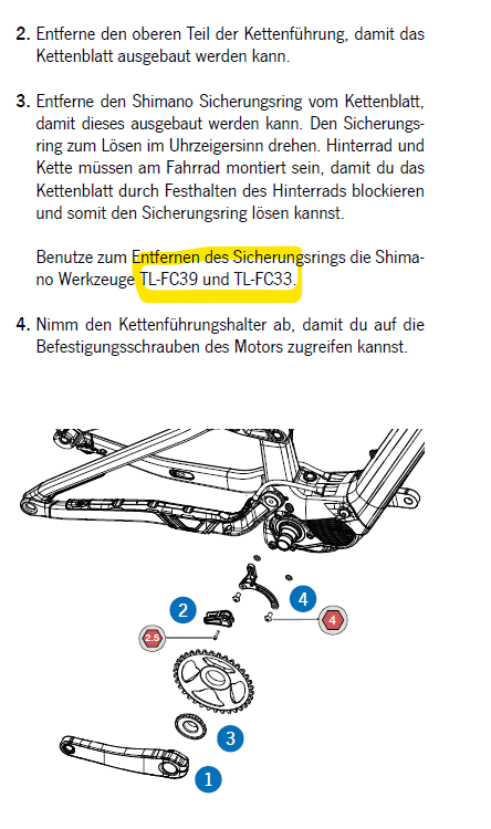

i have a m20 2023 model...
i tried to remove the chainring to fix my dropper post and saw i need special tools from shimano...
after looking at the bluepaper it says i need the tools TL-FC33 and TL-FC39...so i ordered both..
today both came in and i tried to remove it again...
but unfortunaly both dont fit???? one would fit but the axle dont come through..
and the big one where the axle would fit through is too big, theres no grip...
after googeling for a while i found a manual for the cranks..
inside the cranks it says i need TL-FC430? it looks right but i want to make sure...
also do i still need the TL-FC33 to turn the TL-FC430??
im not sure wich one i need i dont want to order a ton more since the original shimano tools are not cheap...
also im in a hurry since i have a big ride coming up next week...
can anybody help me and tell me wich one i actually need???
