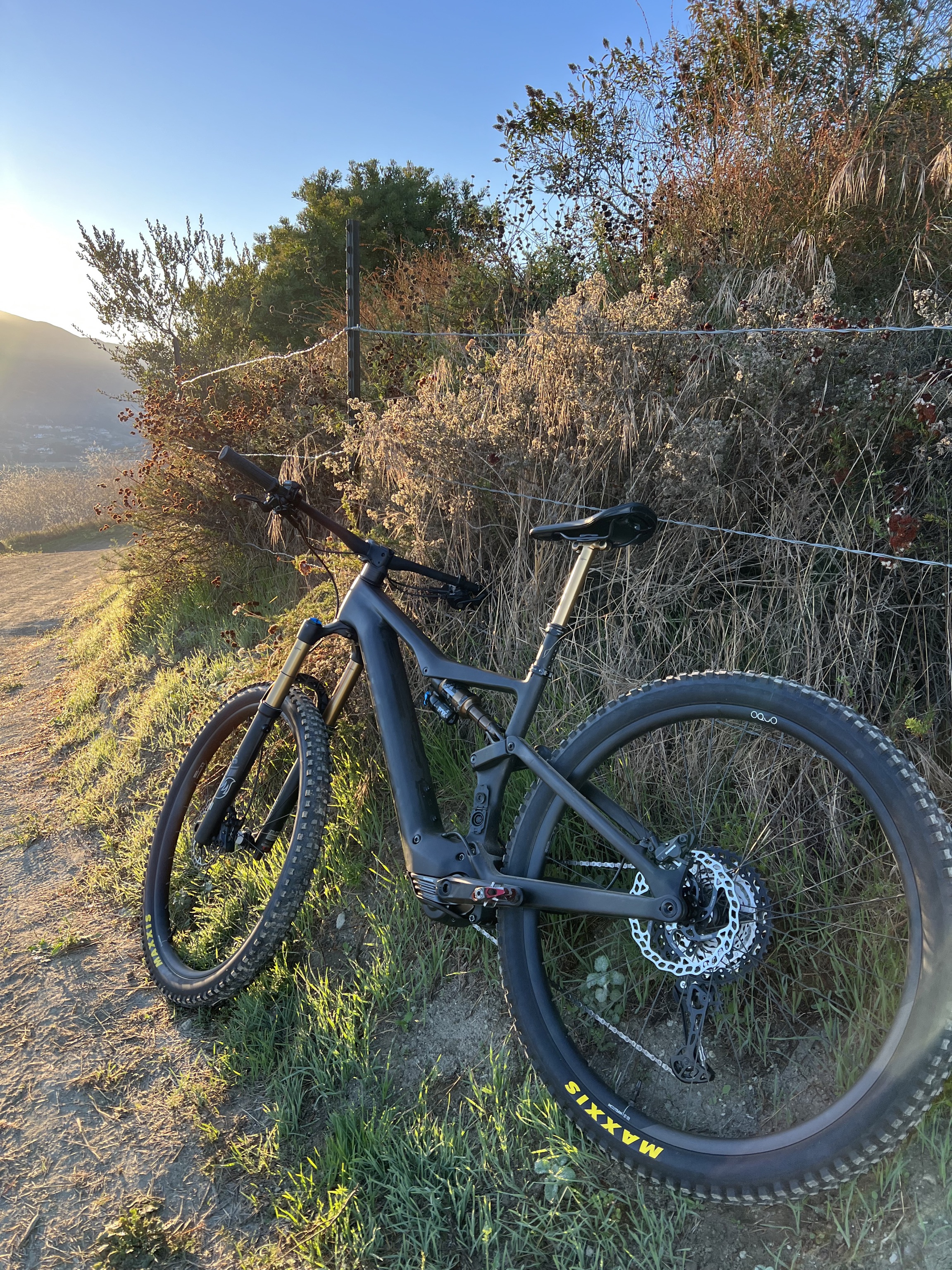

Hello all, just picked up my first e-mtb after 30 years of riding acoustic. This was a custom order 2023 M-10, that the purchaser decided he didn't want. I have a question for the bright minds here: how do I know what size battery is in the bike? The shop "thinks" it is 540wh, but the range it's giving me seems to be the 360wh. Is there someplace in the app that would say the watt hours of the battery? I did a shortish 15.6 mile ride with about 2k feet of climbing in an hour and ten minutes and used 70% of battery in 90% trail mode and I weigh 170. Just thought I'd have a greater range with the larger battery. Super fun bike, still dialing in the suspension. It's like a whole new sport. And yes, I know my battery door is open...

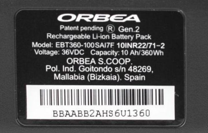

This is really helpful. So I went to that tab and it shows a code of EBT360-100SAI7F. The 360 has me thinking that's the size. I will report back as I find out more.

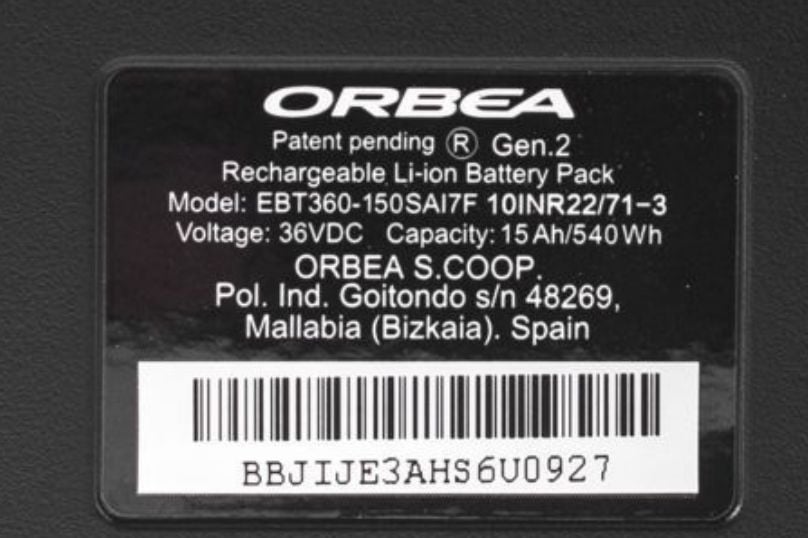

The EBT360 does not refer to the battery capacity, it's the following numbers that indicates what battery is installed:

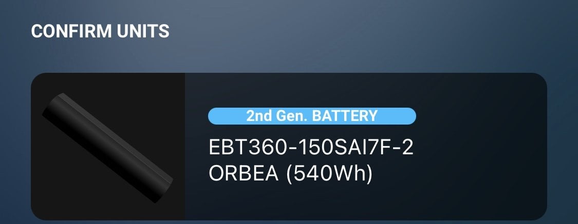

View attachment 140667 View attachment 140668
correct. 100SAI - 360W. 150SAI - 540W

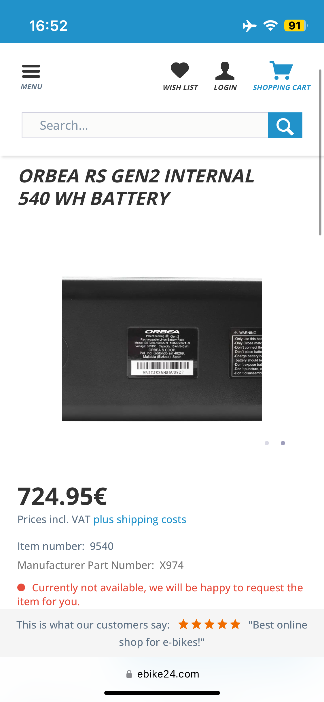

I may panic for no reason, I just found a store that sells Orbea batteries (all gen's) .
Check ebike24 (.com)
