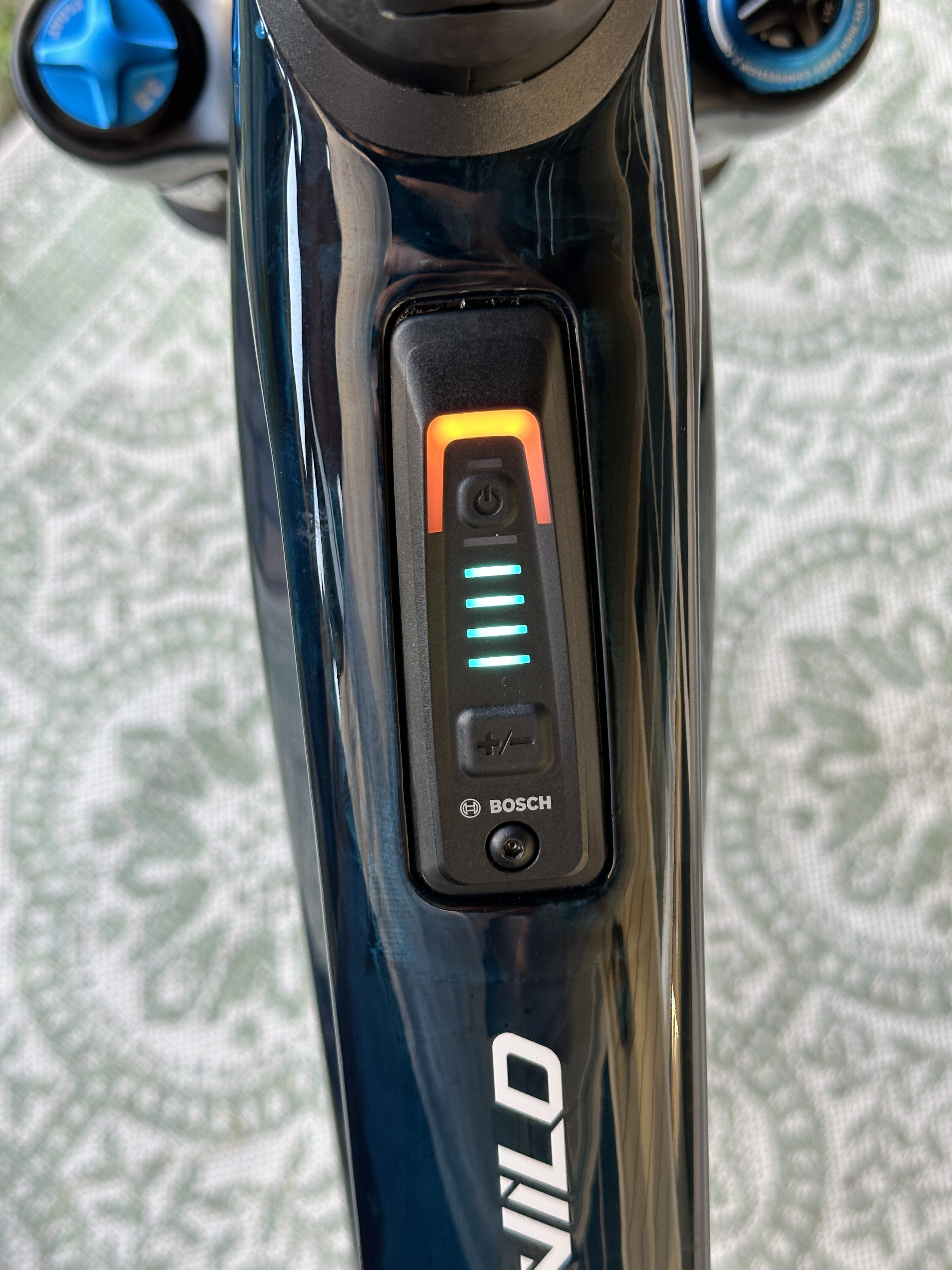

Does anyone know what an orange assistance level indicator light means? The documentation states an error is displayed if ALL BATTERY level indicators are orange, but this isnt the battery level indicator, its the assistance level indicator light. If I open the Flow App, no error is displayed and the bike continues to function as normal. In fact, if I use the mini-remote to change modes, the light remains orange, but if I look at the Flow App, I can see it cycling thru the modes. The light is solid and does not flash. I have tested without my phone and it didnt happen - read that some people had it when their phone was out of range. Maybe it doesnt do it every time? IN addition, its happened, i ride within range of my bike, connect the app and it remains orange, no error. I have opened a ticket with Bosch but havent heard back yet. I LOVE when they dont document everything in manuals...

Orange is a fault code indicator. Open the flow app and it will tell you what the fault is.

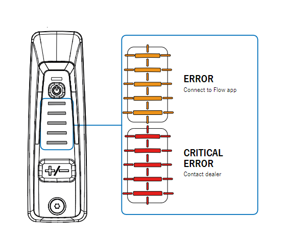

Like I stated, there is no error displayed in the app. In addition, the manual states a non-critical error is when all battery indicator lights light up or flash - this is the assistance level light, not the same thing. Doing some searching on here it seems more likely it something to do with the phone connection, its just apparently not consistent.

With the LED Remote Orange on the mode indicator is an advisory/warning not a fault.......for example, it goes orange when you reach 30% battery left, and it goes orange if your phone loses cell contact. Flashing Orange is a fault. With a Kiox 300 display it would tell you what it is warning you about or what the fault is. You simply press the square button to cancel the warning. So I dont know if the original or subsequent firmware updates for the top tube mounted system controller is now programmed to do the same.
I have the LED Remote and have seen both warnings............30% battery, and on one ride I was repeatedly warned my phone had lost cell contact ( I was near an Army base/firing range!!)

My bike does the same. Always at the start of a ride. The manual etc all talk about the battery level indicator being orange or the assistance level LED flashing orange. None seem to discuss a solid orange assistance level LED, which is what this is. It doesn't flash and it doesn't produce errors in the app.

Sorry for my lack of clarity. I was in a hurry this morning and got sloppy. This time of year, I need to leave the house late enough to avoid commuter traffic, and early enough so that I'm finished riding before it's blazing hot. Even so, I still hit some traffic, and it was pretty warm on the ride. Whatever... at least I got to ride.
My specific problem was that I connected the phone to the bike, then rode off without the phone. In 50 yards or so, the bike realizes that the phone is missing, and goes into the warning mode. It still runs, but the lights are goofy.
The solution is to NOT connect the phone, or connect the phone and keep it with you so it doesn't go out of range.
After some experimentation, I REALLY like this arrangement. The Bosch Flow ride tracker is much more reliable than Strava, and it still uploads to Strava. So I keep the app connected while I'm riding. If for some reason I left my phone behind on a ride, the goofy light error would alert me to the problem right away.

Well what o can tell you is that mine will turns orange when
A) the bike is connected to the flow app on the phone then looses that connection, whilst still on.
B) the motor has thrown up a fault code of some description.
I've had it happen a bunch of times.

This is an error indicator, power indicators are green, blue, purple and red. The Bosch race motor throws this orange error code a couple times a week. It does not "seems" to effect the power output? Shutting power off and turning power on clears the color.....so far! Not sure what accounts for the error, anybody know?

I contacted Bosch who said this:
“The orange indicator on your system controller suggests a non-critical error. Does it initially flash and then remain solid? It is unusual that the Flow app is not displaying an error. Pressing the small square button on the mini remote should clear it; have you tried this, and does the error return on start up?
If it persists, you will need to consult your local Bosch eBike specialists. They can run a diagnostic scan to provide further insights into this error and help resolve it.”
I haven’t seen it flash it initially and my mini remote broke. I do think it’s most likely just the connection with the app and nothing to worry about.
