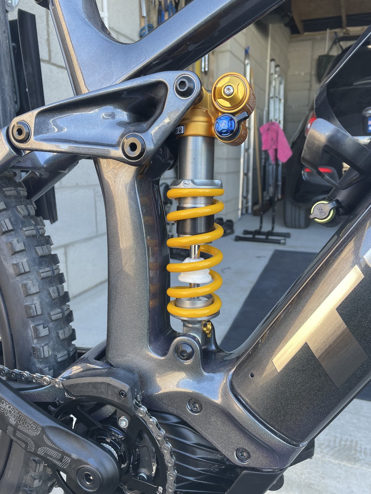

Is the TTX22M.2 more trail focused or just a slightly revised version of the 22M? The product description makes it sound as though it is.
wondering which to get?
from what I’ve seen so far, most are running with Fox DHX2 or the TTX22M

I think it’s just a revised shock same with revised M2 forks, I have the older version on my Rise awesome shock would always take Ohlins over Fox

The best thing about the Ohlins is that even though there are fewer adjustments compared to some oher shocks, they all work.
Seems almost impossible to set it up badly.

Ohlins spring calculator is 570lbs for my 90kg weight. That’s 70lbs over the tftuned spring calculator.

I’m about 90kg and run the 548 spring which is perfect. Bought the shock and spring from tftuned and their recommendation was the 548.

When using TF tuned calculator add weight of motor & battery onto your weight for spring choice that’s what I did for my Rise & spring is good choice by their calculator

Yeah that makes sense with my 548 spring, me at 90kgish plus gear.
I just rang them and let them choose the spring, they are always super helpful.

the 22M.2 is my current choice because of its easy stroke adjustment.

I’d be tempted to buy the 22m.2 anyway if I was you, would be nice to easily experiment with the different stroke lengths.

Yeah, 750w is still trunnion.
What bolt sizes are needed? I’ll be ordering the shock and mounting kit from tftuned, not sure if they also provide the bolts?
