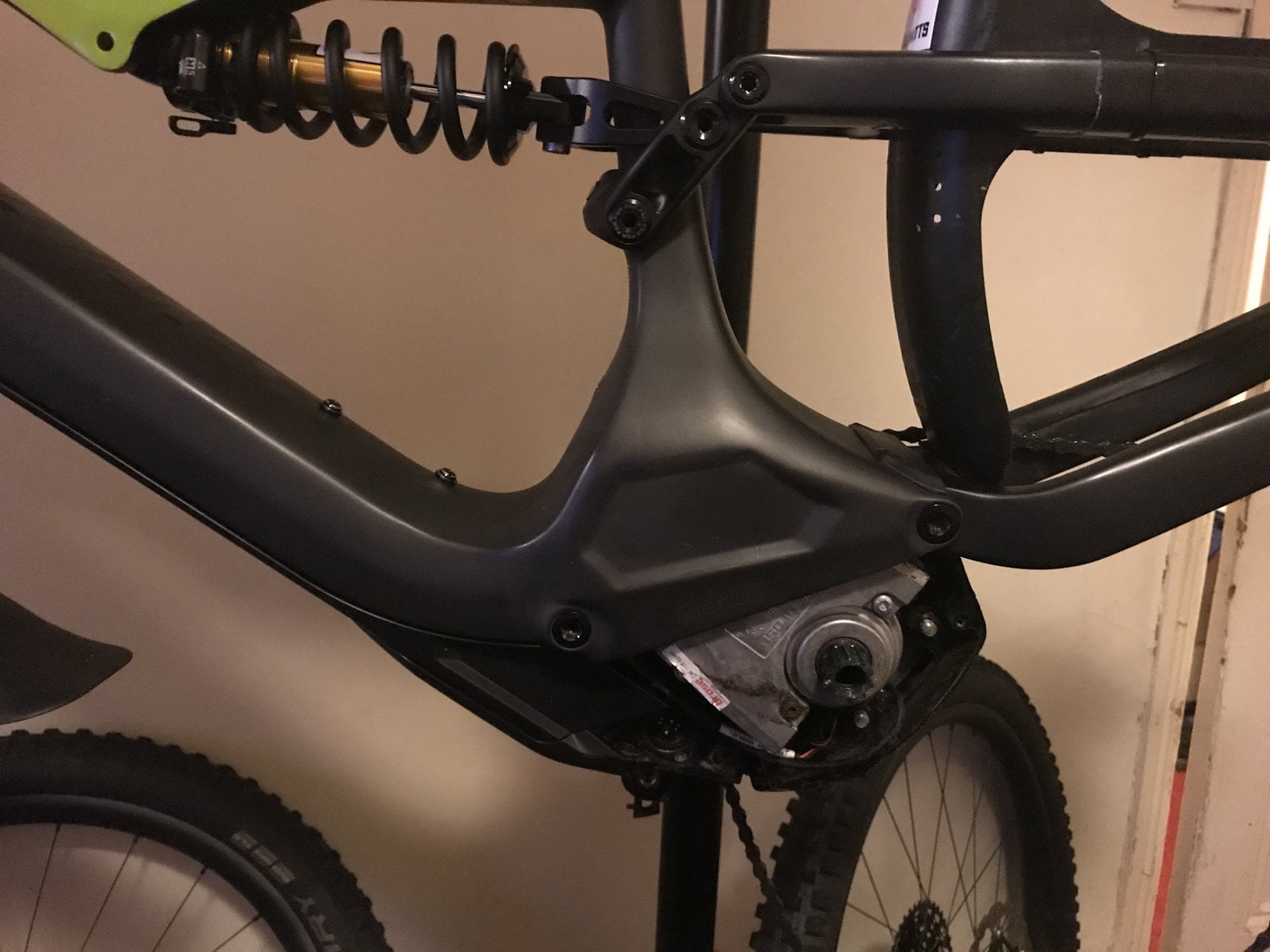

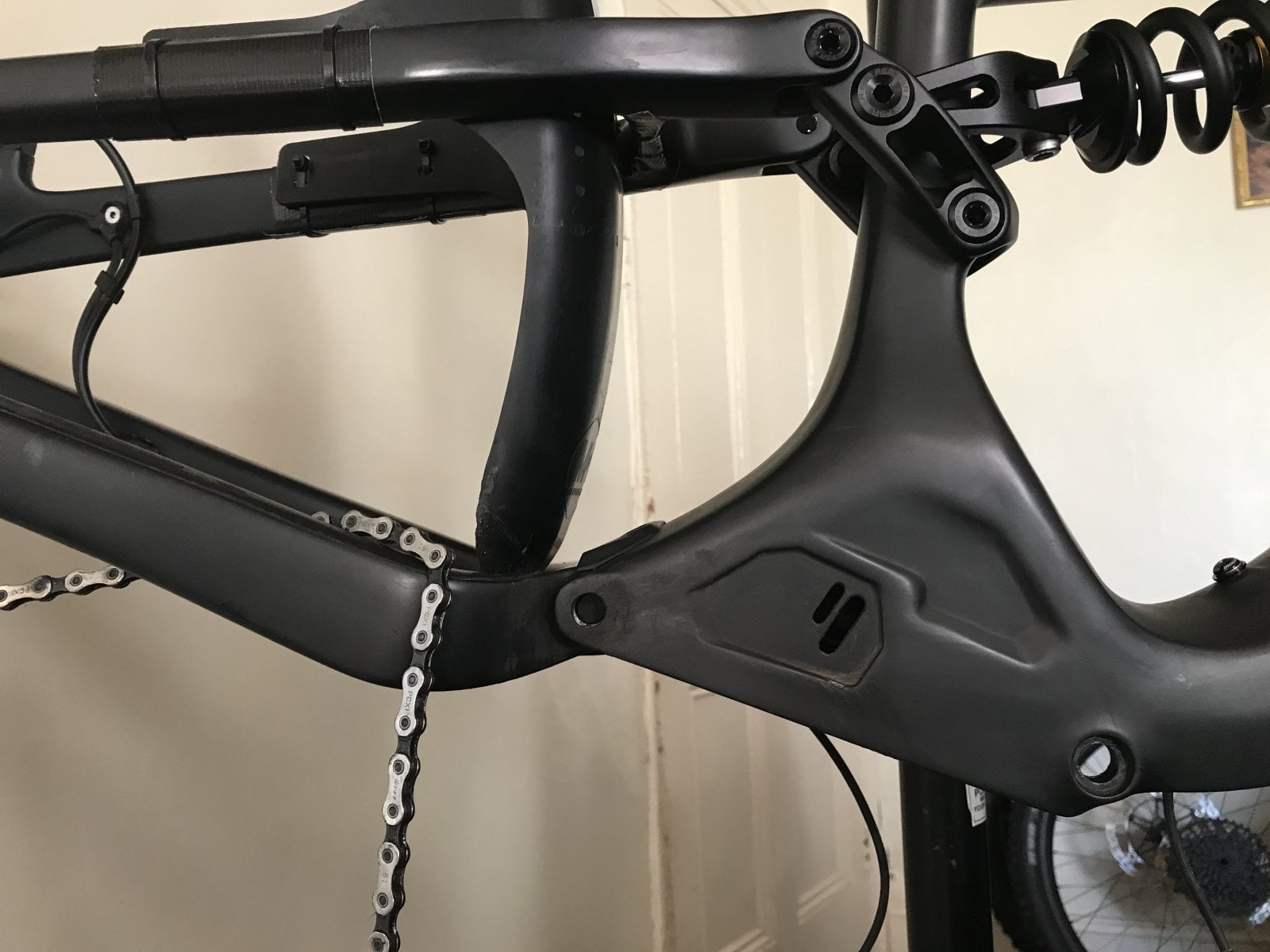

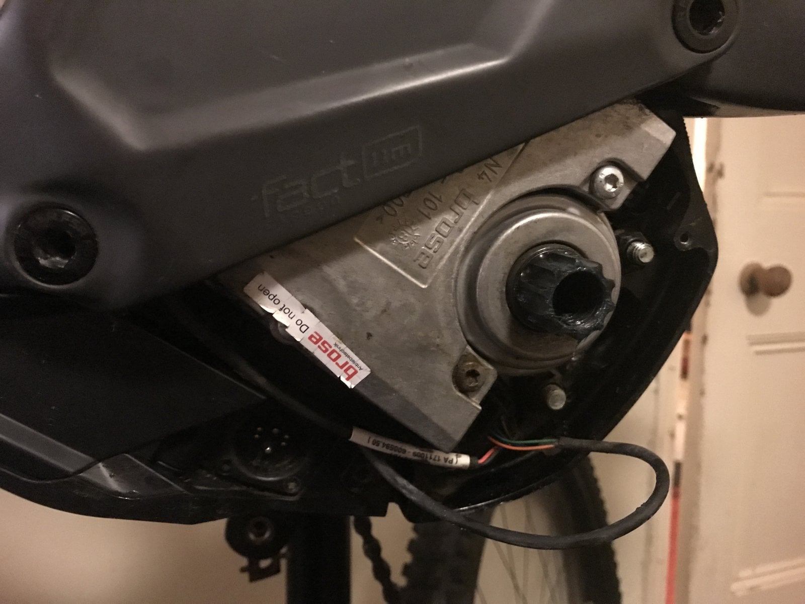

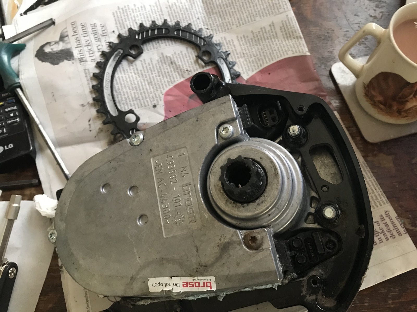

Well, as we say up here..... I’m in up to the makers name now! No turning back.
ive been really lucky to source a replacement motor under warranty. Quite a relief with weeks of inactivity stretching in front of us. Couple of progress pics below. Surprisingly easy with a little help from @Kiwi in Wales and you tube.
