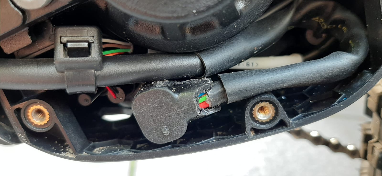

I had this problem to. This photo is when the bike was 3 weeks old.
Went back to the store and it worked fine.... grrr.
About 1 week later again no power, this problem came up after cleaning.
So i removed the cover and used my aircompressor. And the bike worked fine.
Afther reading this forum i discovered that more bikes had this problem and asked my dealer to replace the powercable.
With the new cable it is solved. 700 km since the new cable is installed with no issues.

All of this has been covered before if you search the forum but since there is now a fresh batch of people with the issue, the a bove picture is the older style power cable. If you have that cable you are likely to get problems sooner or later. The issue is that the "loop" in the cable puts too much pressure on the "D" cap connector going into the motor because it is is too stiff. It vibrates when the bike is moving over rough ground and eventually cracks open that "D " cap. Usually the wires inside the outer casing going into the cap are undamaged but the only seal preventing water ingress into the connectors within the cap is between the very edge of the cap and the black outer sheath of the cable. As you can see from the picture, any crack in the " D " cap therefore allows water ingress and that creates a short across the pos and neg wires. The replacement cable has the outer sheath removed for a little more than 50% of its length so its can flex without straining the cap. It is also routed differently ( details on the other thread if you look it up). As I have said before the cable is easy to repair as a temporary fix or modify as a permanent fix. Certainly if you merely effect a repair to keep you riding whilst you apply for a replacement no one in Spesh is going to accuse you of meddling. If your cable is in this state and you wash the bike water will run down the cable from the battery connection and cause the short or go through between the cover and the motor. The cavity between the motor and the cover in this pic is clean. I have seen other full of debris from the trail because the cavity at the rear of the motor has not been protected. That debris gets wet and again the wires within the broken D cap get shorted out.
Mikerb
May 16, 2019
6,567
5,058
Weymouth
I forgot to add, the new cable was available from about January 2020 so if you bike was built prior to that it is likely to have the old cable.
