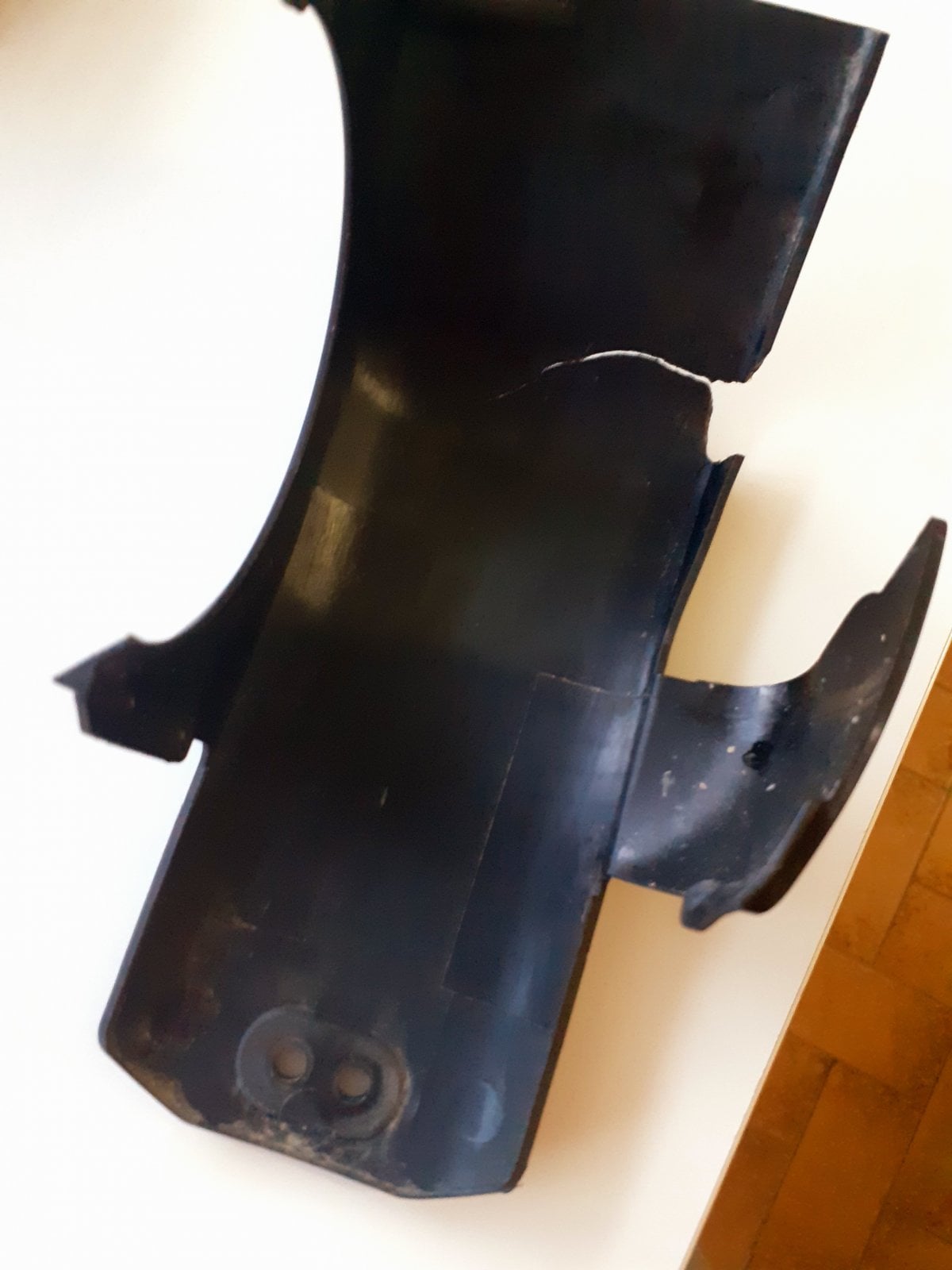

Hi everyones ,here Sergio from Turin (Italy)..
Can someone can tell me how I can fix the issue with the bottom plastic motor protector mounted on The Norco Range/Sight???
I broke it last Sunday descending on a rock...
ps* any Idea how to repair it???new plastic or alluminium cover
Thankz !!!
Sergio

Hi, as soon as I hit that plastic against a stone I new it was exposed and frail piece of plastic. I ordered Norco Range/Sight VLT 2019/20 as protection. It adds an extra of protection on top of the existing plastic.
Have you got some pictures to show...
of the extra protection that you have just order ???
Sorry i didn t understand.
Thank you.

Raffe’s got it right. My stock guard cracked in like 2 rides.
You’ll want to replace It. The Rockguardz carbon one goes over it, it’s an add-on not a replacement. Seems sturdy though!

I tried one, looks nice but it’s garbage. It only lasted a month before it disintegrated. It’s fibreglass or carbon cloth with resin and after the fist hit it cracked so I layered it with 3M frame tape but that only lasted a few more hits. This part needs to be aluminum but none are available aftermarket.

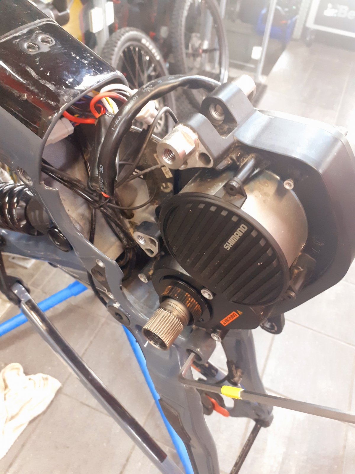

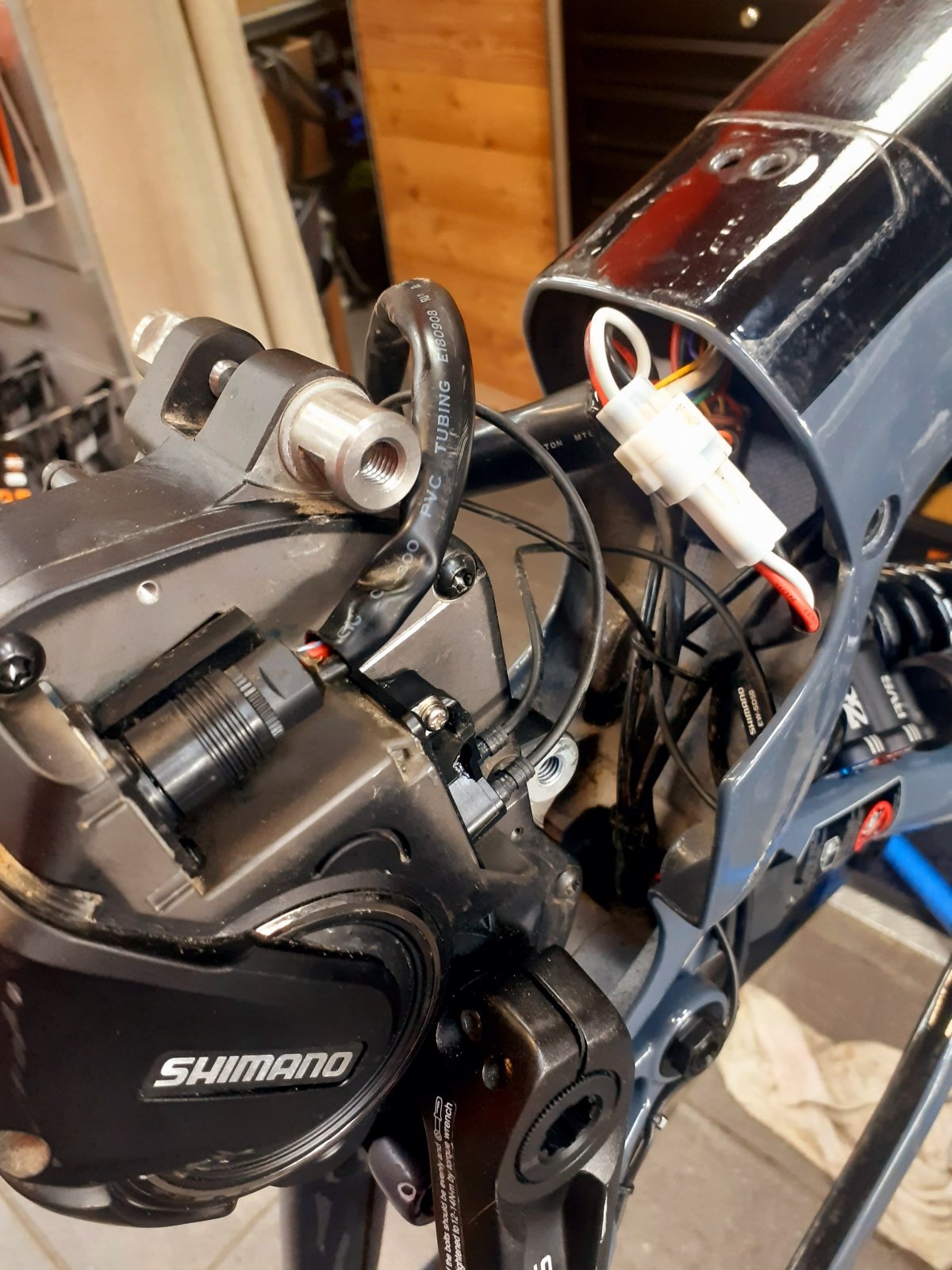

Just read this post. I just removed my E8000 for the second time. It’s. Not rocket science! Just need a set of bike sockets and a torque wrench ( for reinstall).
1) remove front motor guide
2) remove both cranks (small removal tool need for tensioner).
3)remove chain guard (2 bolts)
4) remove chain from front sprocket and remove front ring from spider
(4 bolts).
5)remove the 2 motor mount bolts that pass through the rear motor
protector and remove the rear protector. (is There is one more screw on the drive side to remove). Be sure to replace the rear protector when
replacing these 2 screws. Yes, I forgot!
there are 4 more screws holding the motor in. Two are relatively short and 2 a bit longer.
6) the motor should now be loose. I found that the motor came easier by moving it slightly forward and then gently removing it. There will be a
main wiring harness and 2 black wires connected to the motor. One of these wires had came loose, necessitating the motor removal!
Easy fix, poor design!
The hardest part was the reinstall. The wires going to the charger port, etc. just don’t seem to have enough space. It is a very tight fit.
my secong removal was another power failure that I believe was my
fault. One of the aforementioned wires got jammed between the frame and the motor on reinstall. It’s going to necessitate a new charging port and a couple of wiring harnesses. I’d suggest using A couple of small zip ties and maybe a bit of ”Gorilla tape” to hold these wires in the channel between the motor mounts.
