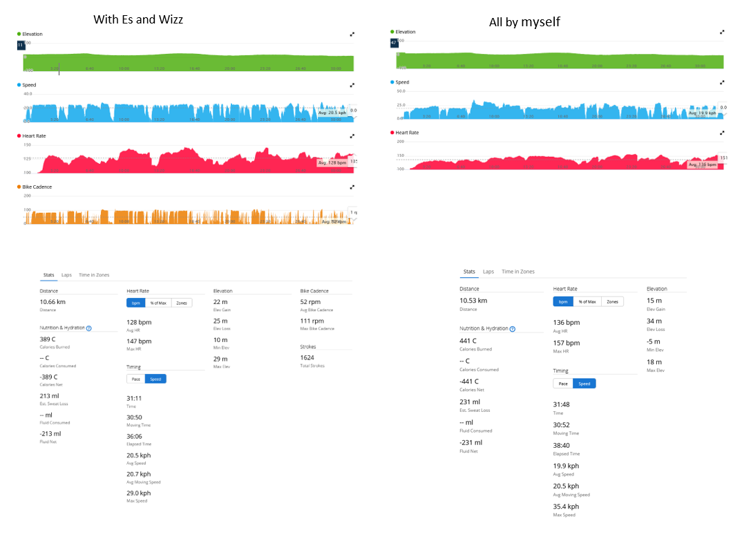

I've just done a quick comparison of the stats of my way into the office on my old Stumpy compared to my new Levo Comp. The routes are practically identical with just other bike traffic and traffic lights making the difference.
Basic stats:
DistanceElevation GainTimeAve SpeedMax SpeedCaloriesAve HRMax HR
With Es and Wizz10.6622m30.520.529389128147
All by myself10.5315m30.5219.935.4441136157
Details and graphs in attached file and below.
It's all on hard (brick / tarmac) bike paths and roads with overall a slight slope downhill with a couple of uphill sections that you only notice when riding a bike. Turbo mode the whole time.
It confirmed my feeling about riding the ebike on roads. It removes the painful bits, but does not make a huge difference overall. I accelerate quickly to 25 km/h, then the weight of the bike and lack of support become very noticeable. Despite that, I seem to spend a lot of the time (just) above the support limit, which meant that my calories only reduced by about 11%. The most noticeable difference was the lack of pain on the long uphill "slogs", which explains the slight difference in HR stats.
Of course on a long tour, one could also just put it in turbo, crank slowly and eat up the miles at 24.5 km/h :)

Interesting data Tim,
You bring to life the 'real' story behind the difference eMTB's make. I rode my Giant Anthem XC acoustic bike at around 15-17mph, so a full fat eMTB at the 15.5mph limit doesn't get me there faster, in fact like you it's about the same or slightly slower as it weighs twice as much ?
Different level of fun though and the "exploration" the eMTB has open me up to has been epic. No more "Not riding up that hill as there might be nothing up there, to let's see what's up there"...

That's a, seriously flat commute.
Your results pretty much show just how useless a restricted Ebike is on a road commute
How are you measuring Calories? :unsure:
Add hills or derestrict the motor and your results (avg speed and calories consumed) would be vastly different.

I do a 60 to 70 km road tour now and again early on a Sunday. It too is fairly flat so I tend to sit on 28 to 32 kph except for the odd rise where the motor kicks in. I use one bar of battery which I guess is roughly 20% or 100wh.
It would be fine to commute on - better than the flat bar roadie I commuted on for years. Maybe a little slower on the level, much faster uphill, same down (because 70kph on a pushie is my limit) and able to jump gutters, potholes, pedestrians, etc.

My one commute road on mtb ebike confirmed what i expected, not actually any quicker due to limiter on the flat, despite making more speed up hills. Far easier though.
It does however cut 5-10min off my normal 60min 'offroad' footpaths and bridleways commute, due to quicker acceleration and previous low average speed of 13mph meaning power assist is on for most of the ride.
I think there is the difference. When you have a lower average speed over a longer distance, an e-bike can make a world of difference.
My 60 minute commute I do a 22km/h, so really flat and I don’t feel it’s worth switching to an e-bike to get there 10 minutes earlier. But if I was grinding along at half that average speed, the decision would be way easier ?

I was 3-5 minutes faster on a my road bike compared to my ebike (rail 9.8) on my 35min 17km commute. Don't remember the elevation, some long, but not steep climbs. Difference was that I didn't need a shower after the ebike ride.
