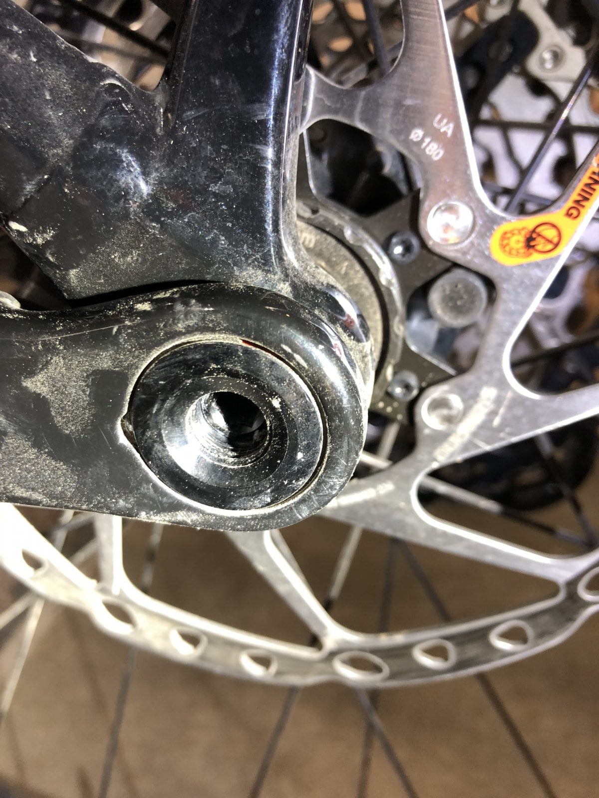

Today I noticed a noise on my Rise H15. I thought the cassette was loose, but it turns out that the threaded boot on the non-drive side of the rear axle has come loose. This holds a washer in place that is now dancing around. I see no way of tightening this. Even with the axle tightened to its 10nm, it's still loose.
Has anyone else had this problem?

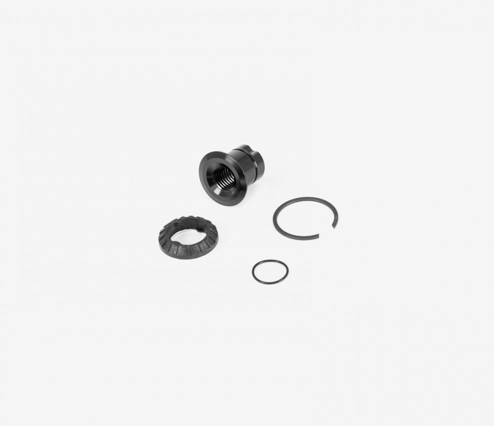

It looks like the assenbly is fixed into the frame with a circlip...and that circlip looks to be broken. If so remove the remains of the circlip, remove the assembly, clean, and refit with a new circlip.
How do I remove the assembly'? It's threaded into the frame and I don't see any way to remove this. I don't even understand how they've got it in there.

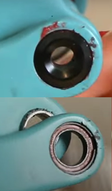

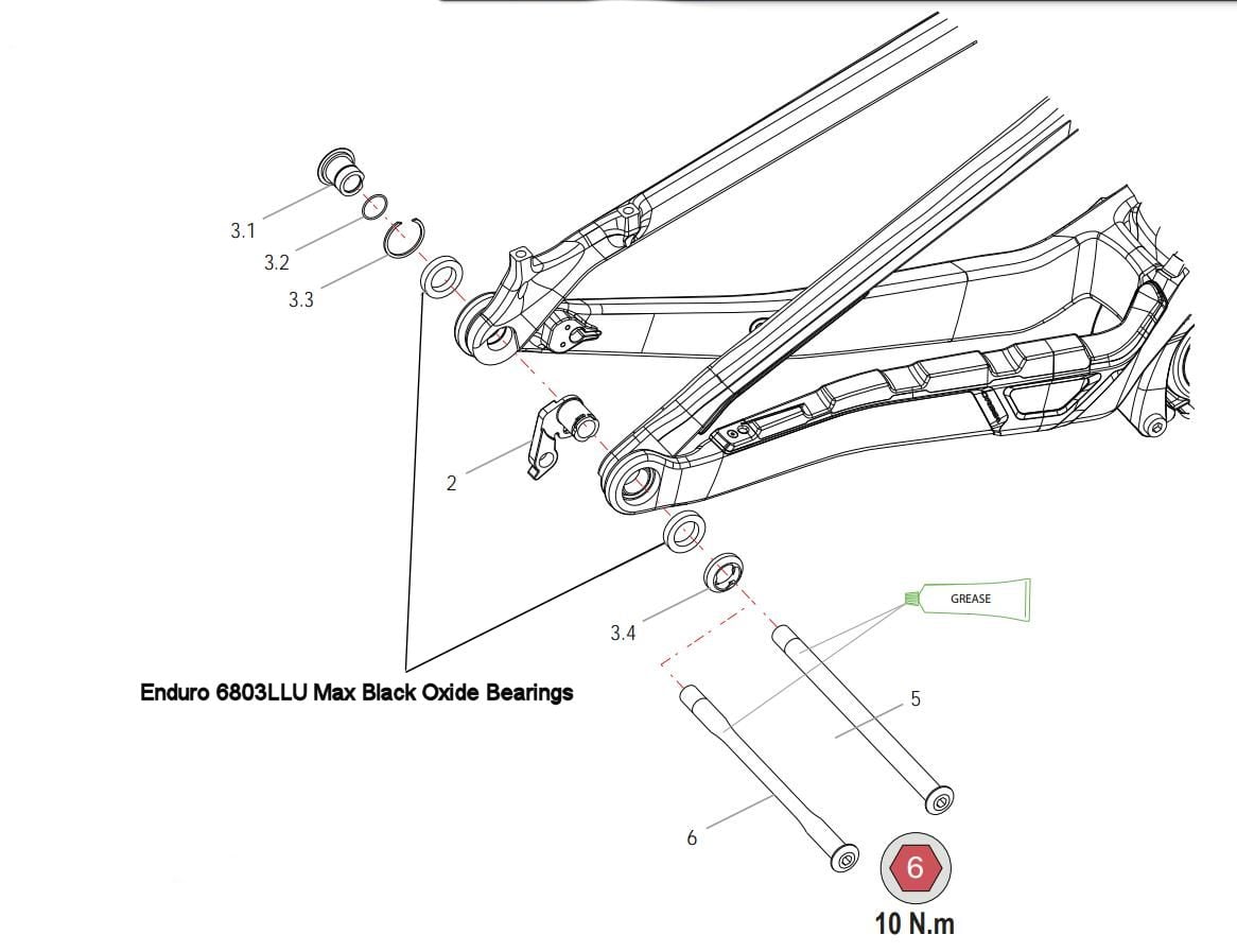

Maybe these will help. Looks to be held in place by the axle and when the axle isn’t connected it’s held in place by the o-ring? Might just push out from the inside? 8A3CC797-BD1D-4E1B-B1E5-E8B48EABB7D7.jpeg

This is how it should look. Looks like the whole assembly has popped out when the wheel was off or when the axle was pushed in and the circlip has popped out of its location. Maybe just remove it all and it put it all back together with everything properly seated so the outer cover sits flush and try not to push too hard when installing the axle

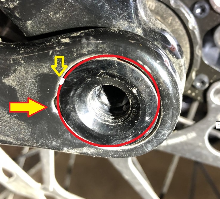

(Edited) The circlip should be used to hold the bearing, and should not be easily seen normally.
Normally the circlip should not pop out. It should stay inside a groove. I guess it might be a bad workmanship that allowed the circlip not fully housing in. And the bearing now might be pushed outward such that you can see the circlip right now. You may need to press the bearing to seat in completely before the circlip can be seated in its groove.
Check the video belows that helps you the orientation.

The circlip opening (yellow arrow) should be placed near the notch (solid yellow arrow) because you want the tool insert can easily squeeze the circlip out of the groove. If you place the opening opposite the notch, you may find it is hard to do that.
