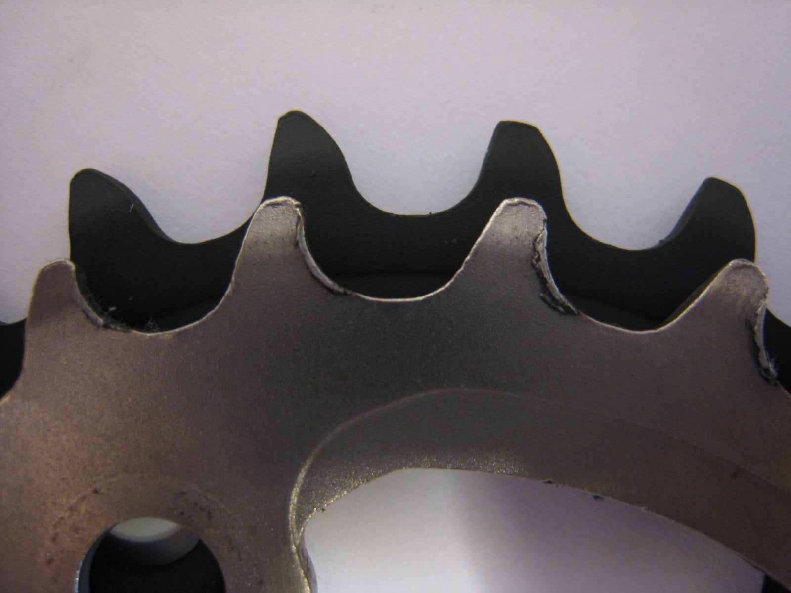

Front rings wear just the same as cassettes. Even faster now that there is mostly only one of them to share the miles! Have a look at the pic below to compare your front ring. The new one is at the back!
Normally it is the hook shape on the teeth that clings on to the chain, but burrs can do that as well. The burrs are created by chain pressure and will definitely contribute to chain suck by catching on the sideplates. As a possible quick and temporary fix (one ride), you could file off the burrs. That should allow time to buy a replacement ring.

Finally changed the front chain ring and the new chain is fine again.
