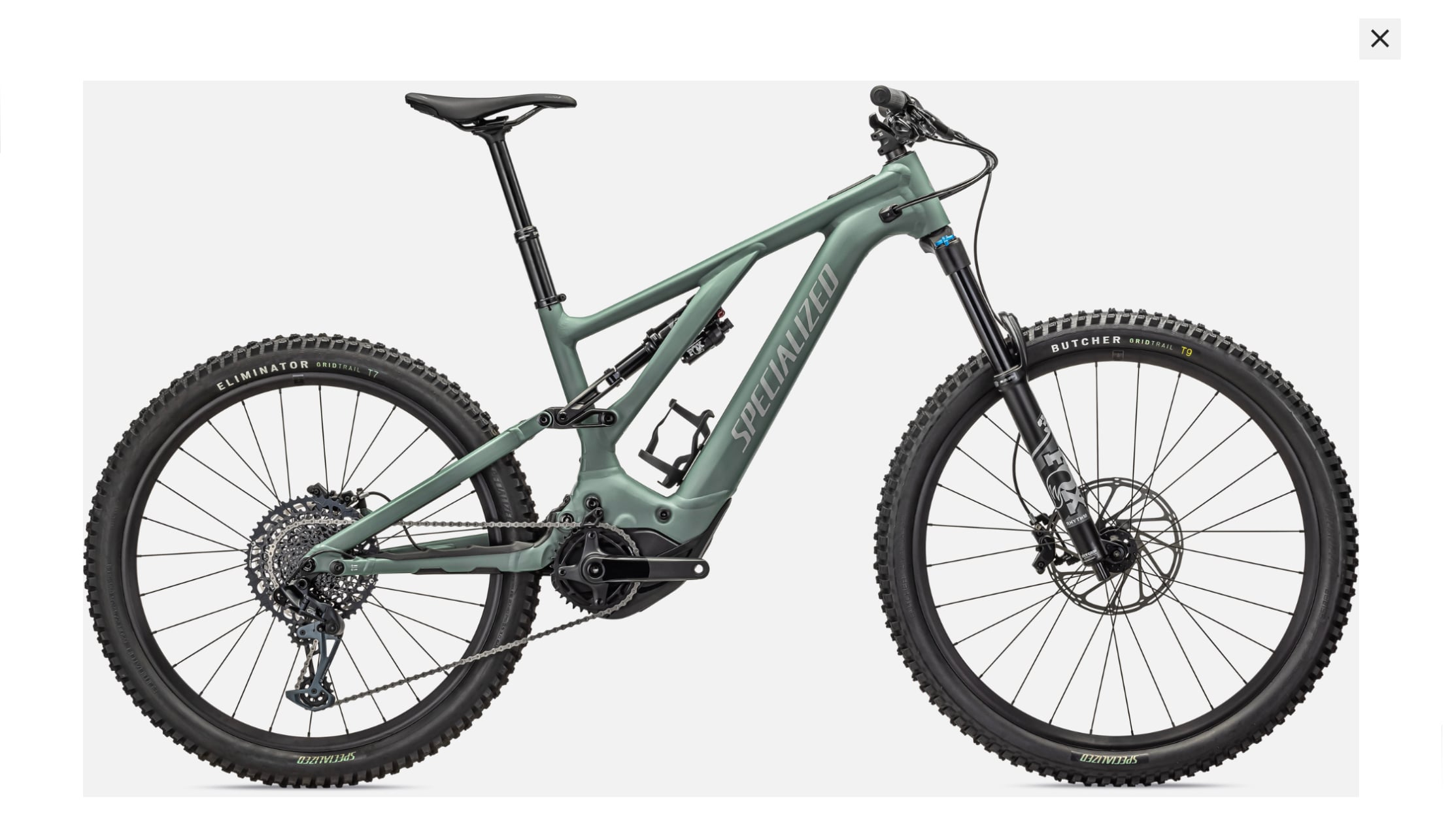

An update on this post everybody in the shop said this was normal, but I couldn’t live with it. They made me an offer to change back to Specialized turbo levo a difference of night and day. I’m so happy with the new turbo levo it’s so quiet, no way comparing with the Bosch.
