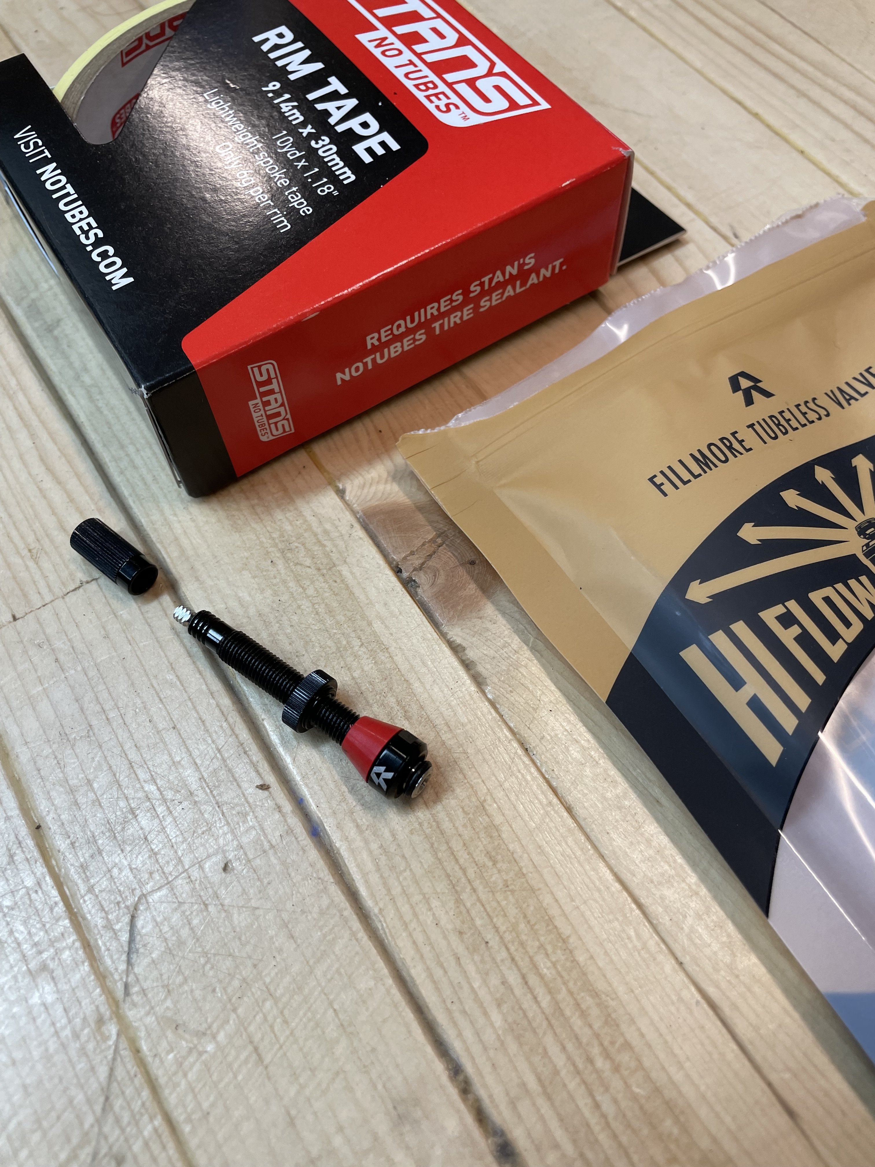

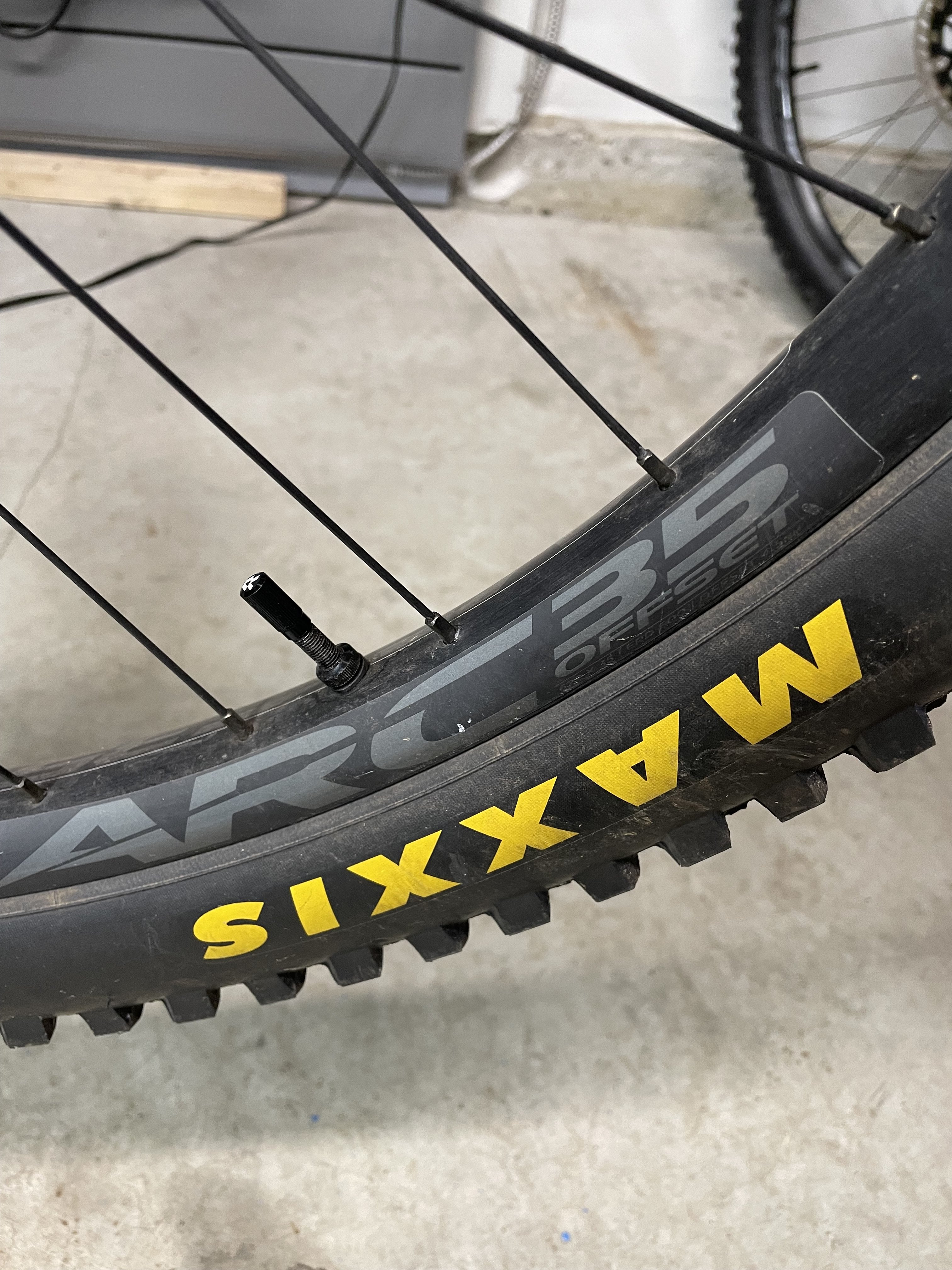

My air inflators seem to be gathering dust. I’ve switched over to Filmore air valves on two bikes. Both bikes were tubeless before but when I needed to install new tires I decided to try these Filmore presta valves.
I usually ride with 26psi front and back on the Full Suspension with a CushCore Pro on the rear only. I believe these CCPro are slightly larger so they fit into the RaceFace Offset 35mm (29”). I use a Maxxis Assigia 2.6” on the FS.
A LBS mechanic showed me a few techniques to help with the tubeless tires after I replaced the hubs and upgraded the rims to RaceFace offset alloy rims. 30mm for the Hardtail and 35mm for the Full Suspension. The increased POE on the hubs was a noticeable improvement. Anyways, I installed the presta Filmore valves.
I used Stan’s tubeless rim tape on all the wheels. I use to think you needed 3 hands to apply the rim tape but a soft floor and a wall worked. Support the rim between your legs, on the floor and against the wall. Begin taping 5” before the valve hole while slightly stretching and making sure the tape is positioned in the valley first. Use a small towel to do this so you don’t accidentally cut the tape with the pressure of your fingers. Lift the tape to remove any wrinkles as you apply and centre the tape. When you’re satisfied with the application heat an awl to melt a hole through the tape and valve hole. Insert the valve and finger tighten the nut. I then tighten an additional 1/8 to 1/4 turn to insure a better seal between the rim tape and rubber on the presta valve. Check this again after the tire and sealant is installed.
I’ve been using Filmore valves with good success. It’s easy to fill with air or sealant but I have added sealant directly into a de-rimed tire. I don’t get any clogging and I can’t remember the last time I’ve added psi to any tire when using these valves. Problem is…they’re not cheap $$.
