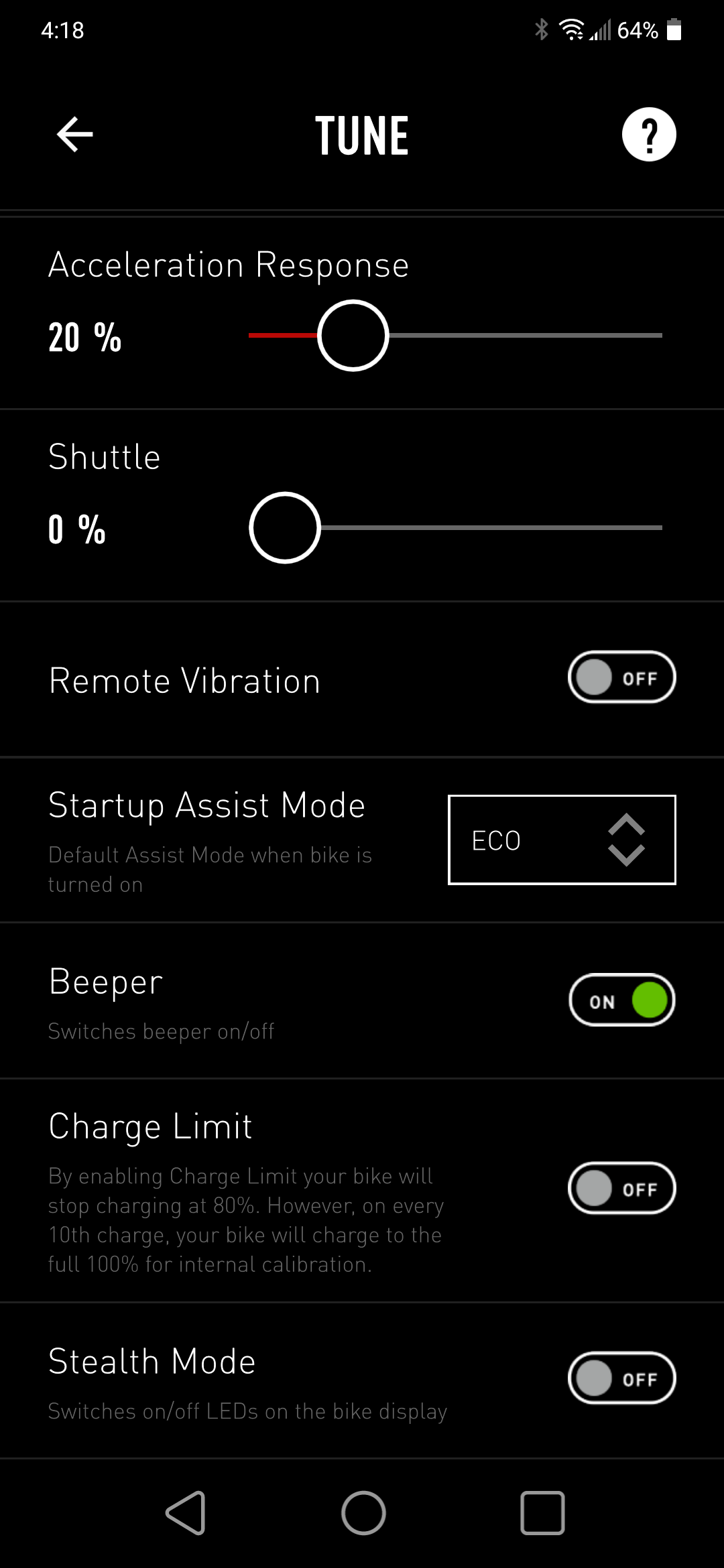

Do you have the Specialized App? Not the Specialized Mission Control App. The Specialized one is the latest app. With it you can limit charging to 80%.
But you original question, With the bike turned off and charger plug into power, plug the charger into the bike. With either app you should be able to read the percent of charge. That assumes you have done the pairing of bike to app. On the first page you should see what you call your bike, under that you should see "Connected" and to the right the percent battery charge this is using the Specialized App.
Mission Control supports charge limits, it was released in MC first

As others have said, set the charge limit to 80% in the app and then forget about it. When you get time to check the next day or two, then unplug it and leave it ready for your next ride.
