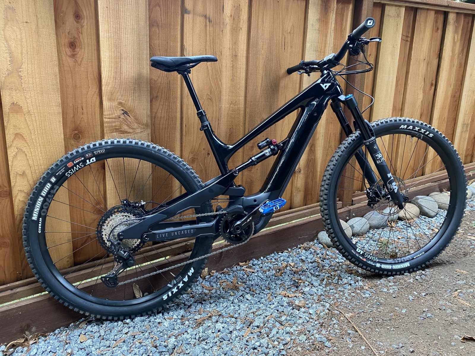

Received my new YT 29 Pro and assembled it yesterday. Pedals showed up about 20 min ago. Still waiting on bars and stem, but I’ve been playing around on it around my roads today.
I’m not quite sure why they put all these cable grommets all over the bike, when they won’t actually stay in the frame? Quite annoying as the cable and brake housings will eventually start to wear on the carbon. Not sure if this is a new thing, but it needs improvement.
Both of my brake rotors are warped and lots of loose bits. Clear to see they built it on a stand and never actually test rode it.
Looking forward to going for a ride, although I already regret not getting the Elite Mullet.
