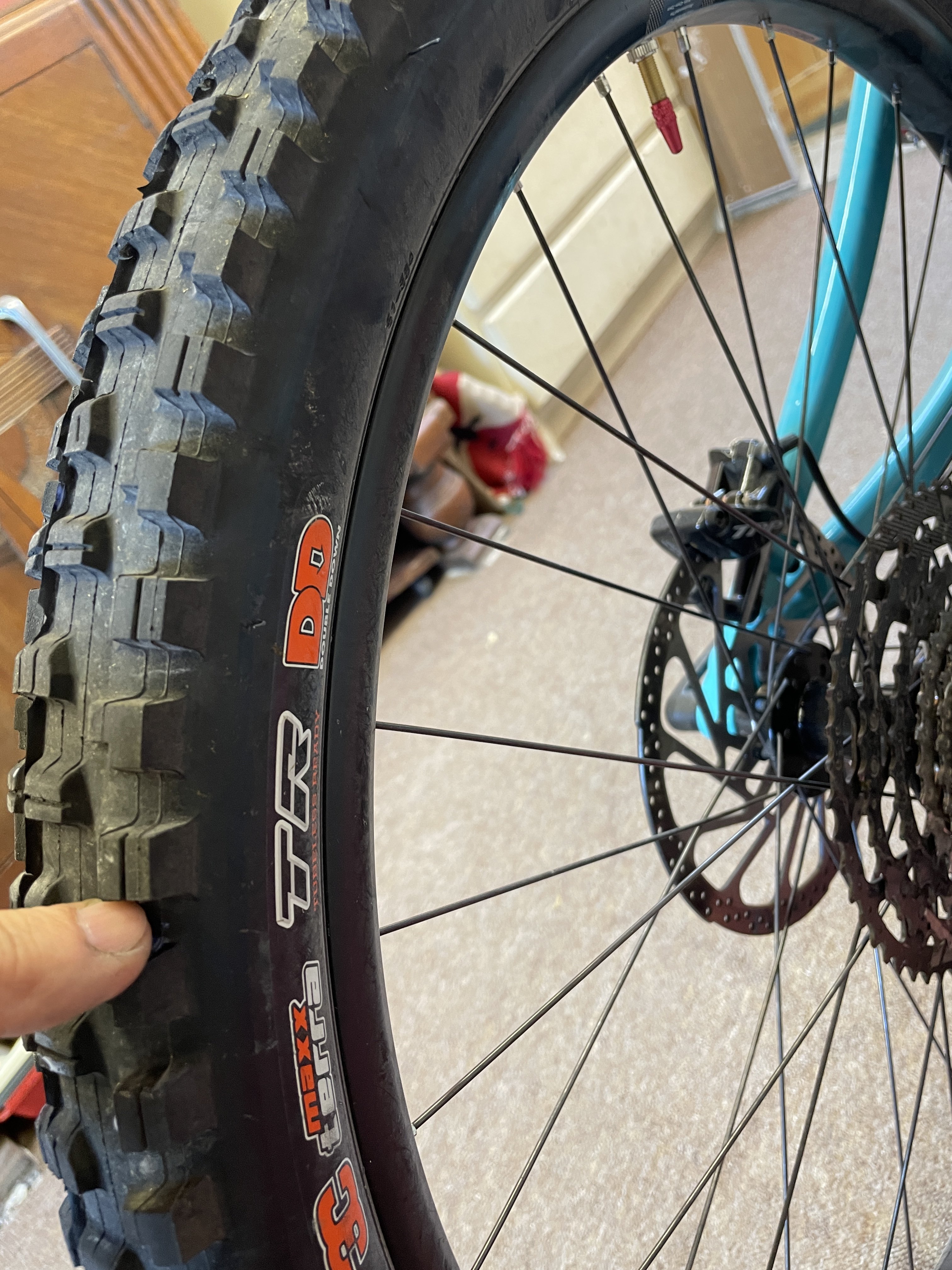

My new Whyte is my first bike without an inner tube and I just found a long thorn in the back wheel.
I pulled it out and hisssssss , so I turned the wheel so the hole was facing down and it sealed immediately with a little bead of white sealant showing.
So great, this tubeless stuff really works!

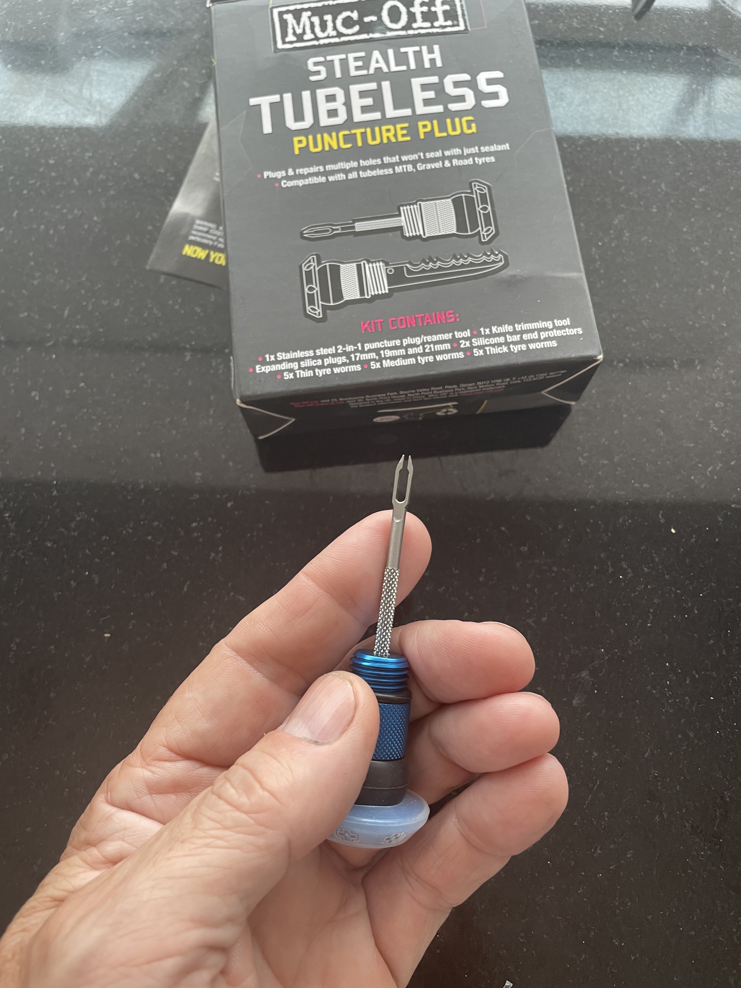

I did get a MucOff bar-end puncture kit but did not use it and will not - unless the puncture leaks again.
Looking at the insertion tool I wonder if forcing a 4mm wide fork into a tiny thorn hole could end up doing more damage to the tyre vs just letting the sealant do its thing.
Also the MucOff box says right on the front Plugs and repairs holes that won't seal with just sealant.
