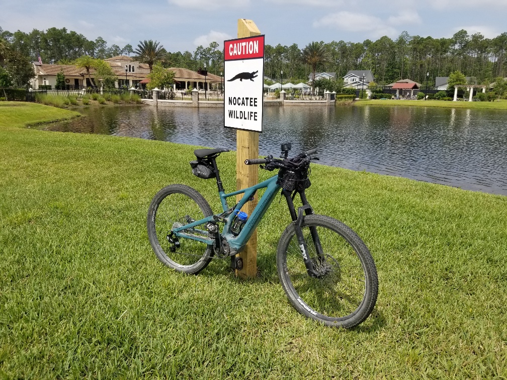

I changed my Levo SL from 29" to 27.5" wheels and 2.1 tires. It lowered the bike about 19 mm, quickened the steering and changed the trail slightly but no other changes to the geometry. I do not ride rock gardens and have had no pedal strikes or any other ground clearance issues.
Your description of "urban and light trail use" is probably similar to what I ride (dirt, sand, gravel plus 6 miles of pavement to get to the dirt).
And that's as close as I get to the water! ;)
Thanks, that's what I was going for but for now I've gone with a different bike, thanks for sharing though as it's good info for if/when I get a Levo and do the same thing.
