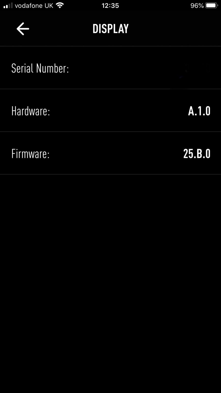

After some info if possible please, just picked up my bike after a service (2019 levo) from local spesh store (uK) and they told me they’d updated the firmware on it, before it went in it had 1A.B.0 now it has 25.B.0...anyone know what changes/fixes the new firmware has?
Any release notes for new revision? Can’t find anything anywhere...
Thanks
edit: looks like the startup/shutdown sequence of blue LED’s on the TCU has changed slightly? Looks smoother? Or am I just imagining it? ?

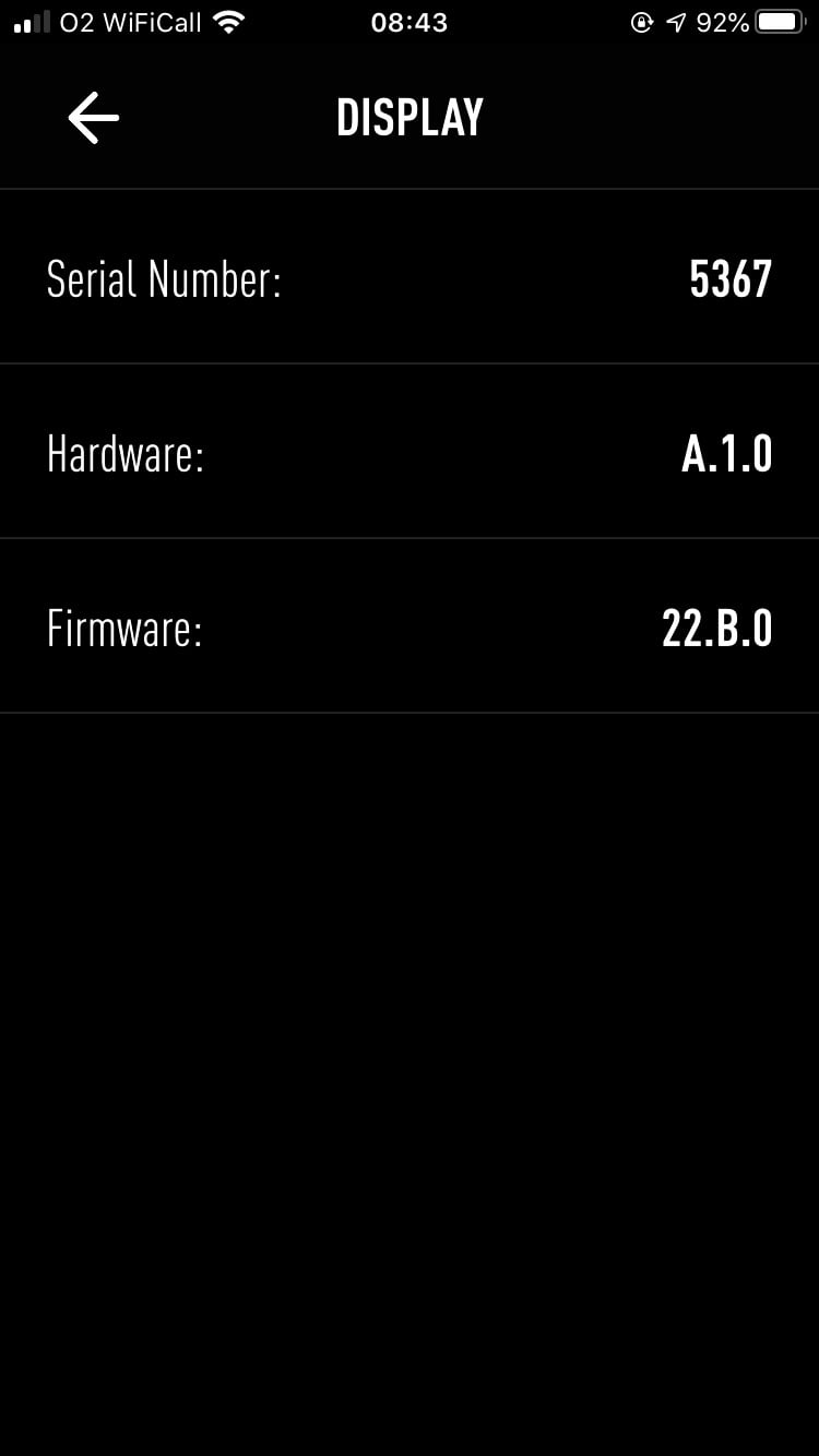

Must be really new got mine done a few weeks ago and it’s 22

Noticed I no longer need to press and hold the power button until the lights come on/go off. A single quick press does the job now. Or maybe it’s been like that since I had it and haven’t noticed it before ??

ive got 25 as of yesterday, the sequence of lights has changed for certain, but ive only noticed it when turning off.
weirdly, the motor behaves differently now, its doing stuff ive not noticed it do before.
today I rode across the beacons and was just spinning at my usual RPM and I had been for a while when the motor just 'took off' and it drove me along instead of me pushing the bike along. I had to change a few gears in order to keep up with it. like I say, never happened before but it happened many times today.. I also had the flashing red/blue lights out of nowhere..

Interesting, yes I’m sure somethings changed although I haven’t experienced any error codes....yet?....noticed my settings on the tune page in mission control had changed too....shuttle mode was on 100% and acceleration down to 0% so I had to reset my all assist levels etc etc

I just picked my bike up from a warranty job yesterday and the shop had updated the firmware on the TCU. The only mentioned was error logging via the app. So, if you get an error code then fire up the app and the fault will be communicated to Specialized and logged with them. This in turn can be relayed to a dealer for remedial work to be properly targeted rather than relying on an individuals account - particularly useful for intermittent faults, I'd have thought. I expect this links in with tamper-detect procedures.
