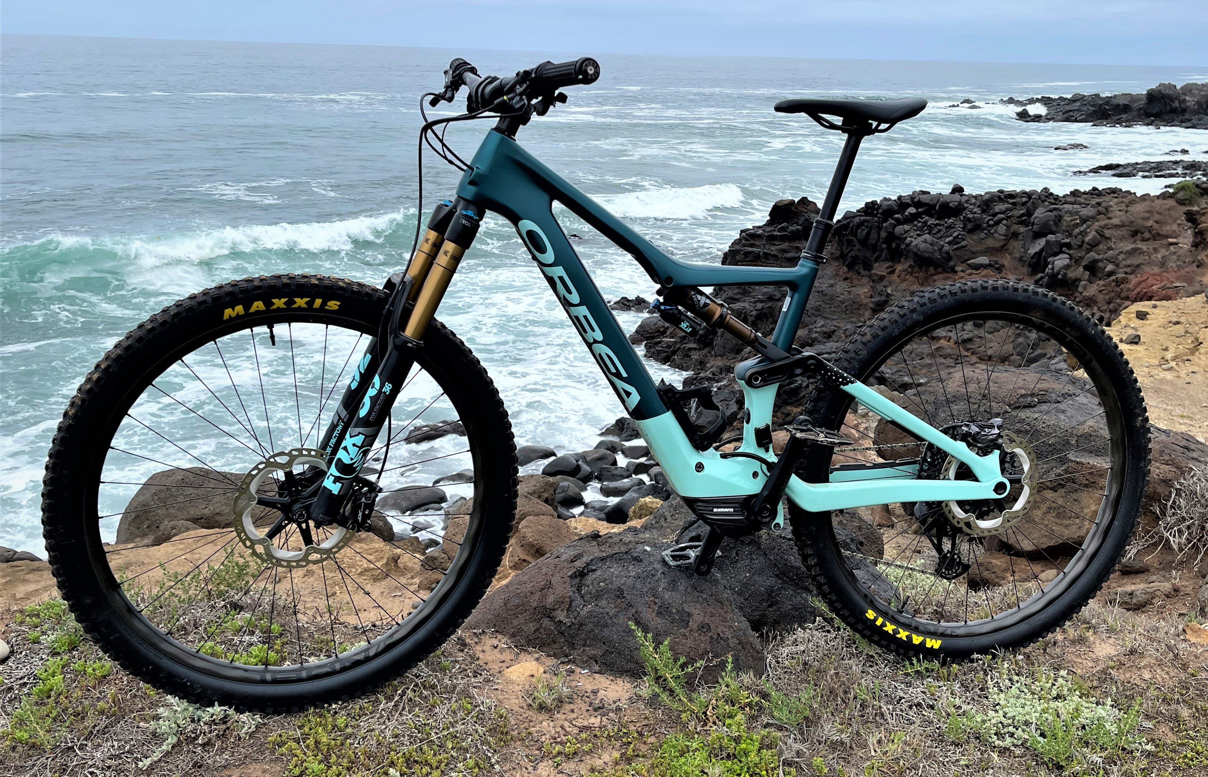

I ran a Nobl TR37 wheelset with I9 Hydra hubs on my Rise M20. My preferred tires are the Assegai up front and Minion DHR II on the rear. I ride about 2,500 miles/4,000 Km a year. The Hydra rear hub/freehub did not hold up to the motor's torque and the amount of miles I put on my bike, on a weekly basis. I was replacing rear wheel hub/freehub bearings about every six months. There are a lot of great wheel hub manufacturers however, for the money, the DT Swiss 350 hub is pretty damn bullet proof and holds up well to eBike motors.
I've lately been gravitating towards alloy wheels. As I get older (63 Years Old) I find that carbon wheels tend to provide a harsh ride which transmits up into by arms and shoulders. I do like the compliance that alloy wheels offer. I'm currently running a set of Industry Nine Enduro S alloy wheels with 1/1 hubs. The set costs $640. Let's see how they hold up......Wahoo!
Upgrade Six: Rear Shock
The Fox DPS shock (210mm x 55mm) is acceptable if you tend to ride flow trails. If you tend to ride more technical terrain, the DPS without a piggyback reservoir will quickly heat up and begin to loose performance. I upgraded my Rise M20 to the Fox Float X. The Float X is a really nice shock and an upgrade over the older style DPX2. Some Rise owners have upgraded to a coil rear shock and or have used offset bushings to increase the rear travel on their Rises.
Baja Norte Mexico

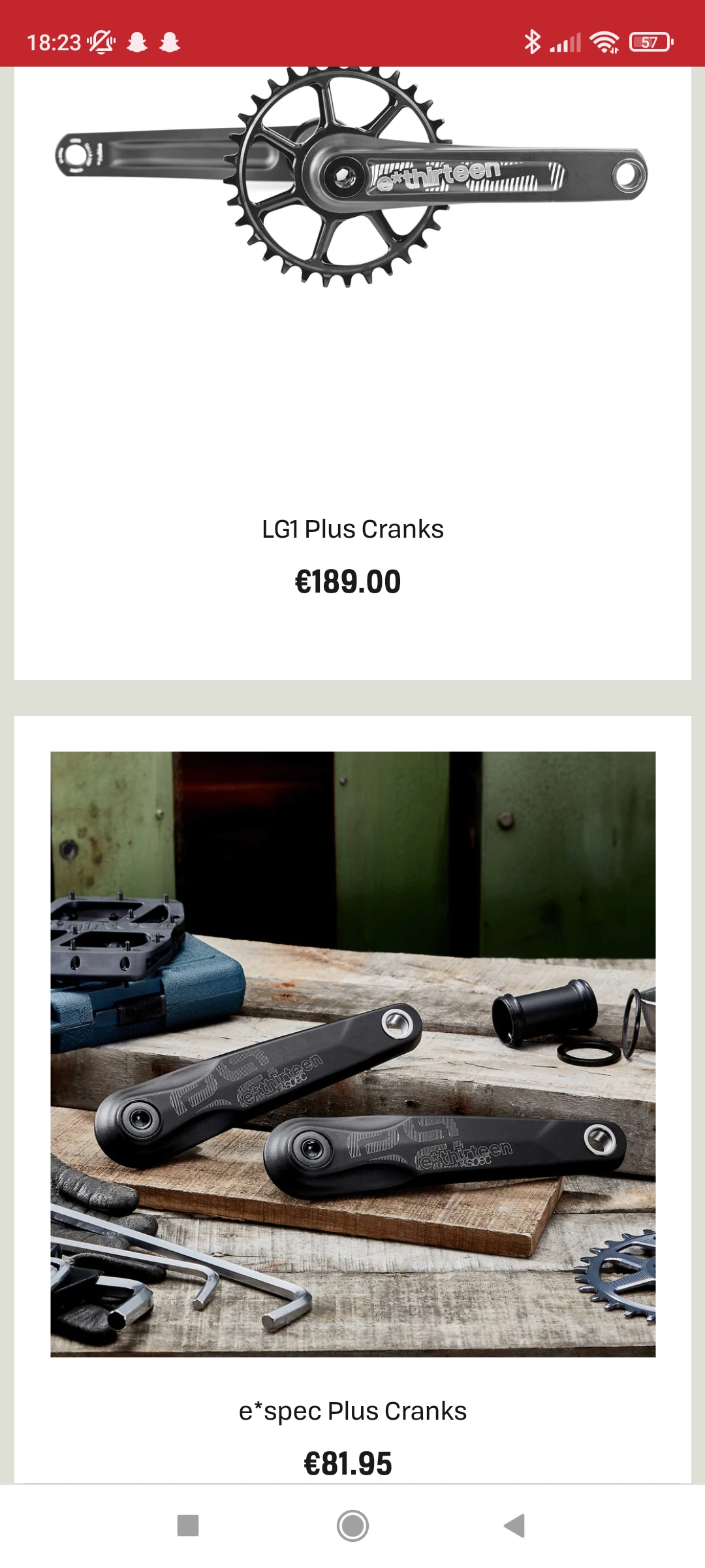

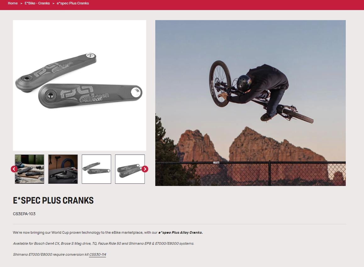

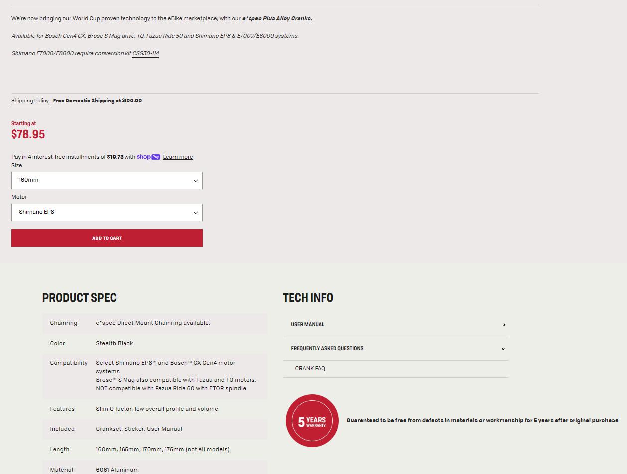

Beanzz,
You want to buy the eThirteen, "e*Spec Plus Cranks" for Shimano. The eThirteen chainring for the EP8 motor is not included with the e*Spec Plus Cranks. All you get are two alloy crank arms, no rubber boots, no chain ring, nada.....
When you visit the eThirteen website and click on the link for the e*Spec Plus Cranks, you will be taken to the configuration page. eThirteen offers eBike crank arms for various motor systems, i.e. Bosch, Brose, etc. In the "Motor" drop down menu you will need to select "Shimano." Then select the size of the crank arm you want. The website will let you know if the crank arm in that length is available or sold out. I checked the U.S.A. website and it shows 160mm cranks for the Shimano EP8 are in stock. The 165mm is sold out.

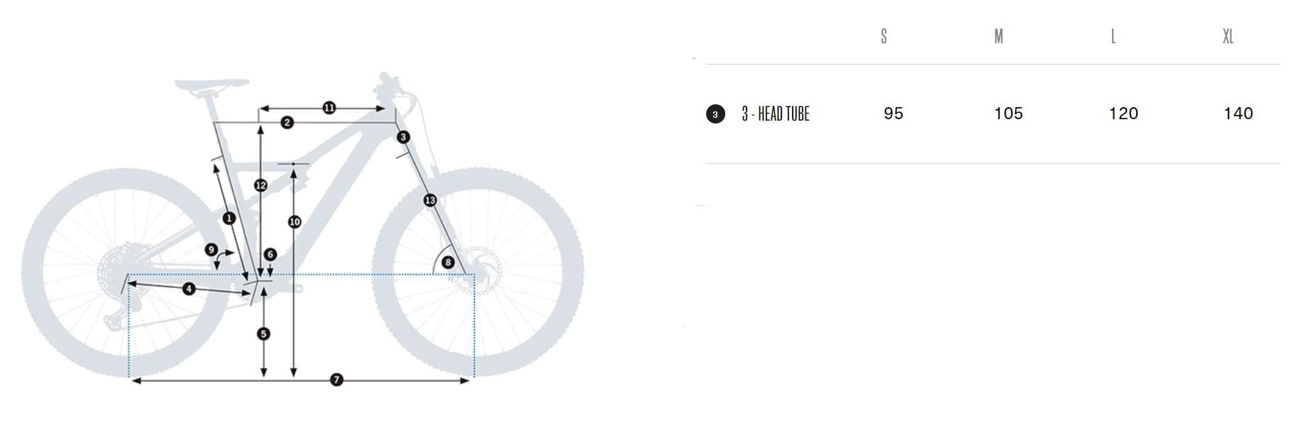

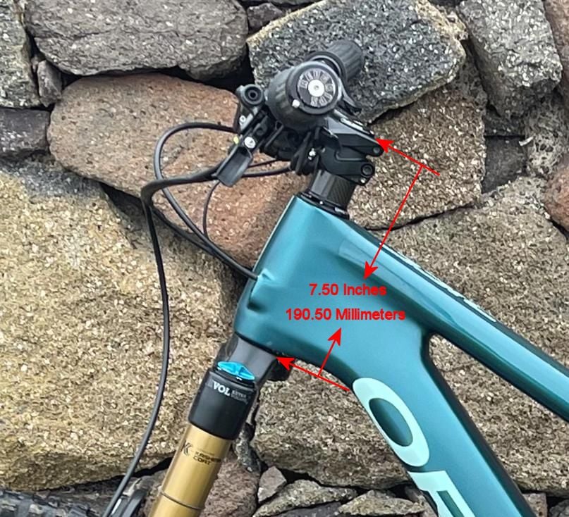

I saw you posted a question on the Orbea forum concerning "Steerer Tube" length for the Rise XL frame.
Here was your question:
So I've just been trying to figure out how long of a steerer tube I would need on a pair of forks.
So far I've discovered the xl frame is 140mm but I can't seem to find the height of the stem unless it's just 35mm
I'm assuming you are considering buying a used fork? A used fork will typically have a cut steerer tube. You want to know how long the steerer tube needs to be in order to fit the Rise XL?
I can sort of help with this if this is what you are asking about. My Rise was a size Large and my friends all have M series size large frames. Each of our size large bikes came with a "Cut" steerer tube length of 7.50 inches, or 190.50 millimeters.
The Rise M series large has a 120mm head tube length, whereas the extra large size frame has a head tube length of 140mm. The difference in size between the two headtube lengths is 3/4 inch or 20mm.
Add 20mm to the 7.50 inch or 190.50 millimeter steerer tube used on the size large frame and you get a length of 210.50 millimeters, or roughly 8.25 inches. You need a minimum cut steerer tube length of 210.50 Millimeters or 8.25 Inches for a Rise M Series, Extra Large frame.
Note, this is an estimate and I do not have access to an extra large Rise to confirm the above. I would verify the above by asking somebody in the forum to measure the steerer tube length on their extra large Rise. You can obtain this measurement by measuring from the top of the crown where it meets the bottom of the head tube, to the top of the stem.
Ah perfect I had a look and I thought that it looked right but I wasn't sure

Beanzz,
I'm sorry, I made a mistake on the steerer tube length you need for a Rise M series extra large frame. I've corrected my previous post to reflect the correct size you need.
I originally told you the Rise M Series size "Large" frame uses a steerer tube length of 8.50 inches. This was incorrect. The length is actually 7.50 Inches, or 190.50 Millimeters.
According to the Orbea Geometry Chart, The Rise M Series "Extra Large" frame head tube is 20 millimeters or 3/4 Inch longer than the size Large frame. Therefore, for a Rise M Series extra large frame, you will need a steerer tube length of 210.50 Millimeters or 8.25 Inches.
Note, if you are a taller person, you may want to consider going slightly longer on steerer tube length. I'd suggest something around 213mm to 215mm (8 3/8" to 8.50"). The longer steerer tube will give you more stem height adjustability. You can always shorten the stem with a file if need be.

Beanzz,
Ohhh ok that makes a lot more sense thank you :D I have to say I do have a minor seed of doubt in my mind as to what bike to get as the yt decoy 29 is looking very tempting.

Beanzz,
I hope this helps,

The was an issue with e13 cranks on the orbea rise last year so it was recommended to switch to shimano. Has that issue been resolved?
ethirteen crank arms are perfectly acceptable.
There were several issues related to crank arms when the Rise first came out. eThirteen was the crank supplier for the Rise. The higher end models of the Rise came with carbon fiber crank arms. There were issues with the carbon fiber crank arm. eThirteen recalled the carbon fiber crank arms and issued warranty alloy crank arms as replacement.
There has never been as issue with the eThirteen alloy crank arm design itself. They are solid and dependable. I've taken some big hits with the cranks and they've held up.
There were issues with the eThirteen alloy crank arms being installed incorrectly by dealers when the first batch of 2020/2021 Rises were sold. I recall the issue had something to do with a rubber spacer being used when it should not have been used. The incorrect installation caused the pedals to eventually loosen up. The matter was resolved long before I bought my Rise in September 2021.
My Rise has 3,200 miles/5150Km on it. The eThirteen alloy crank arms on my Rise have never loosened up, bent, or malfunctioned.

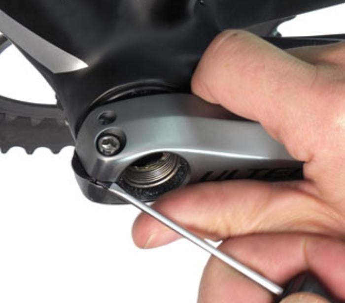

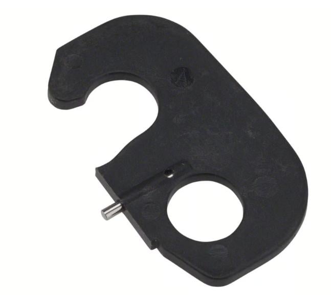

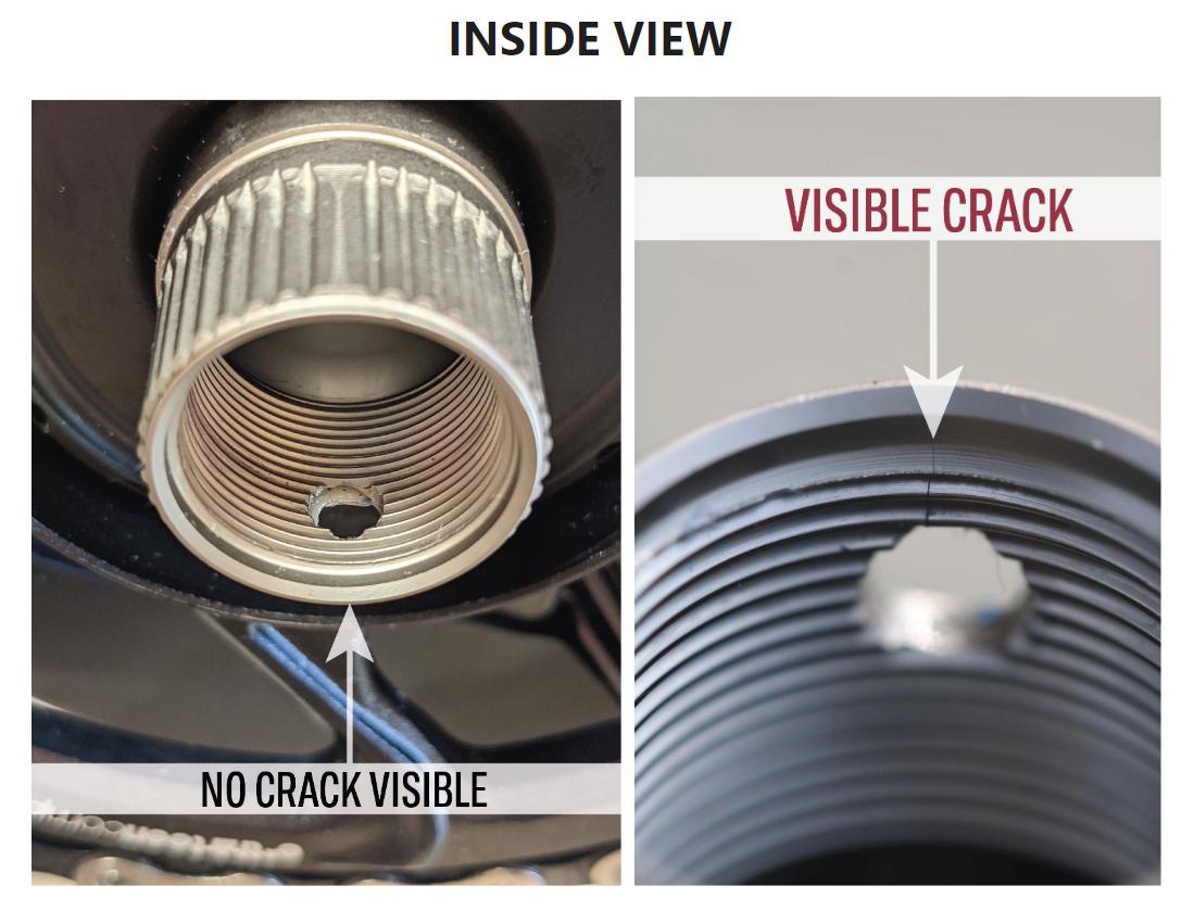

The big issue was stress cracks occurring in the EP8 motor spindle which caused the spindle to fail. Shimano crank arms utilize a safety clip which fastens to the two crank arm pinch bolts. The clip has a pin which inserts into the hole in the EP8 spindle and prevents the crank arm from falling off the spindle when riding.
Unfortunately the safety retention hole creates a weakness in the EP8 motor spindle. A stress crack can develop as a result of the hole.
When the Rise and EP8 motor first came out, some owners began to experience motor spindle failures which were attributed to stress cracks at the spindle hole. People began to blame the cause of the failure on eThirteen crank arms and suggested Shimano crank arms should be used instead. There was nothing wrong with the eThirteen crank arms. EP8 motor spindles were failing just as frequently when Shimano crank arms were used.
This was a design issue with the EP8 motor spindle. eThirteen published a technical service bulletin to address the issue. I'm not a big fan of eThirteen components. However, this was not their fault. Shimano should have stepped up and shouldered the blame. Changes to the spindle have since been implemented to strengthen the spindle.
