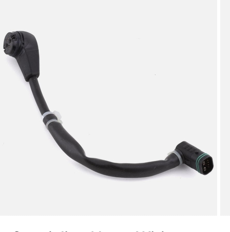

What exactly do u mean by wiring harness . Motor to battery or tcu to motor. Had three motors replaced never needed to replace any wiring.
gaba
Dec 31, 2018
112
129
California
“Battery cable”
Binhill1
🍊 Tango Man 🍊
Mar 7, 2019
3,218
4,978
I got one of those a month before motor went 3 months ago . On warranty but cost is £90 from berkshire cycles. Levo wouldn't start without unplugging and plugging that back in a few times . One in your pic is version four . I was asked if there was greenery in motor connection ( corrosion ) there was . Told to plug and unplug to try and get rid of it . They said moisture comes from inside motor out to the connection. Said it before Ebikes still have a long way to go. Well batteries and motors anyway. Im on motor 4 now 8700 miles in four years 19 levo expert . Still original battery and its as good as it ever was. Good luck anyway. Not nice when they go wrong.
