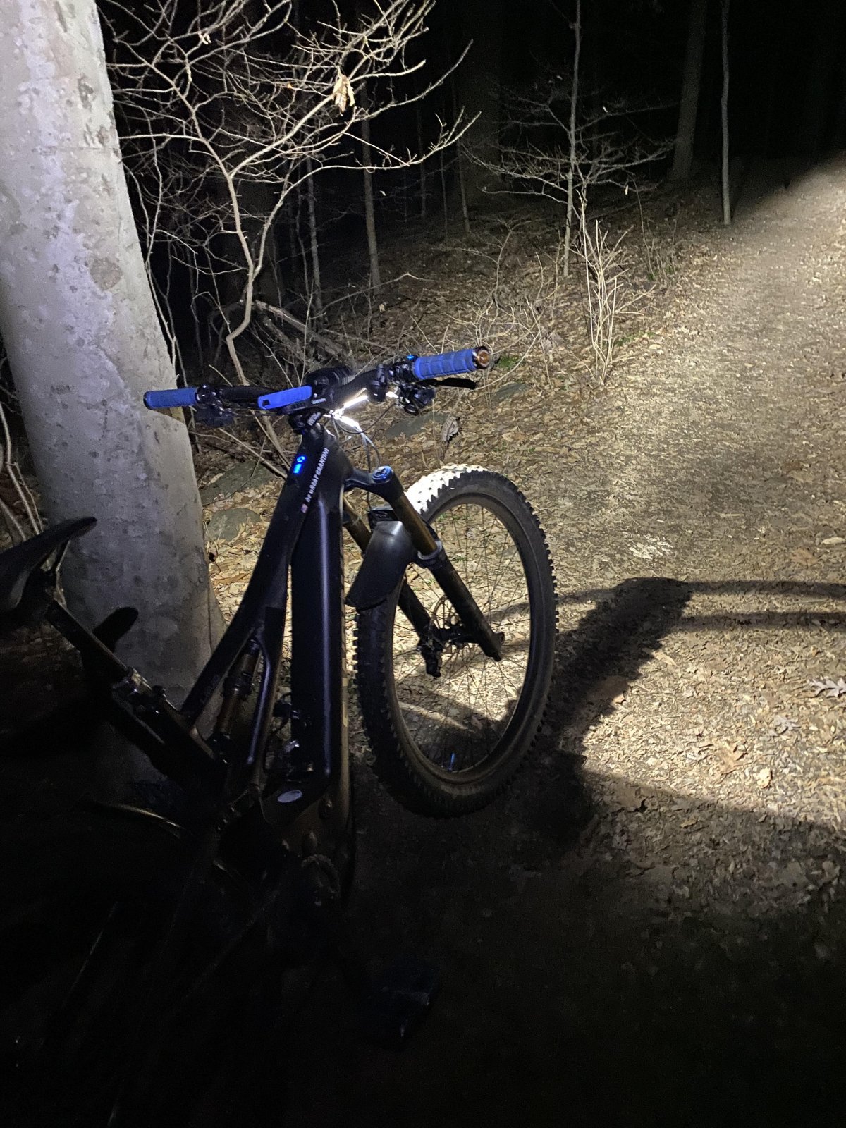

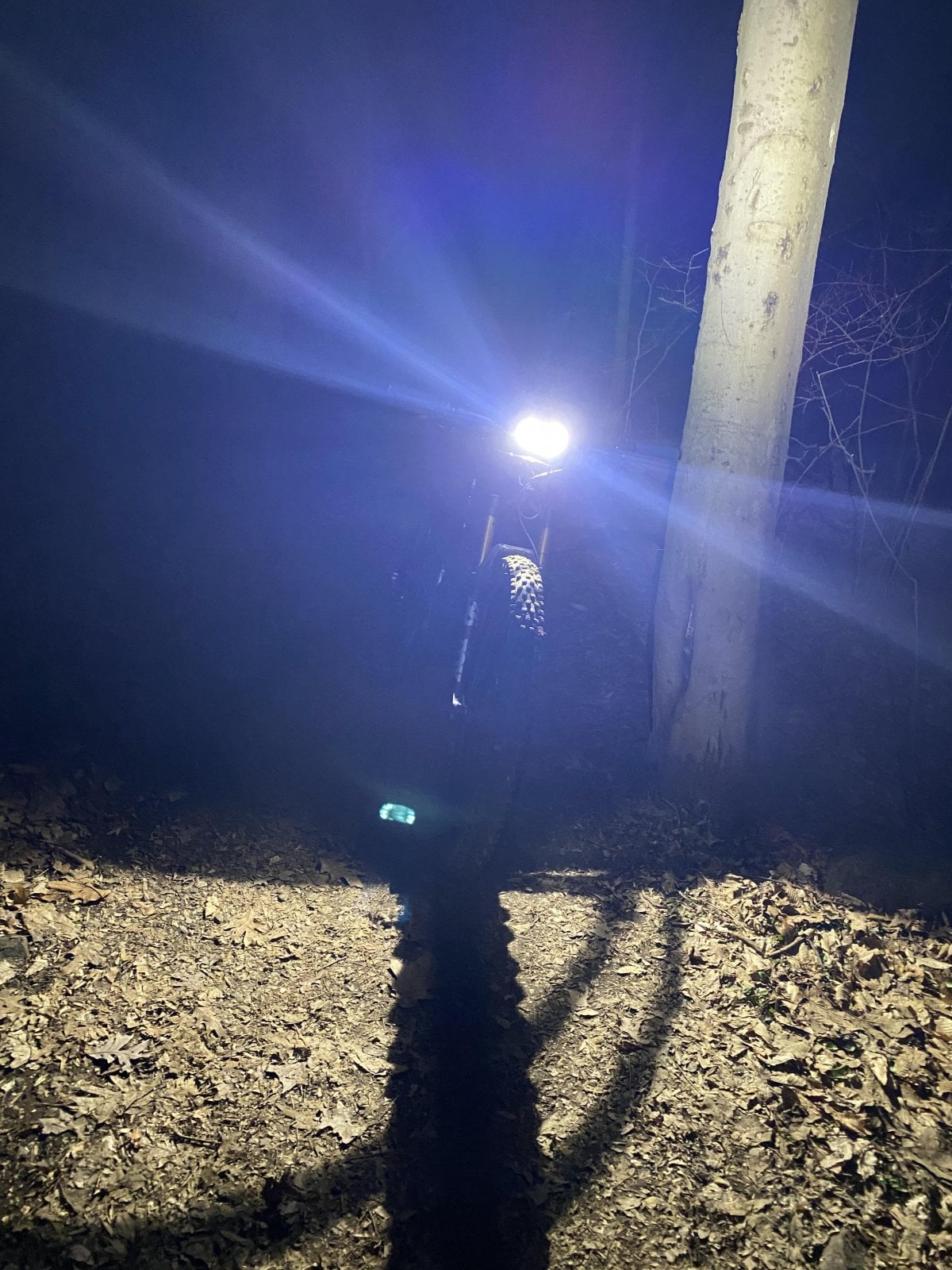

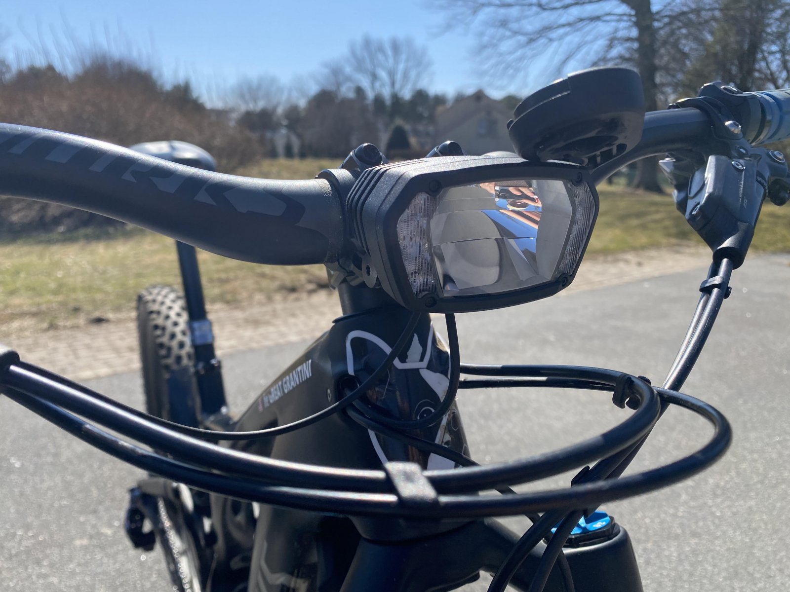

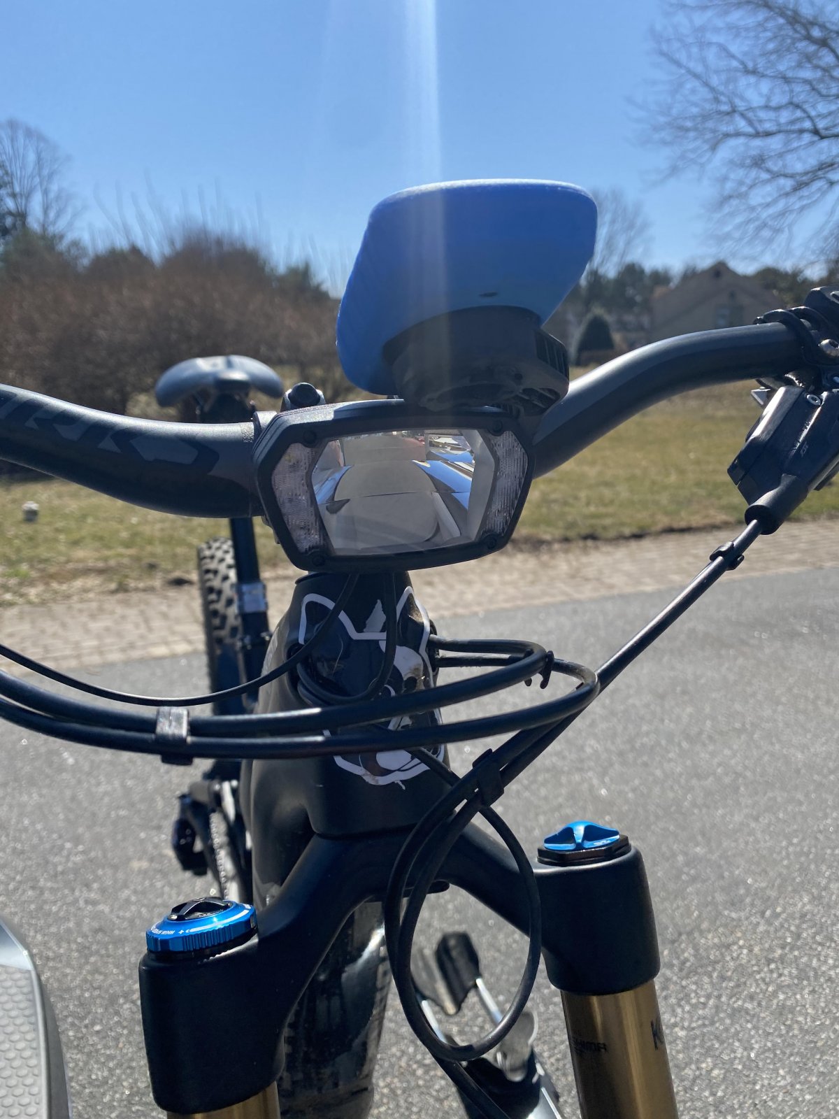

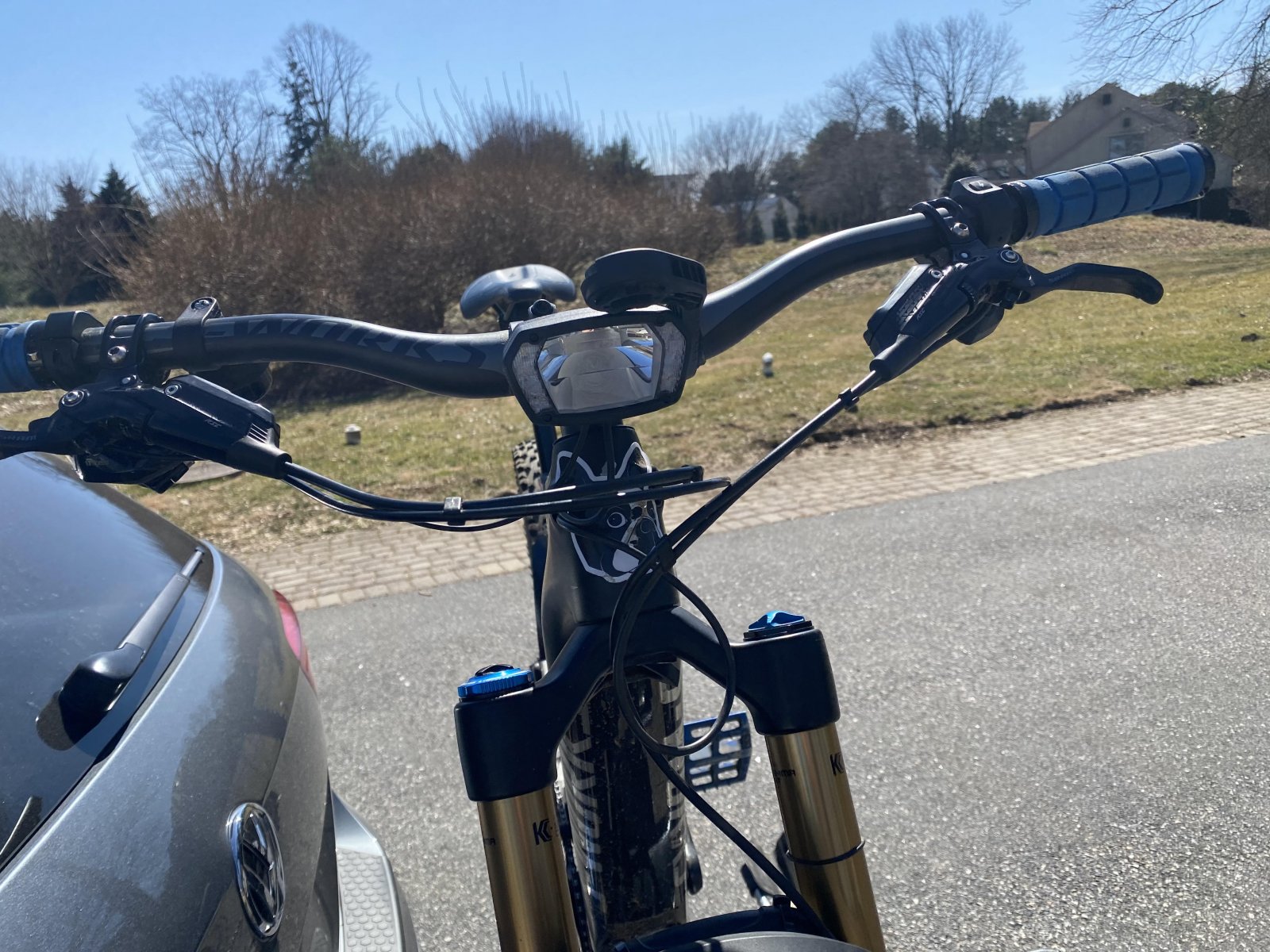

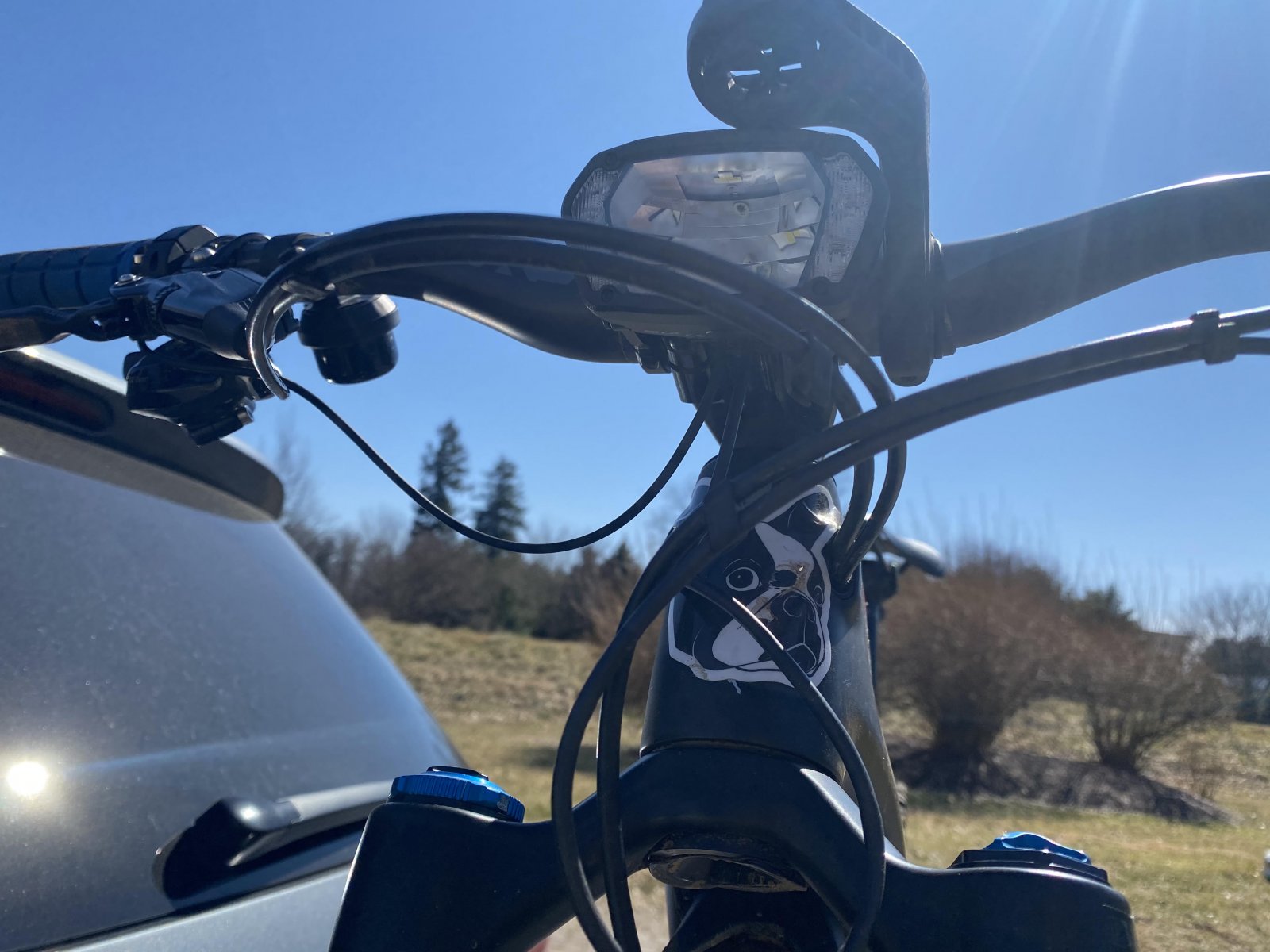

I installed the new Lupine SL X this week and did a ride with it the other night. Unlike previous wired lights, I had zero motor failures, which is a HUGE improvement. Also, the light is exponentially brighter at 1800 Lumens than the previous models. If you night ride, this is the absolute best choice out there for a hard wired light system!

That's impressive, where'd you buy from? Did it come with the necessary cables?
Cheers
It comes with everything including the cables. It has mounting hardware, you need to specify handlebar size, and the remote and power cable are hard wired. I purchased it directly from Lupine NA... at www.lupinenorthamerica.com They are great folks and their customer service is excellent. Basically all you need to do is run the cable through the frame, to the motor and plug it in. I have a 2020 Levo Sworks and the only thing that I needed to do was drill out the wire sleeve where it goes into the frame as the existing hole is too small for the cable end. There is an input built into the Brose motor that this light plugs into. There is a remote that sits next to the right grip on the bars to control true high low beam, which is different from most lights which are brighter or less bright. This is particularly helpful when riding as I'll kick on low beam when descending and high beam when climbing...

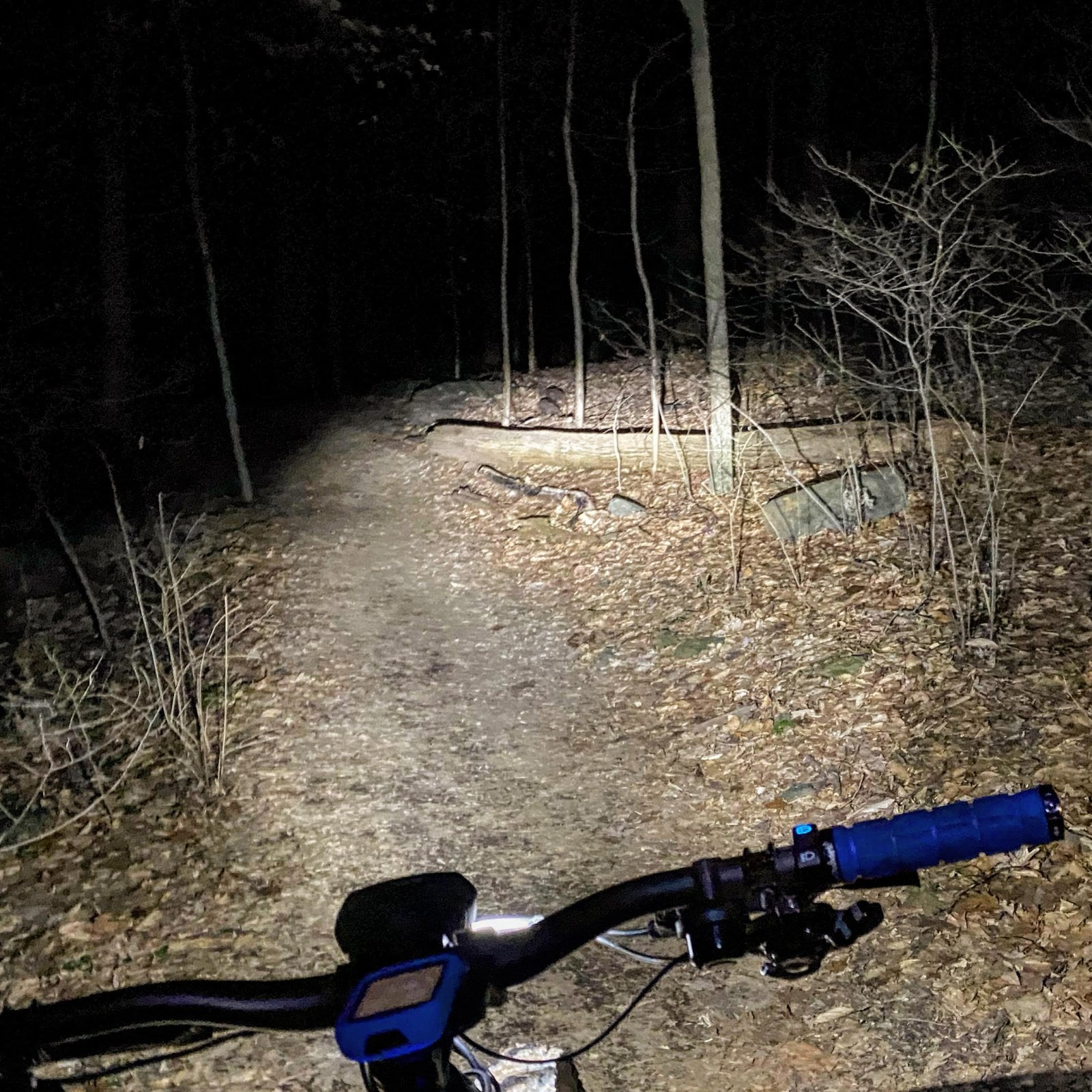

I've used mine for three years and love it.... I also run a helmet light, that's your perfect combination.

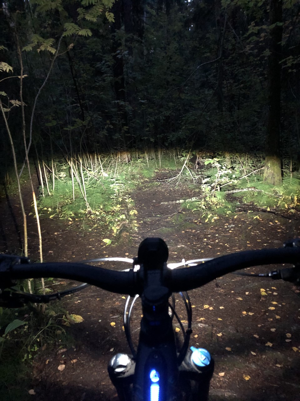

I just installed Lupine SL F to my Turbo Levo and have to say that I'm really happy with it! Picture is from first test ride when I didn't put my helmet light on, but I rode it yesterday with my Exposure Sirius on my helmet and it's perfect compo!
