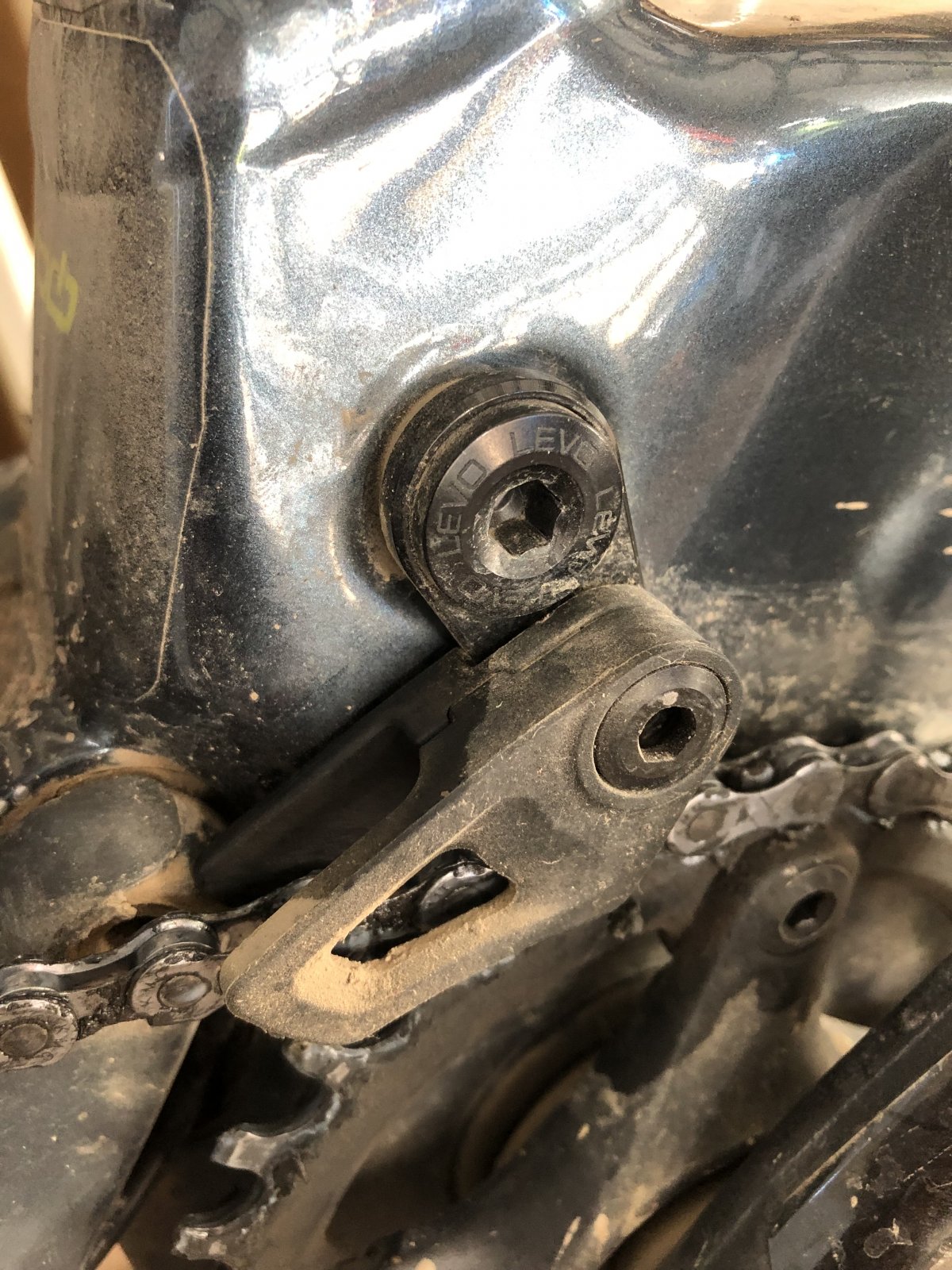

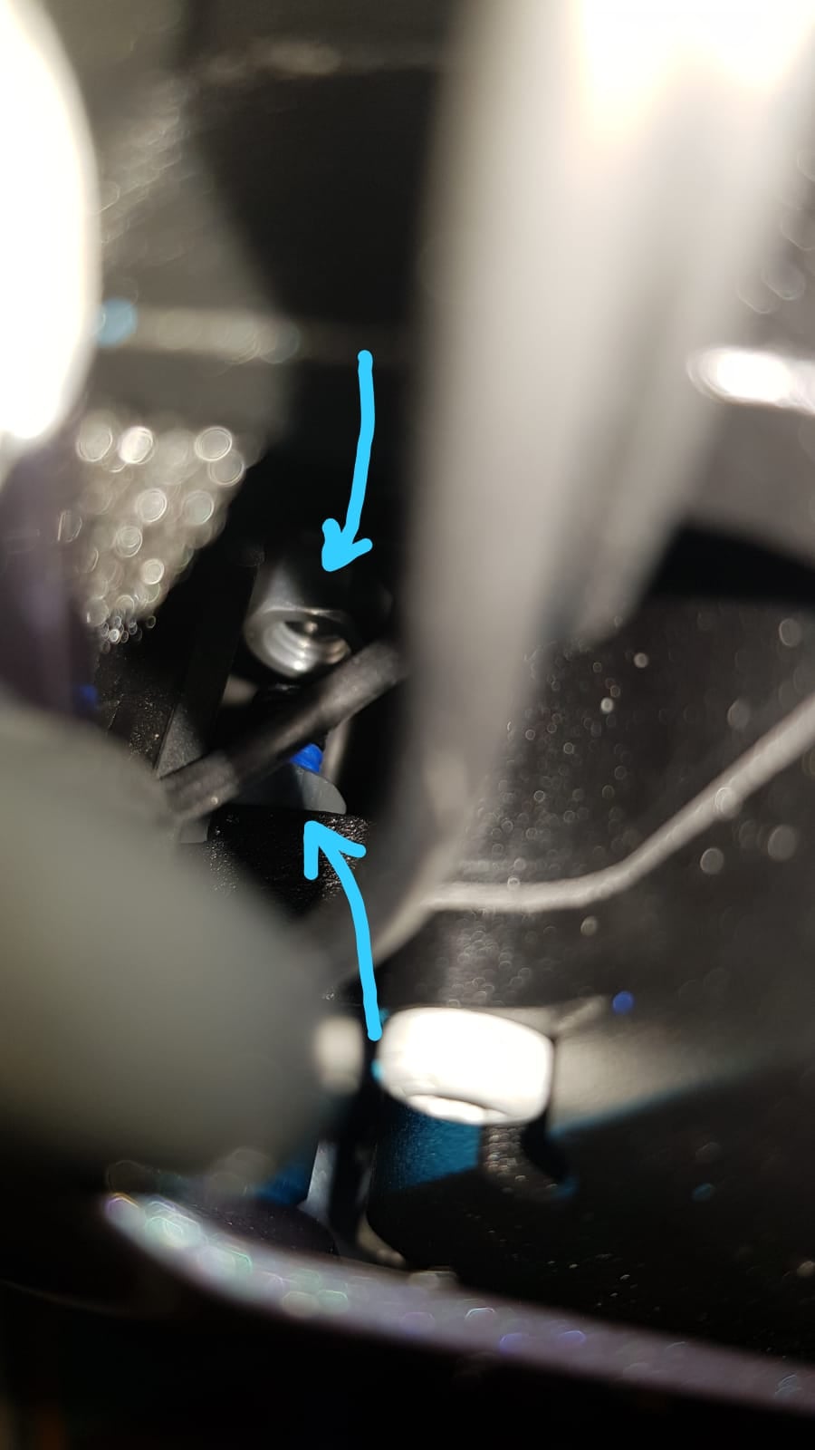

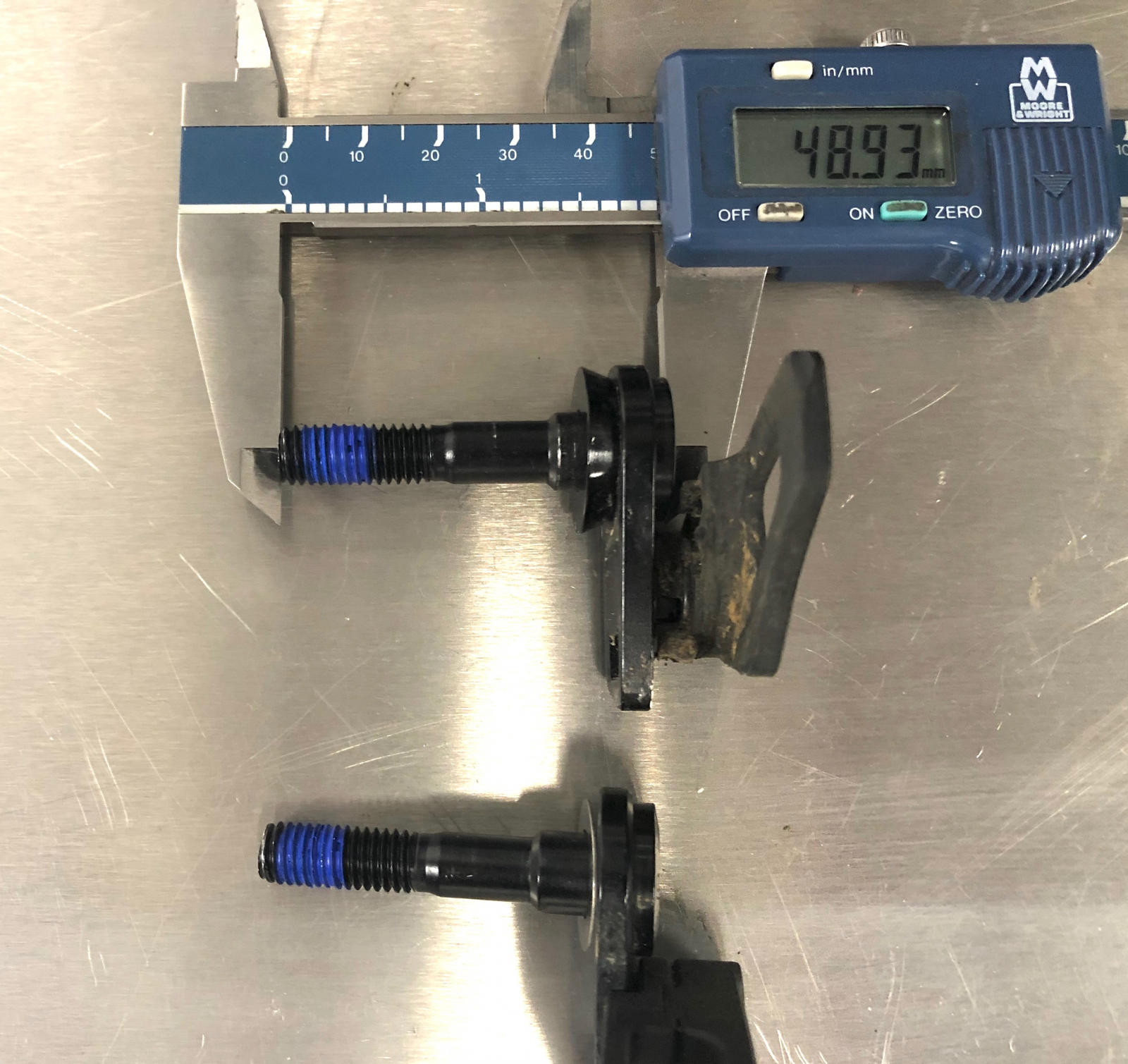

1. motor botls - my main concern, as the shop claims to removed and reinstall the motor to install the brakes. one of the 2 rear bolts that hold the motor does not seem to have enough threads into the nut. bolt on the other side seems to protrude too much. is this normal?

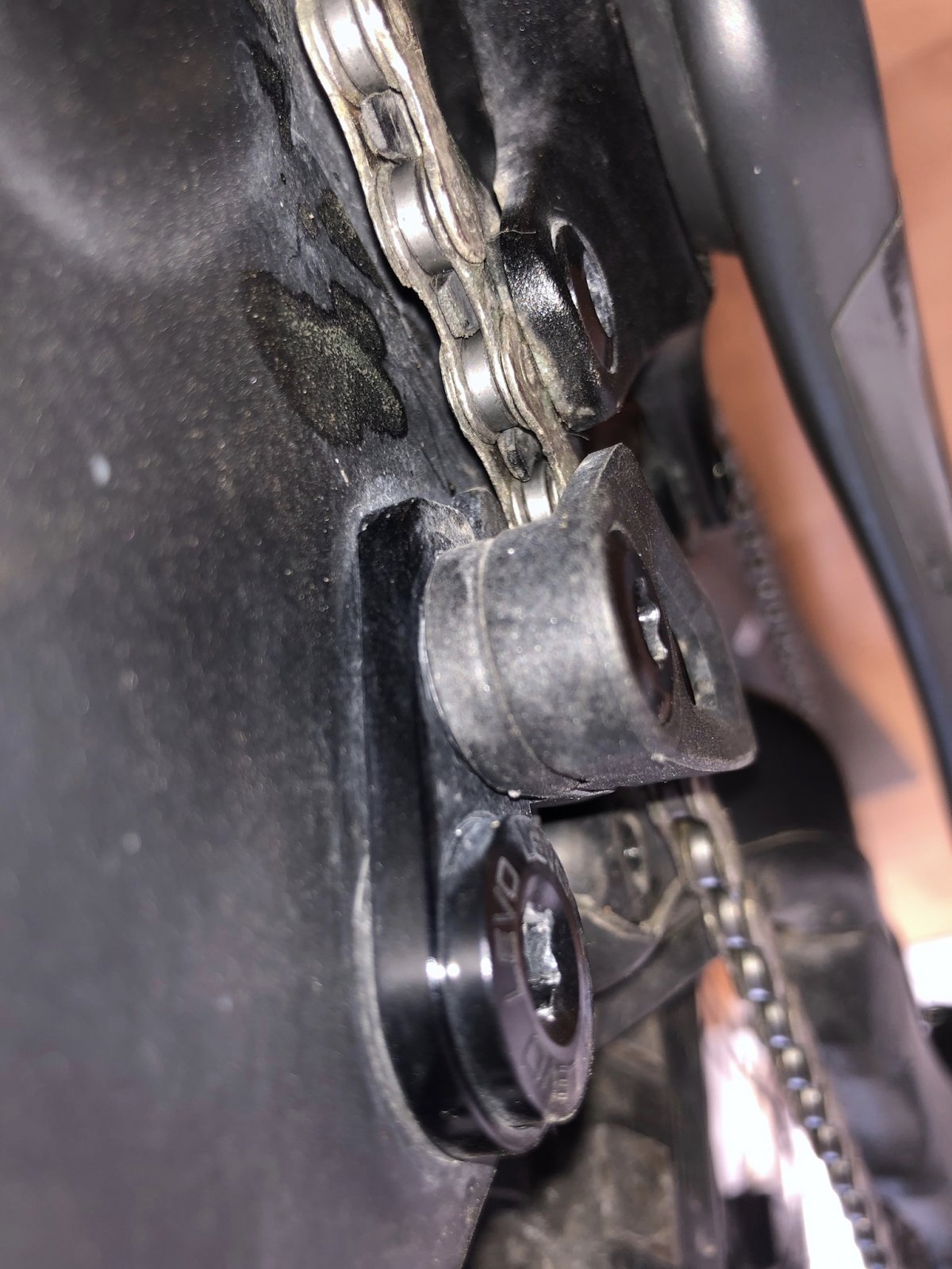

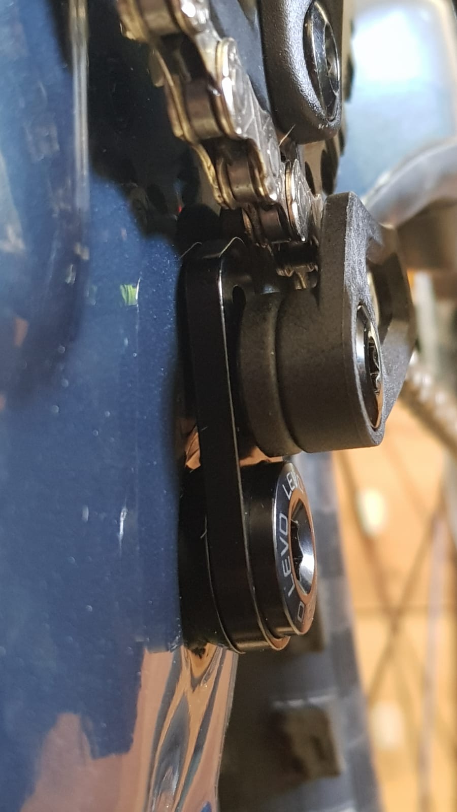

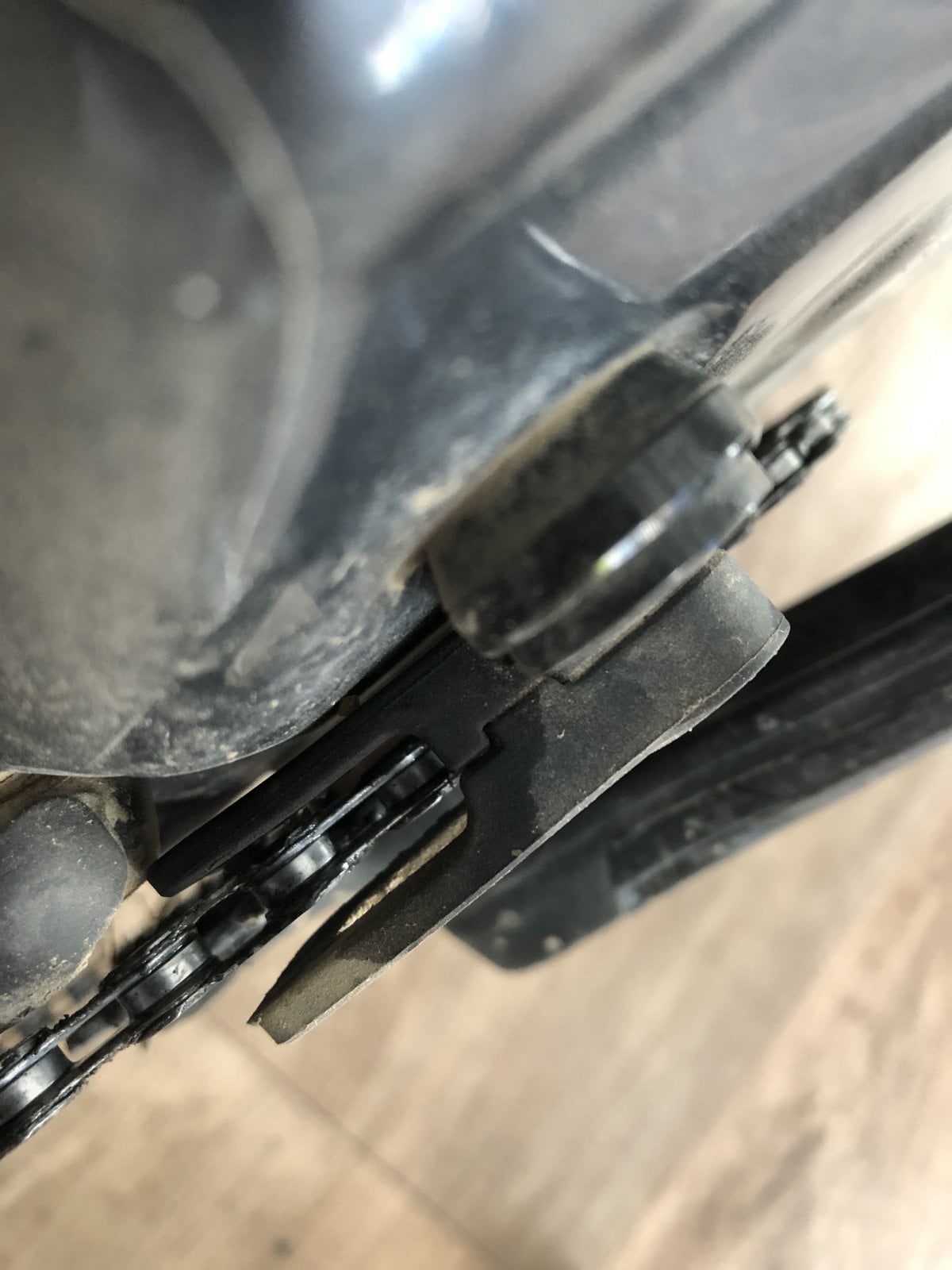

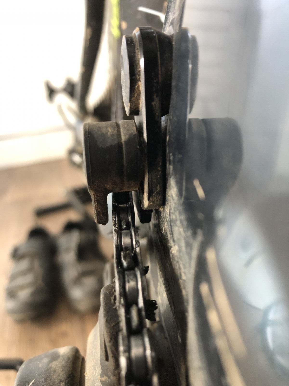

2. the under-threaded bolt above, goes through the chain guide. looking at it shows it is not installed in parallel to the frame, but rather diagonal. it is literally touching the frame at the lower end. is this normal?
the 2 issues together makes me believe the whole motor was just mounted wrong.
couldn't find info on whether this bolt is supposed to be longer because of the chain guide.

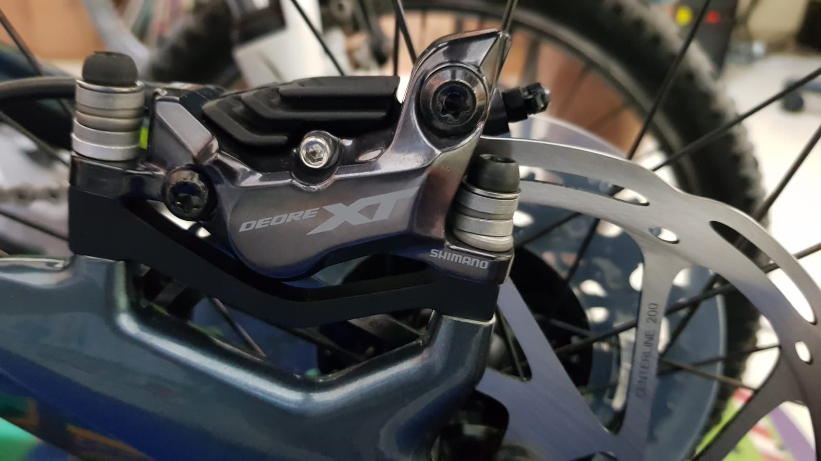

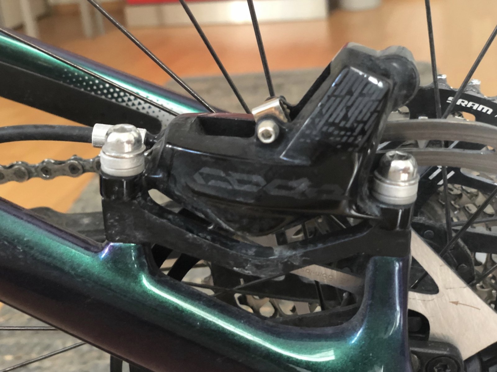

3. brakes mount bolts - the shop left the original sram hardware and bolts are too long and uses the self-aligning washers. seems improper to me. it it safe to go that way? or must i insist on shorter bolts to fit proper length of the caliper? (pads are aligned properly to the disc).
Looks like somebody who just doesn't know what they are doing has fitted this rear caliper.
The bolts are the correct length but 1 pair of the dished spacers should be above and 1 pair below each caliper bolt mounting point, then the adaptor on frame. This is so the caliper doesn't move too much when the bolts are tightened and stays aligned with the rotor. They've all been just put on one side now.
But looking at it now... the caliper will be too low and rubbing the rotor?
Photo shows it correct on my bike.
I would just give the shop a call and complain!

-on my (carbon) Levo there is only one set of shims on the caliper:
-the chain guard lines up with the motor-housing:

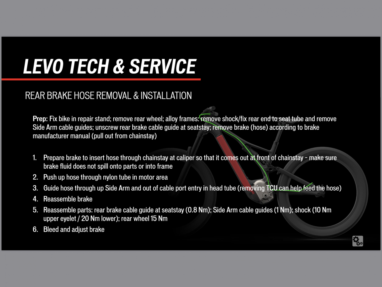

It is absolutely unneccessary to take off the motor for changing the brake-hoses.
See retailer workbook page 123 and following:
2019 Specialized Turbo Levo FSR Tech Service Retailer Workbook - EMTB Forums
There is a nylon tube which guides the brake-hose along the motor!

Looks like your chain guide arm (metal piece that is held by motor bolt) is flush and in full contact with the frame. Mine is spaced out by a washer.
Caliper bolts - obviously they were too lazy to replace anything. I will have that sorted out.

Please - can anyone confirm length of motor bolts into the nuts?
(requires opening non-drive side

Dont be such a snowflake...
The only thing they did wrong, was installing the motor screws wrong...
If you swap calipers, it looks mostly like the didi it wrong. But thats never a problem, if you have all washers on one side.
Nifty56 wrote a total bullshit (sorry), but you need to allihn the callipers with the rotors.
Depending on what mounting bracket you have, you need to put no washers at all below the caliper. The nicest solution then is to use different bolts, so you dont need to put all washers on the other side. But not all bike shops have all bolts in all lengths in stock...
Now just go for a ride and enjoy the great deore brakes!

- motor - re-installed (why did they even remove it) with one bolt loose and not threaded properly.

brand new levo delivered by local dealer, after brakes exchange to my request.
shop has done amazingly poor job and i am now truly afraid to ride it.
hoping for some help and advise on how bad things are (pics attached):
after spending top money for this bike, i am so frustrated when i see all these issues...

Looks like that bolt is just not in all the way, so it's resulting in both - the nut not being fully on and the chainguide not touching the casing completely like it's shown by @McInner1 's pic.
Have you checked if that bolt is loose?

Hi @ridehard. Sorry to hear that your first impressions of the Levo following an LBS brake upgrade haven't been good - such a shame. To answer your motor-bolt questions,
- the Chain-guide bolt itself should be just under 50mm long when you remove it (see picture below, the chain guide is broken in this picture but it is what I had to hand. The keen eyed among you all will also notice that the washer fell off and I put it back on the bolt the wrong way around :rolleyes:).
- on your Alloy-frame there IS a tapered plastic-washer between the frame and chain-guide, this is normal
- On the thicker carbon frame that @McInner1 showed in the post above, we use the same bolt and guide but with a thin metal washer - also shown on the picture below for reference)
- it's possible that the retailer may have incorrectly used one of the shorter two bolts on the chain guide - see the image below and compare bolts DD with EE.
Although we'd always advise you to go back to the retailer and get them to check and correct, if this is not possible you can check the bolt positions and re-torque to 18Nm.
Trust this helps! SRC

@silverstone - it's all good, and I Always take internet "truths" with the right proportions.
@Specialized Rider Care - thank you for that. I am pretty sure a shorter bolt is installed there. I didn't take it out to measure as I was already threatened that my "self mechanicing" will void the warranty (God knows why, they don't allow you to do anything yourself here..) so I had to stop.
Just to clarify "plastic tapered washer" - i. e. one of its radiuses (frame side) is larger than the other (chain guide side) right?
But both faces are parallel and should make the chain guide parallel to the frame?

My picture shows the washer the wrong way around - sorry about that. Yes, both faces are parallel but the smaller side touches the frame - so your bike IS built correctly from that perspective. It's just the bolt length you or your retailer needs to check.
ridehard
Aug 20, 2019
90
63
Israel
Hope this helps... (sorry not washed the bike after last ride)
Here you see the washer in the correct position on the alu frame. Also you will see a minor gap between the chain guide and the frame.
View attachment 18025 View attachment 18026
thanks.
can you look at the vertical arm (metal) to see if it parallel to the frame as well? (lower part of the frame, outside of the bolt's recess).
hope to get mine as dirty as yours soon :LOL::LOL:

thanks.
I think you were searching for a picture from this angle?
Hope your bike is quickly fixed and you can start enjoying it.

That caliper has been installed with sram hardware, presumably what was on the bike originally, not shimano hardware for the new brakes.
Depending on the bracket size, shimano may not use any domed washers, or may use a single set between the caliper and bolt head. If the shop had fitted the caliper as shown in @Nifty 56 's picture, the pads wouldn't be located correctly on the rotor.
It's ugly, but not the end of the world. Buy a shimano mounting bracket and it will come with the correct bolts.

Have never seen such a crappy job done by any bike shop.
First up - the brakes. To me it looks like they have tried to reuse the SRAM spacer bracket instead of one designed for Shimano brakes. Just looked at 3 different bikes with Shimano brakes and they all have a single thick washer that is ABOVE the brake and the brake sits directly on the spacer bracket.
As far as the motor bolts go - they have used them in the wrong place. There is ALWAYS enough thread on the bolt to go through the nut and usually 1/2-1 turn through.
My caliper is fitted as it came originally and everything lines up perfect. I hate the cup washers but they serve a purpose, if used correctly.
My front brake is more fiddly because it's on an angle with the mounting bracket.
That's because yours is a sram caliper. The OP has a shimano caliper with sram hardware.

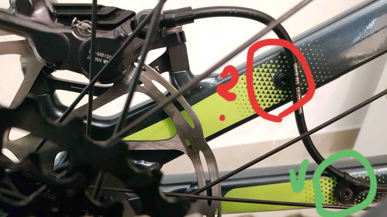

update and some more issues...
- got the bike back from the shop. all previous issues seems to been taken care of - calipers now properly installed, cables and hoses neat and tidy, motor removed and reinstalled - properly. BLISS. :)
took the bike home to set it up for weekend rides, to find more problems:
- shimano BR8120 lever clamp apparently needs a new type of matchmaker adapter to install a sram shifter. the one installed doesn't fit properly, can't be tightened, and brake lever touches the shifter body. new part needed.
- the revelation fork does not seem to extend back to its neutral position but stays compressed to the 10% mark under no pressure/force. exposed stanchion length is 140mm and not 150mm.
i've read it has something to do with negative pressure chamber, fork "reversing". can this be remedied at home?
- rear brake line - are there suppose to be 2 clips to hold the hose in place? i only have one, the upper one is a bolt located tight to the hose, where i believe a hose clip is required. can anyone confirm? (right now that bolt will only damage the hose rubbing it)

I hate matchmaking - always get the wrong adapter.
Dump all the air in the forks - work them up and down without the valve in to check full movement. RTFM and follow procedure for pressuring back up. Differs, but say 1/3 pressure - pump up and down - 2/3 pressure - up & down - adjust for weight seems to work.
Yes - will damage the hose - needs a clip.
