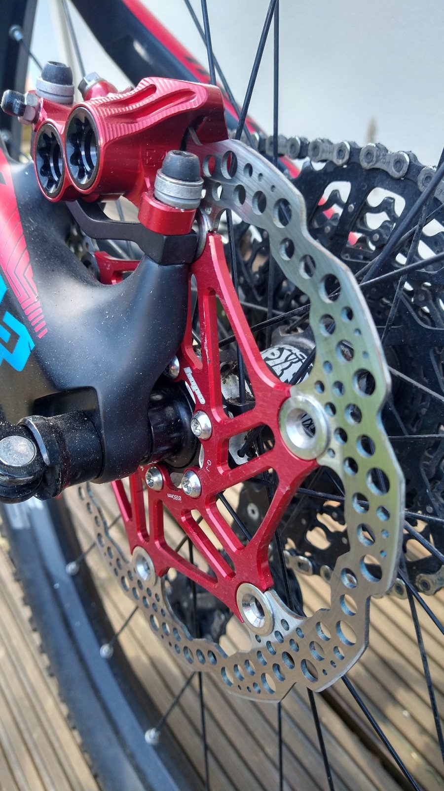

Looks sweet, whats the performance like?
well i can only compare against code r, mt420's and tech 3 e4's and they're better than them - the first few millimetre of pull feels almost spongy, then the power comes on, smoothly but with force, and there's not much effort needed pulling on the lever to generate the power. Adjustability is good but if you've run hopes before that is to be expected.
These are tech 4 e4 (not v4) with 203 rotors and they seem to have plenty of stopping power for a heavy ebike, if you've run tech 3's before i'd say these are significantly better.

Fitted a set to a mates bike the other weekend.
Lovely looking kit.
I would say for brute stopping power they don't seem to be any more powerful than others BUT the modulation compared to my XT's is amazing. You can really feel the bite point and I felt a lot more in control with them.
