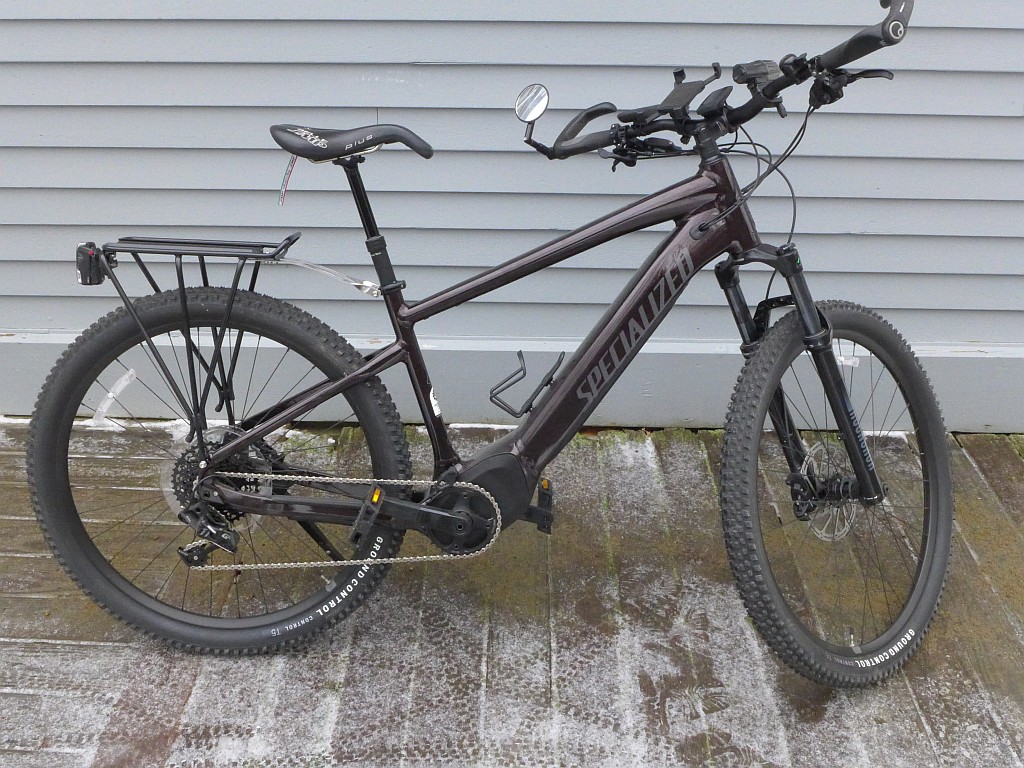

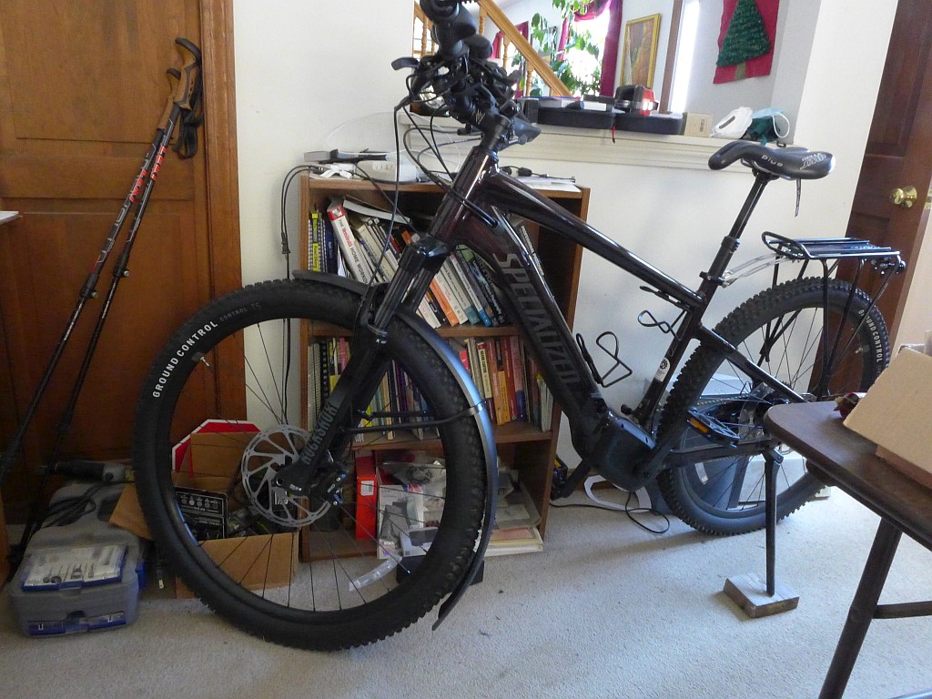

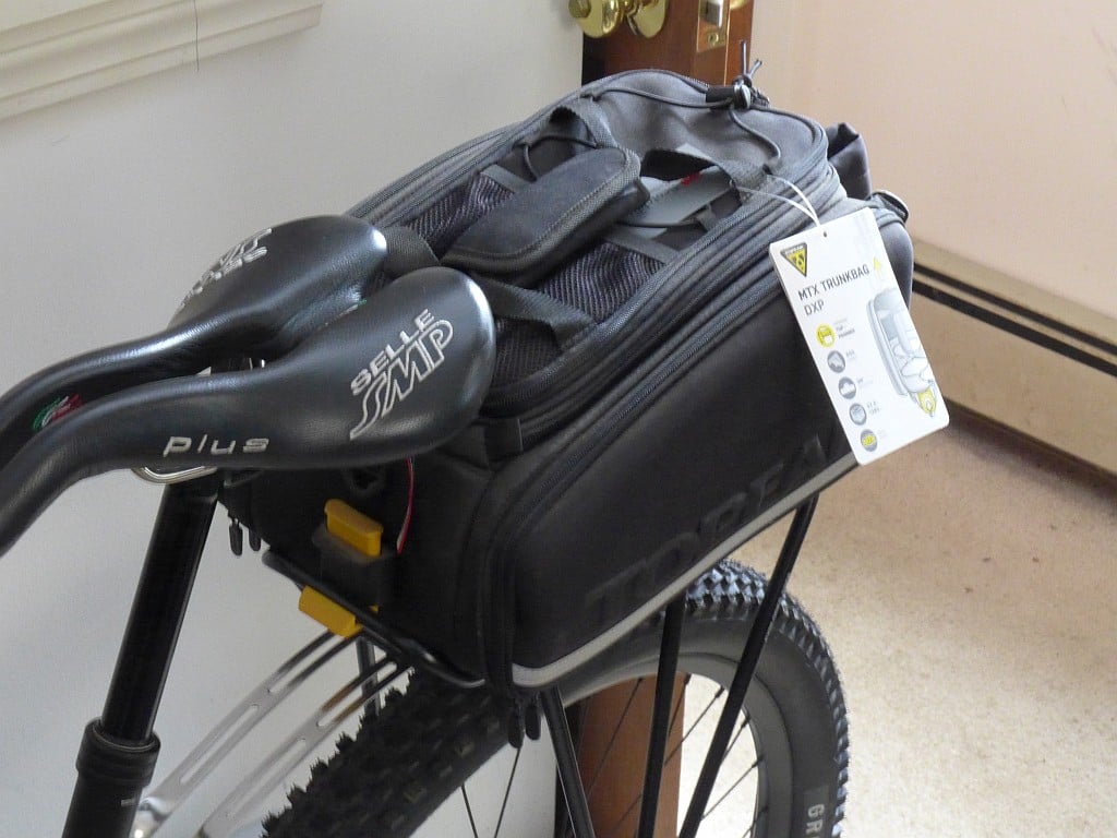

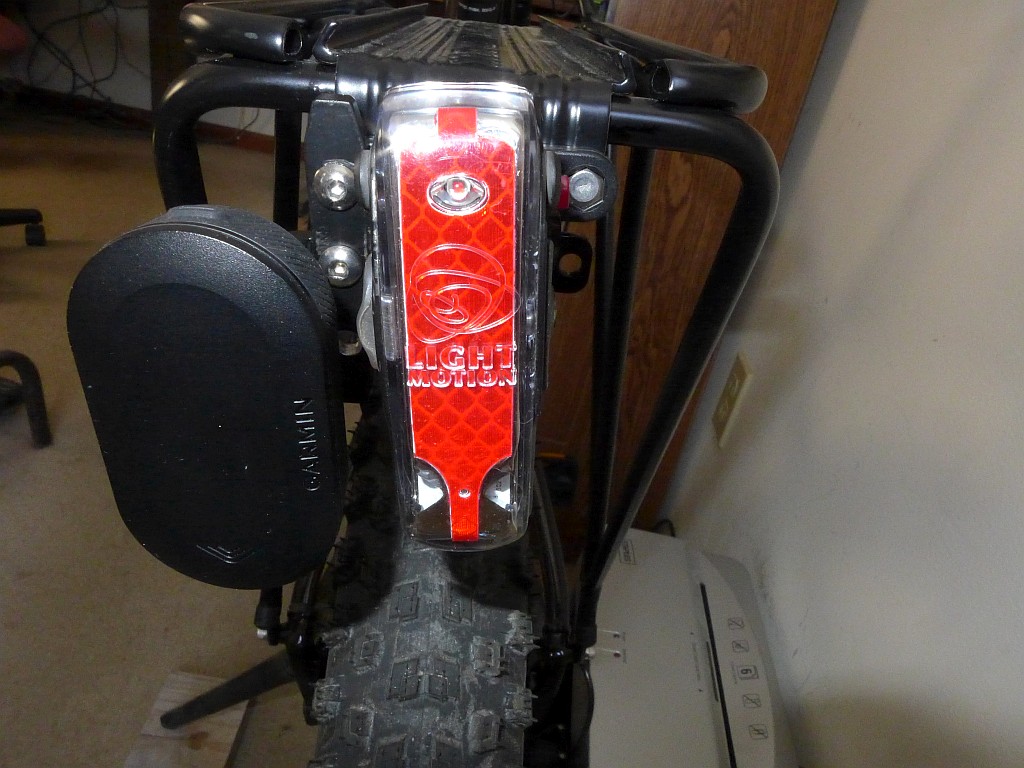

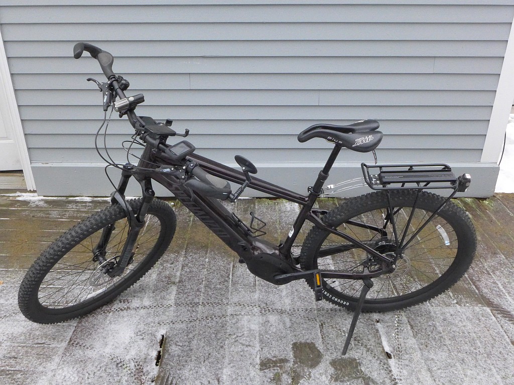

Some images of the bike are as follows. Left Side View of  Tero P1010426.jpg Right Side View of Tero P1010428.jpg Seat and Topeak MTX Trunkbag DXP on Tero P1010431.jpg Varia RVR315 and Light & Motion Vis180PRO mounted to bike rack P1010439.jpg Specialized Tero Front Fender P1010435.jpg
