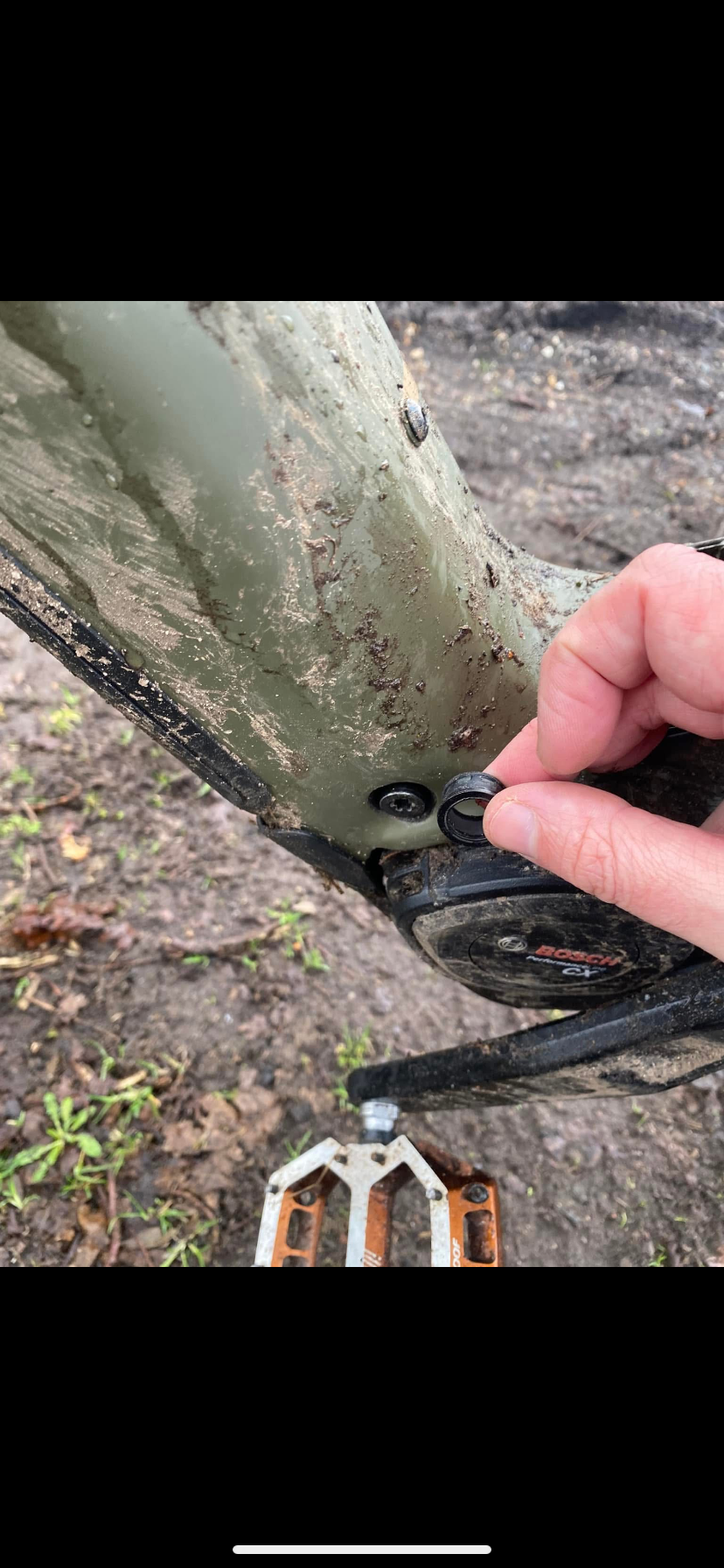

Hi Anyone had issues with the seal/ bush falling out of the new gen 5 CX motor?
They are fixed in with the new two bolt system and no body even seems to know the correct torque for T40 bolts.

They changed the design of that bushing, you have an early one. Call your dealer and get the new bushing and problem solved.
Ok cool thanks will message them is it just a dust seal and is it necessary to take the bolt out to replace?
Boogz83
Feb 19, 2025
18
Uk
Check my answer to same issue in the Vala thread: Santa Cruz Vala
Thanks that’s exactly my issues! I wonder if they were never pushed in fully from the factory? I’ve just refitted my old one for now but will try and get some new ones asap.
Funny though I finished my ride without the bush and it was silent with no issues at all for 20 miles. Makes me wonder if it is more of a dust seal than a structural mount?
What did you torque the bolts up to?
