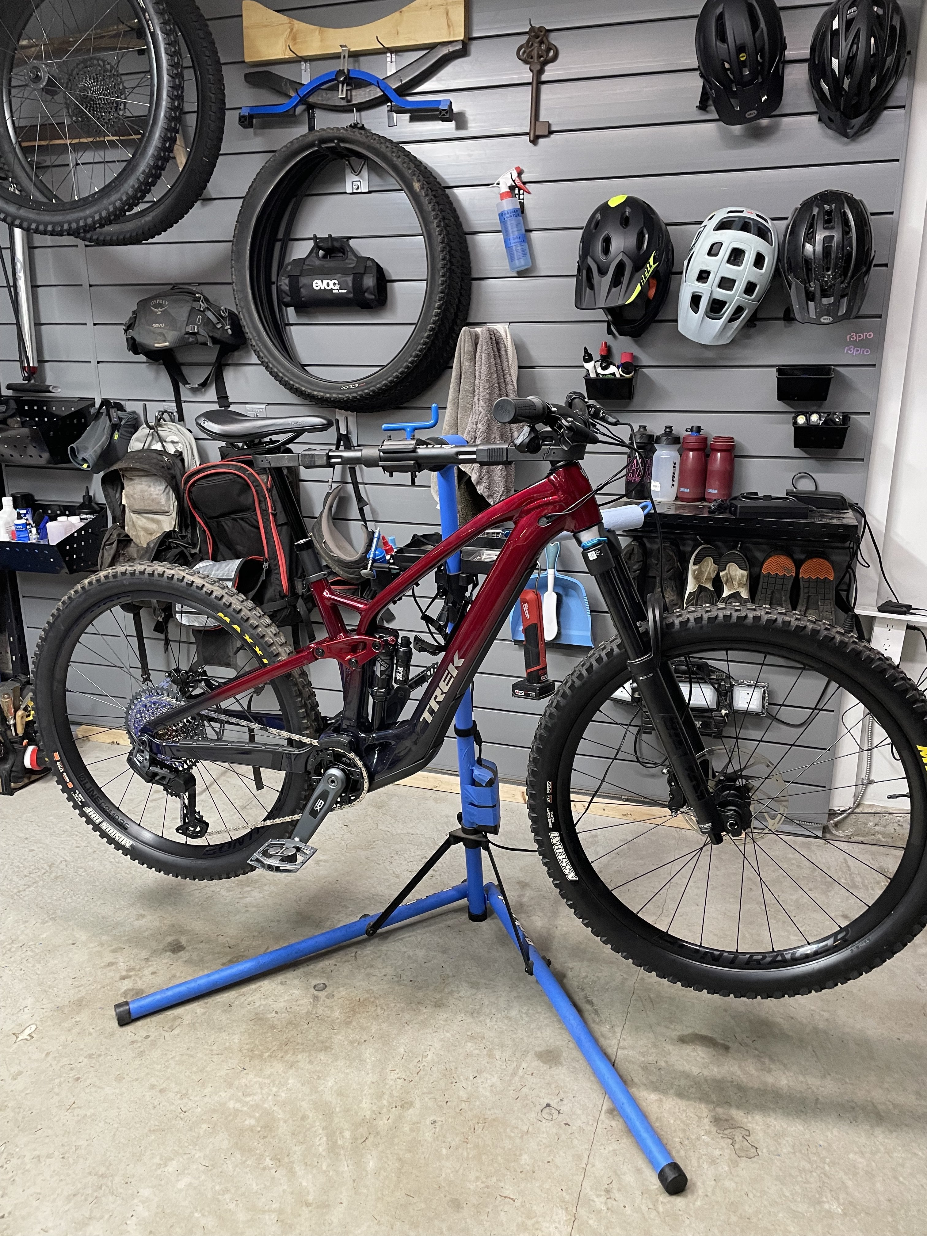

Well this is gonna be different. Have a Trek Rail 9.7 and sold the Powerfly HT to one of my kids. I stripped a few upgrades off the HT before my kid stole it.
I installed those things onto the new Fuel EXE.
Added the tires, seat, grips, bar, peddles to keep the feel similar to the Rail without losing that new bike smell. Ride Wrap arrives tomorrow so a test ride will wait until the rain stops.
What’s that you say? Future upgrades?
Magura MT7’s, Raceface ERA 160mm cranks, AXS Reverb dropper, Wheels (still deciding).

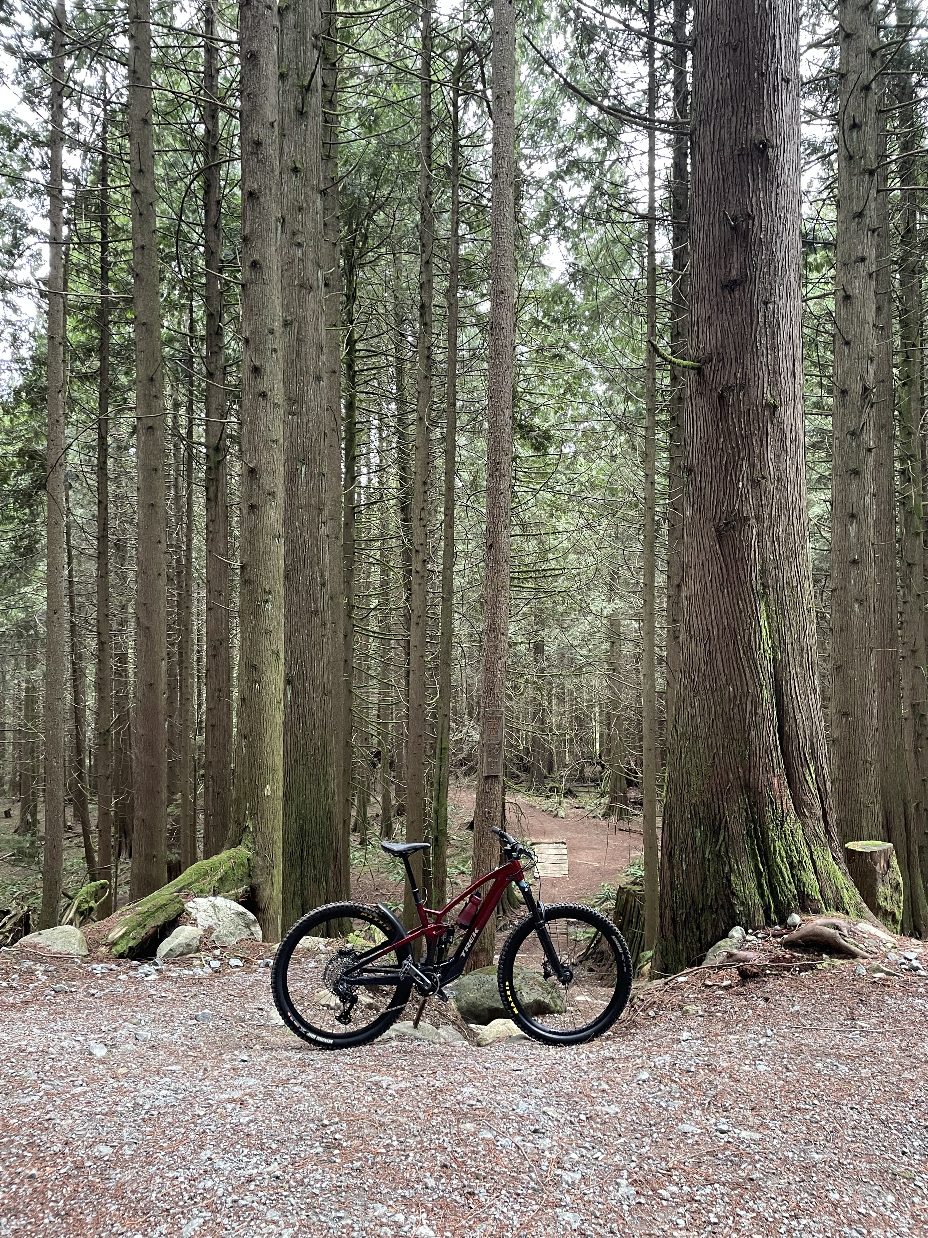

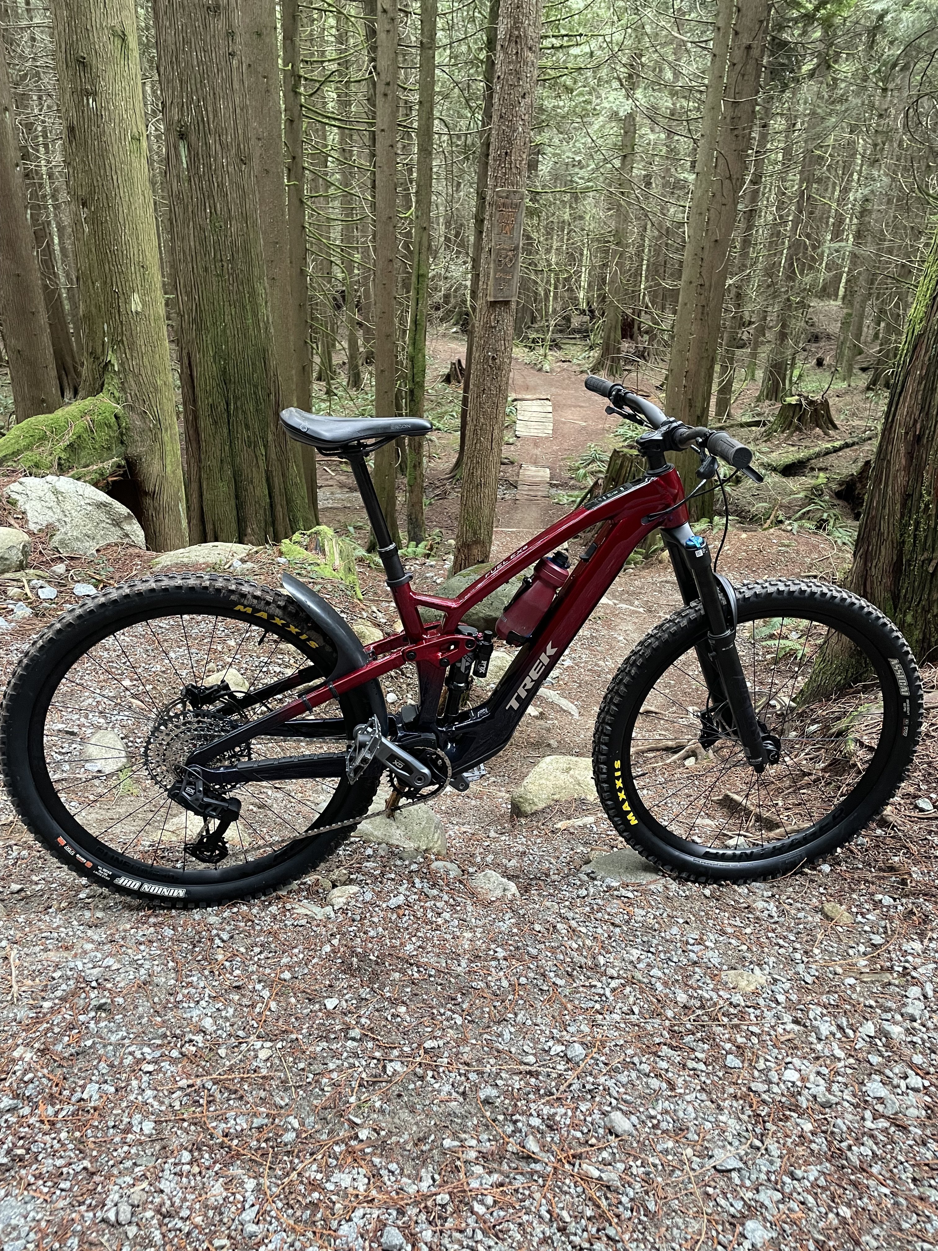

First (real) Ride with the Fuel EXE.
The Climb.
I can usually ride to the entrance of our trails on Burke Mountain in about three minutes. This new bike took me 5+ minutes. The power was underwhelming …but I hadn’t setup the assist modes yet (eco, medium, high.) I continued the climb anyways and I’d make some adjustments to the power assist in the app once I reach an upper landing.
Once I reached the landing, motor adjustments were simple. Most levels were low assist or default settings. I changed everything to where I might like it. The assist delay level was too low for my liking …I changed that to 90%. That gave me a faster response …but not a rocket start. It also stopped the jerking motion or studdering feeling while I was under power. A few more rides and I’ll get the sweet spot.
Down Hill.
I dove into several trails after a long uphill ride. Holy Crap! This is not your father’s bike! Two trails and only two dabs. The berms and drops on the other trails were easier and probably faster. I think it was the lighter weight of the bike that allowed me “whip” around corners a little faster.
The brakes are gonna take some getting use to. These aren’t Magura MT7’s. (Soon). The shifting was amazing. Power through it…no clunking …totally smooth. What a quiet bike! I could hear my tires against the pebbles. And the birds are chirping.…and…😉

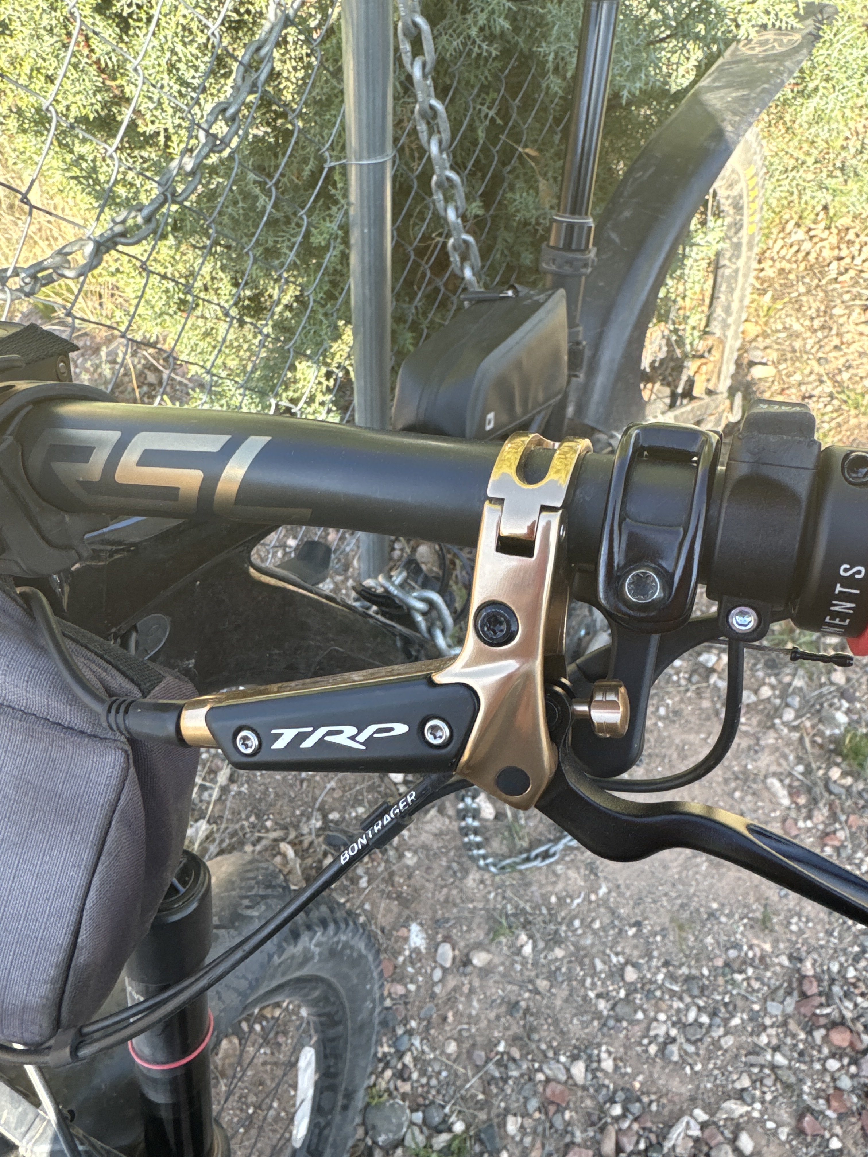

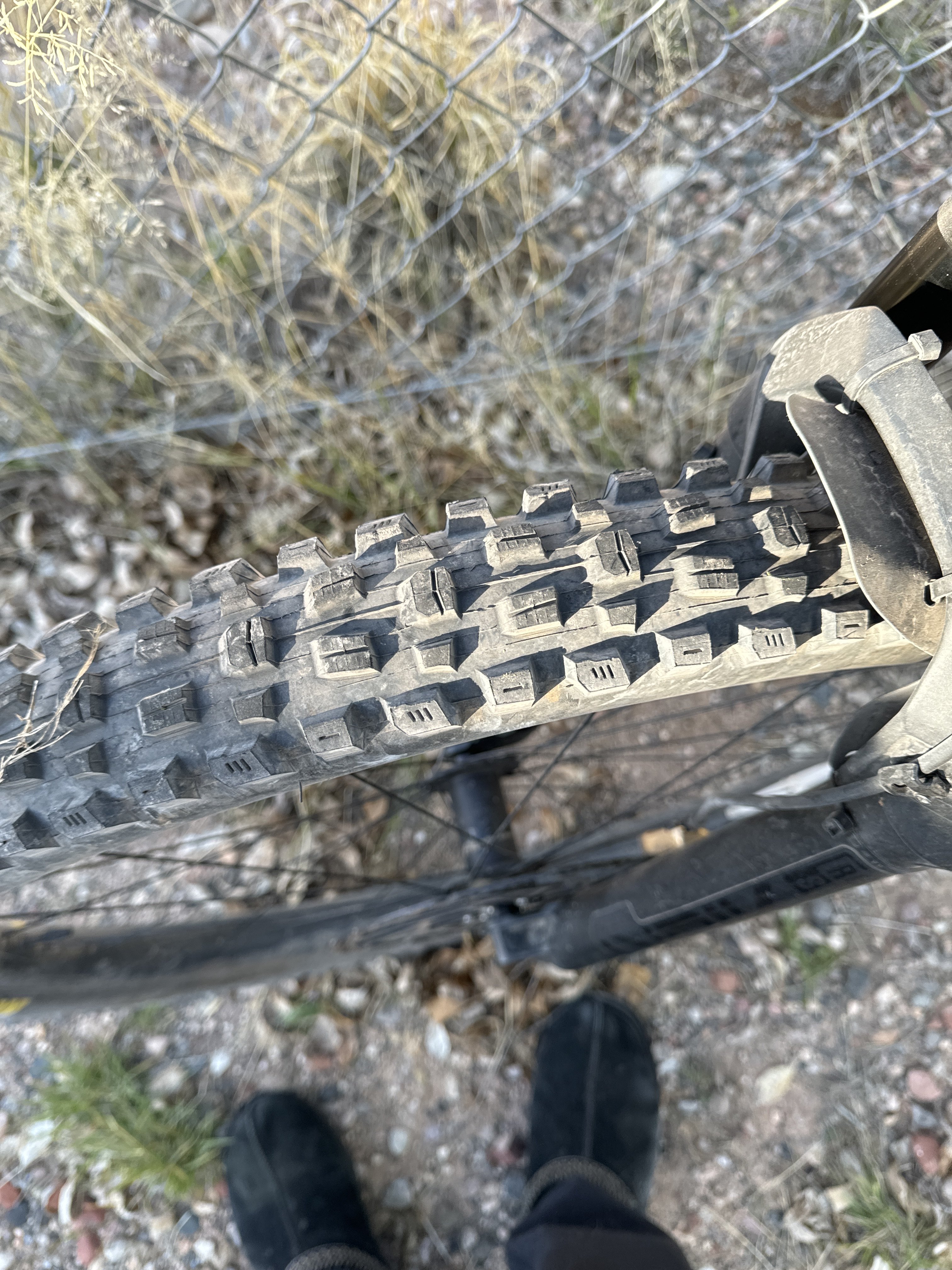

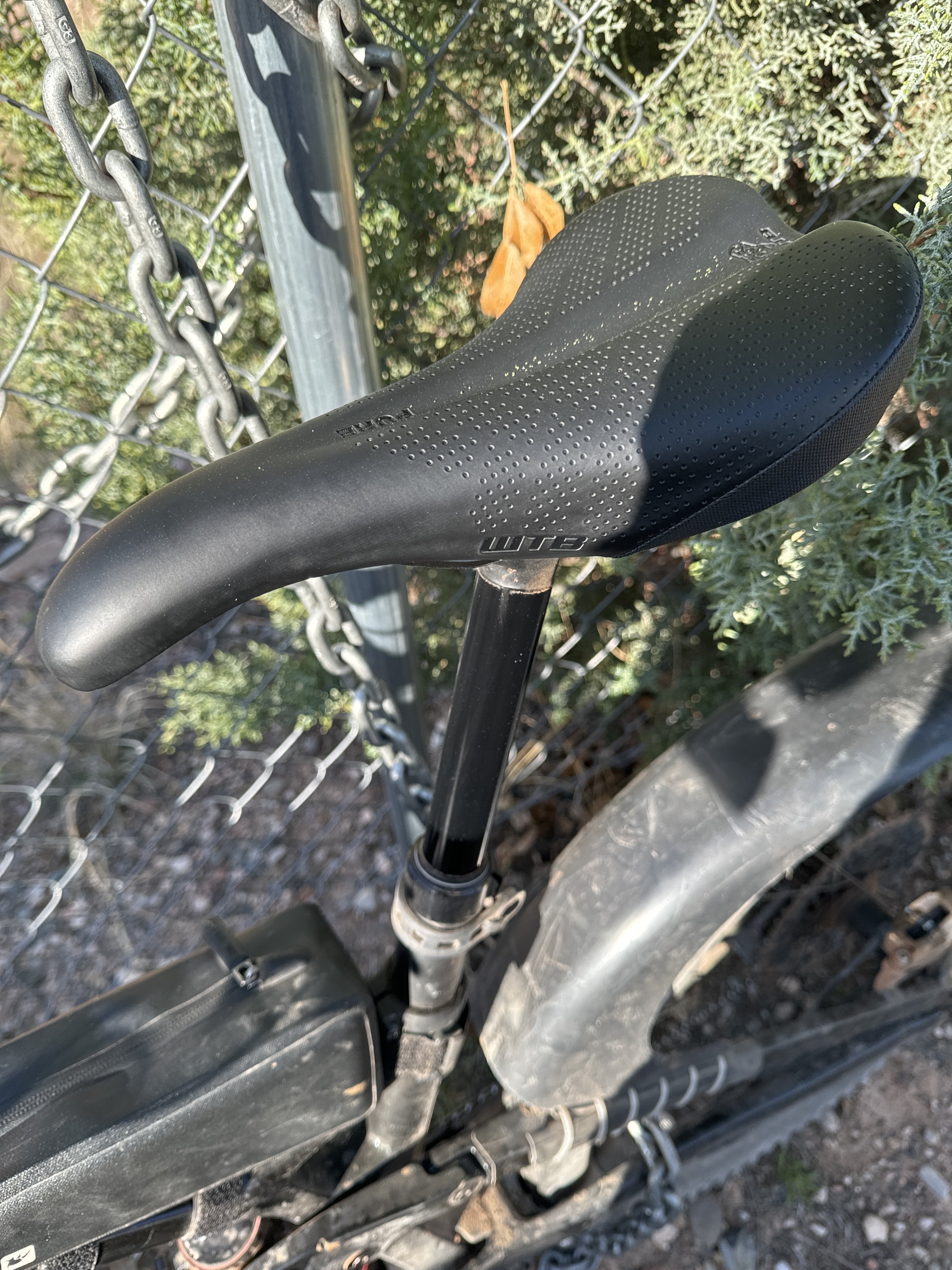

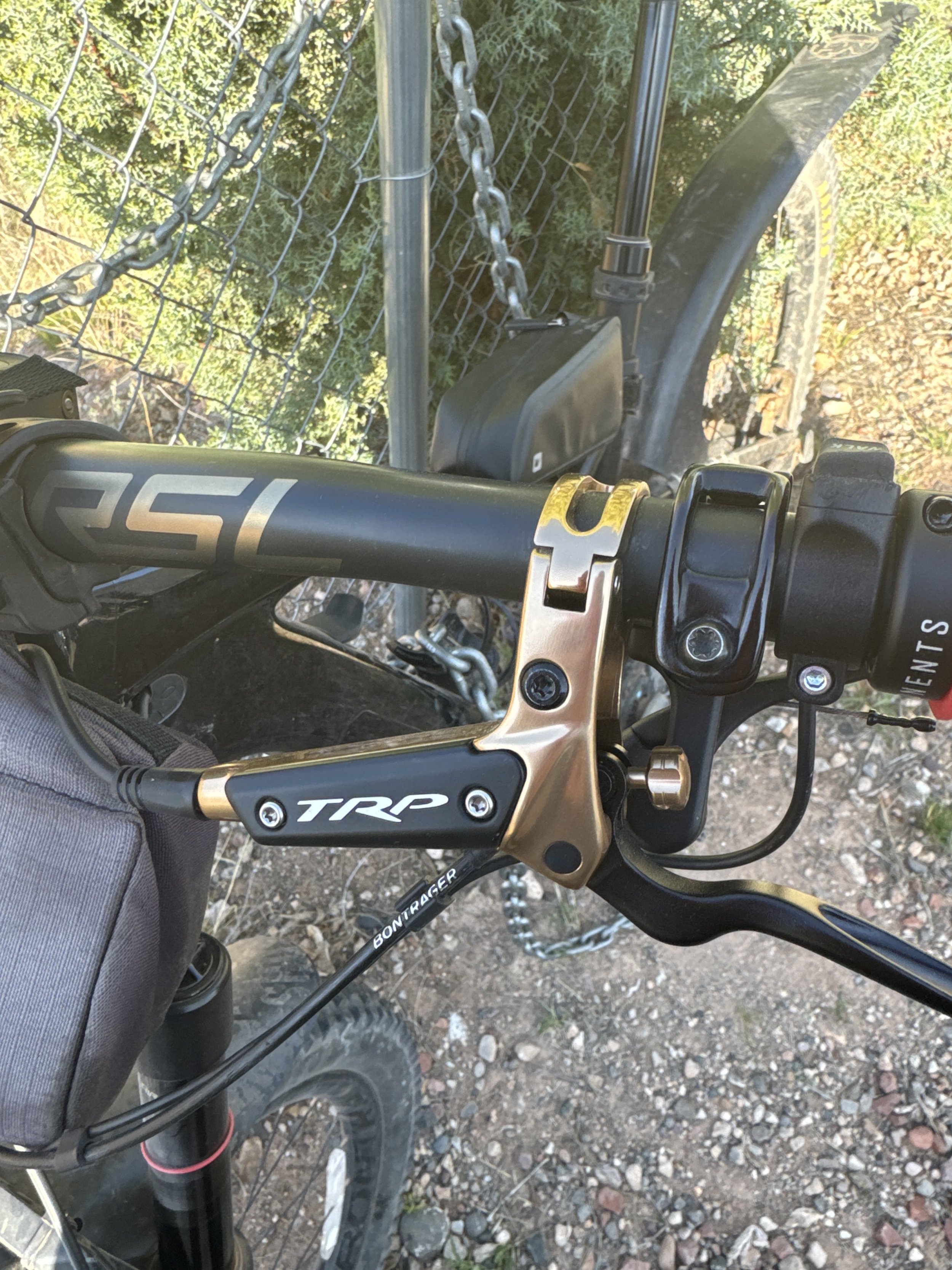

three “upgrades”.
trp evo dh brake set. code r brakes do not have the stopping power
assegai tires with the transitioning knobs are way better for conservative riders who don’t throw the bike into each turn.
the bontrager seat has got to be the most uncomfortable seat i’ve ever owned. this is a cheap $35 wtb pure seat which if you are used to wtb seats is a must.
oh and i switched the air shaft to a 160 mm from 150. might also buy a coil shock at some point.

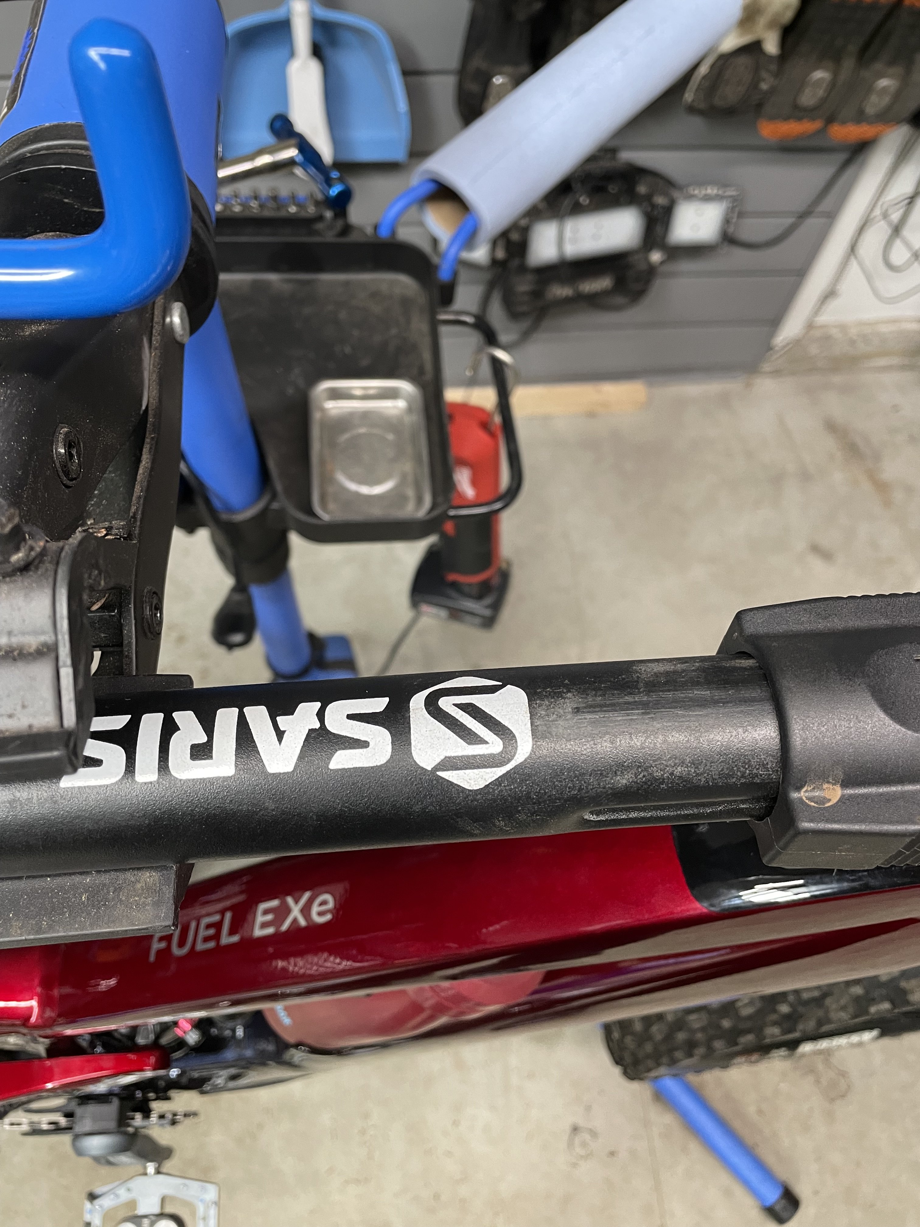

I started using that Saris tube to hang the carbon Rail. After a while it just got easy to mount and made servicing any bike easy.
My bikes now lineup to give it a try. 😉
This bar hangs on the tool shelf when not in use and takes me about 4 seconds to attach.
Be careful with the LCD display on on the EXe when using the Saris. I wasn’t paying attention and cracked the display While loading it onto the repair stand. The Saris is great though. Keeps the bike nice and level and spreads the weight instead of using the seatpost with a heavy bike.
Nice bike. You’ll love the EXe.
I actually never noticed or thought of that. Your right though …it is kinda close.

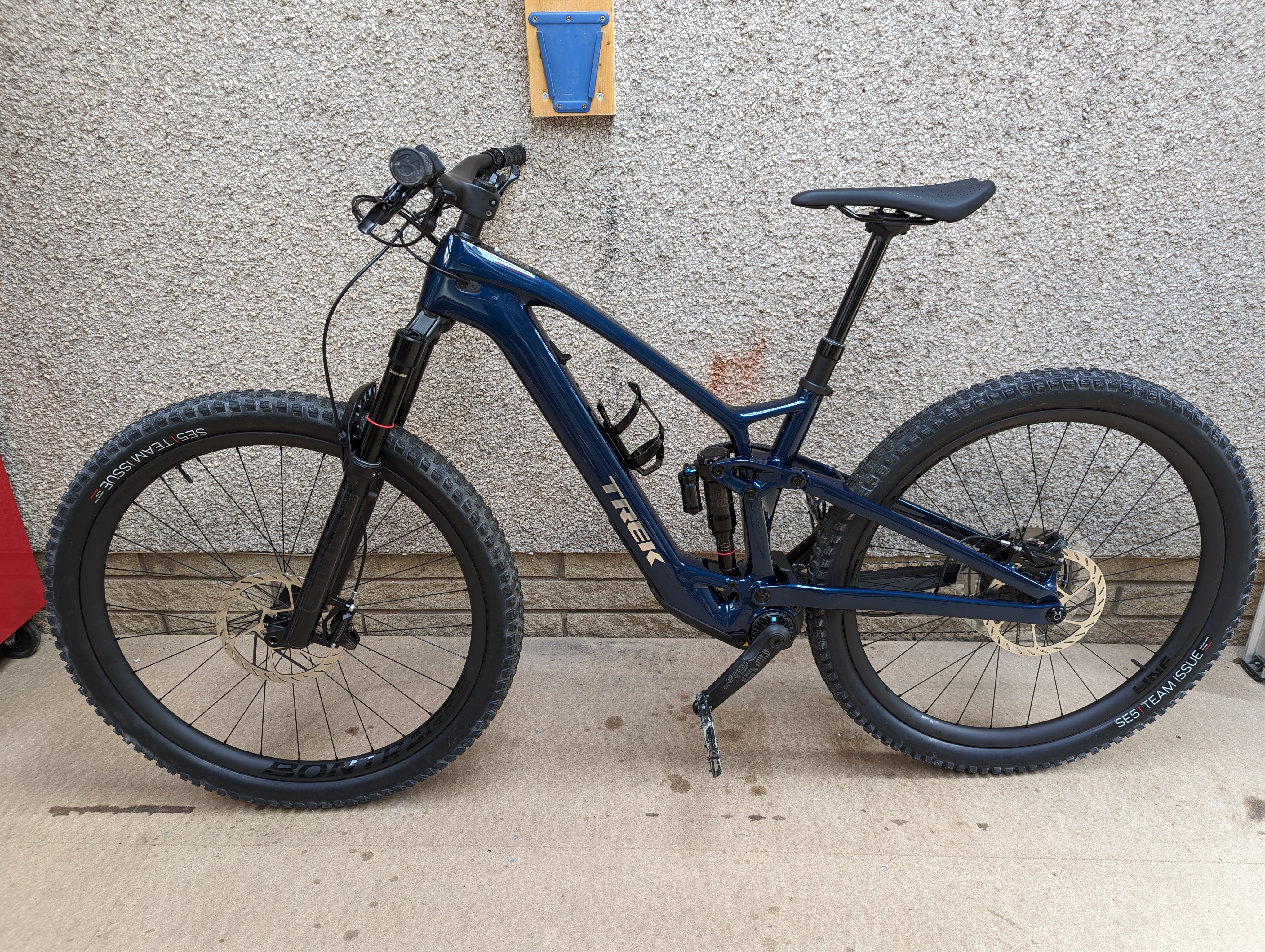

New Bike Day....
Just got my New Fuel EXe 9.8 XT.
Can't wait to ride it. Unfortunately Trek decided to send me Sram Code brakes rather then XT as requested and the cassette was not XT which I find strange as it was the XT spec I ordered.
They have agreed to send XT brakes and cassette out to me but just wondered if anyone else has had a similar issue.
