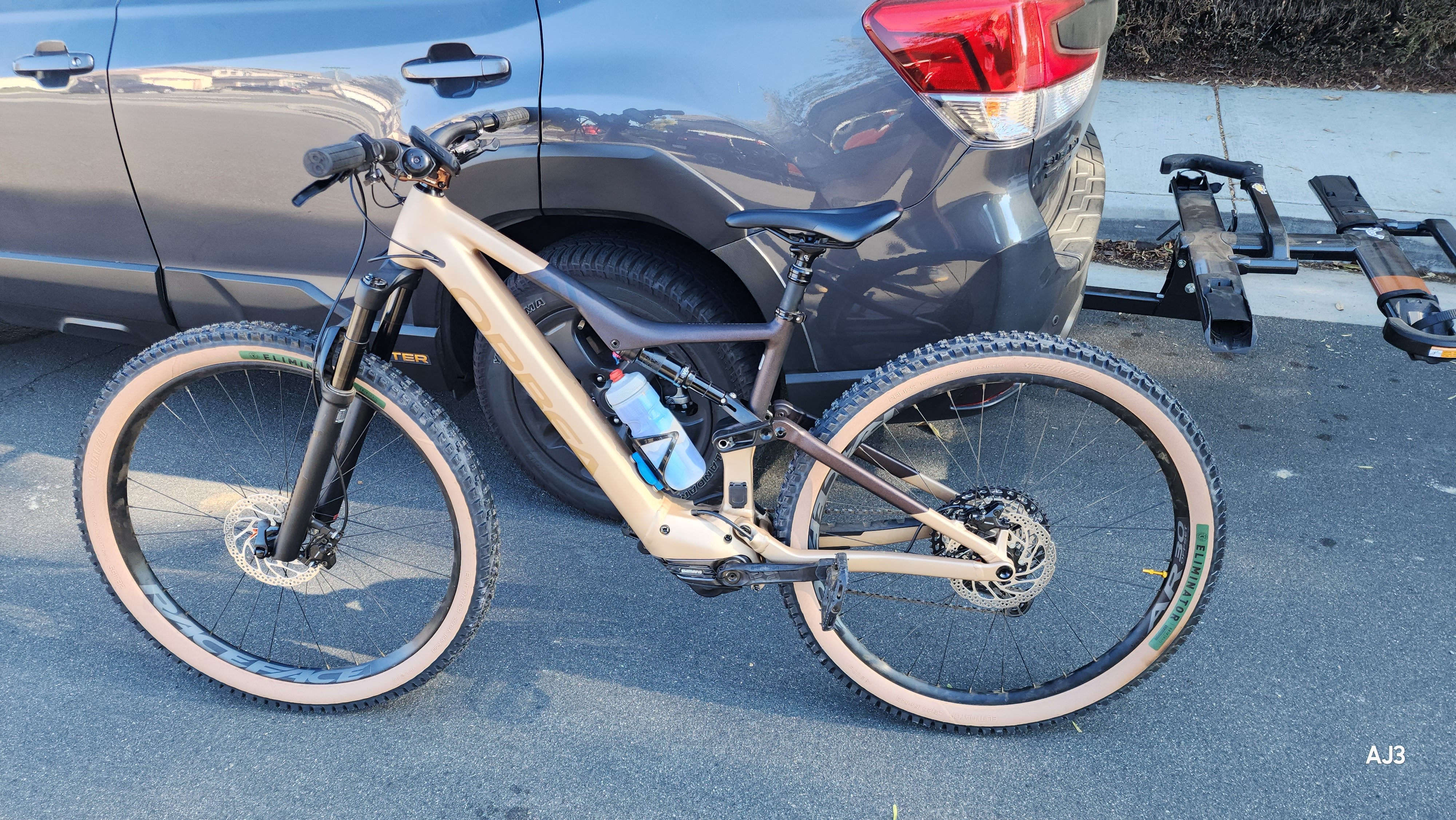

I just got my bike two weeks ago, 22 h30 new color..it has a Shimano FH-MT510-B rear hub... hopefully this is a little more durable since the supply issue has been mostly resolved.
