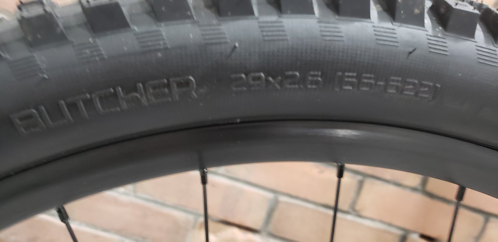

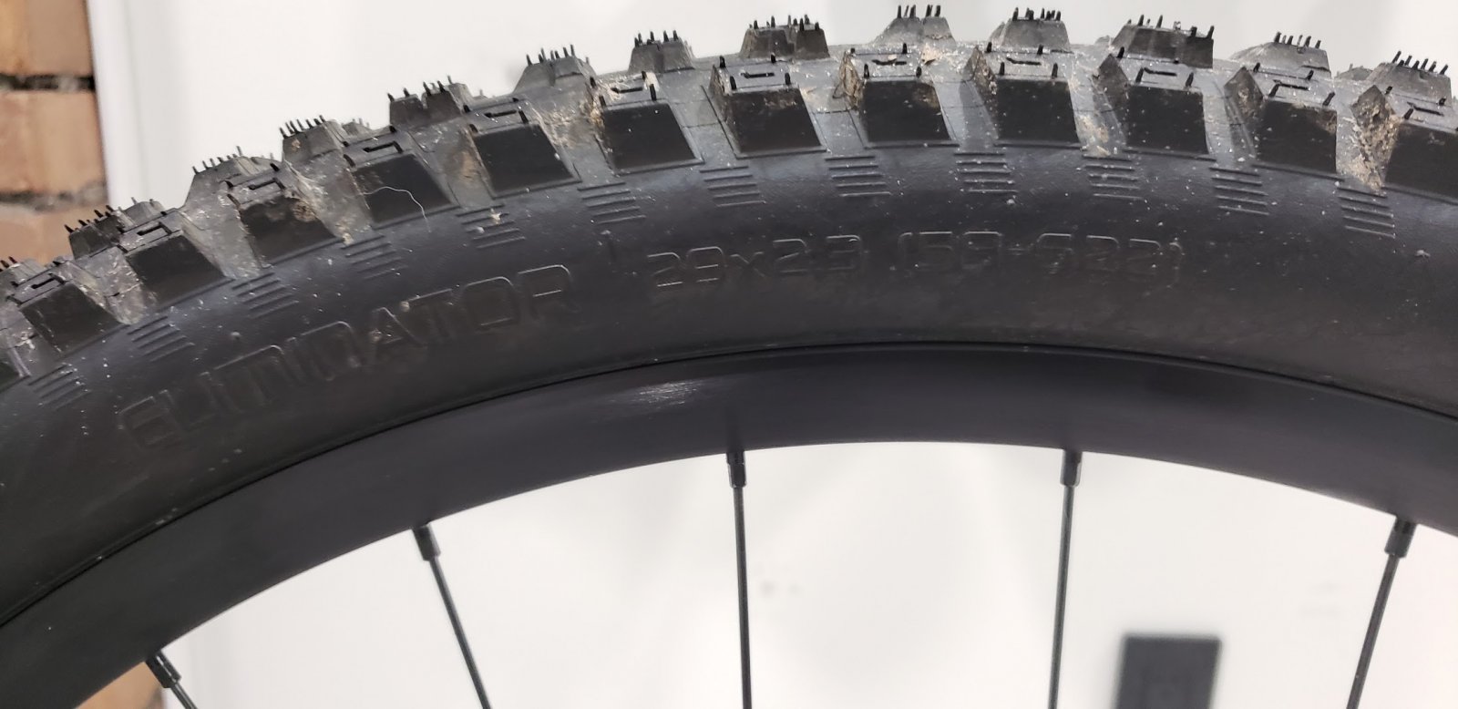

the web site and brochures all said 2.3 but don't know anyone that had a bike delivered with anything other than 2.6.
Just confirmed my rear tire is 29x2.3
Rear:
Front:

Ah thanks....so the web site was right for your country. Certainly the uk bikes were fitted with 2.6 according to people here on the forum.
Interestingly I measured with calipers and I got 2.6 for the front and 2.4 for the rear
