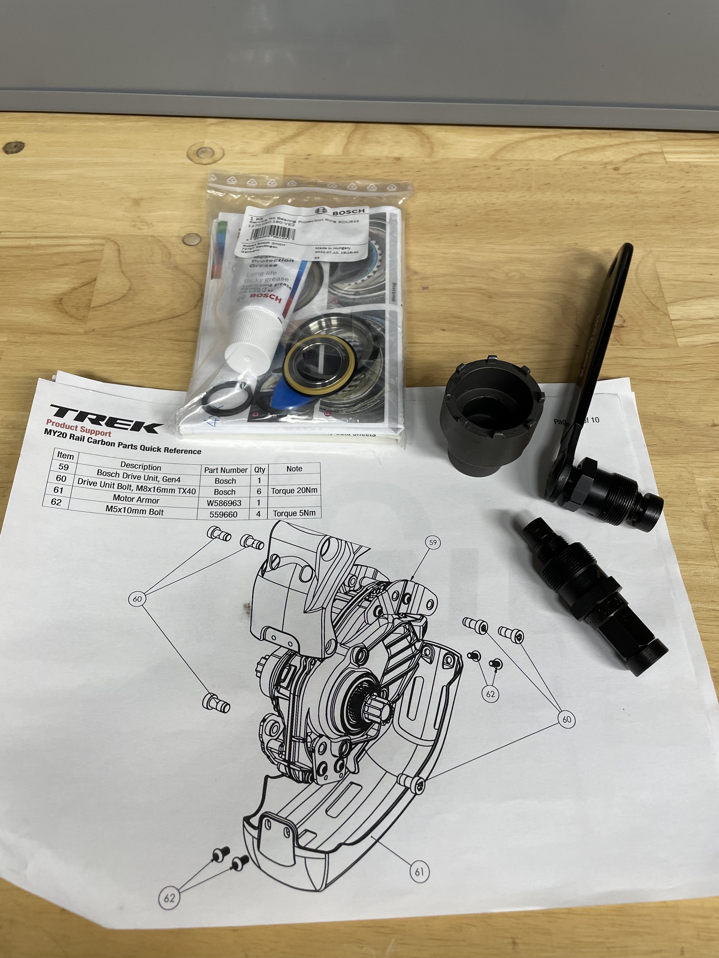

Good time to replace or regrease all those frame suspension bearings. I downloaded the PDF files (and printed) for the torque settings on my Rail (Bosch motor). Nice to have handy for a quick reference. (I think motor/frame bolts were 20nm(6).

Most of the info I needed was available on the Trek site but there’s a lot of information and pictures available in here. (Search)
For your level of service I might also recommend these tools.
A yearly service for the bearing seal kit is a good idea along with some good torque wrenches (2).
