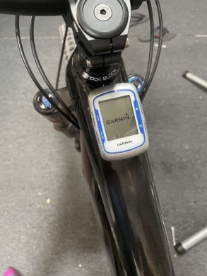

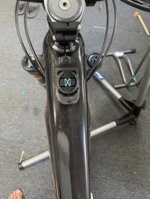

My LBS had the Kiox knock block frame mount. Since my old Edge 500 was working well still and didn't see too much benefit for the Kiox I like the location of the Kiox so I opted to graft in my Garmin mount into the Kiox mount. - Poof! (waiting for the epoxy to cure)

Mine does not have the Kiox. Rail 7 with the Purion. I think the bars look cluttered with both the purion display and the edge.
