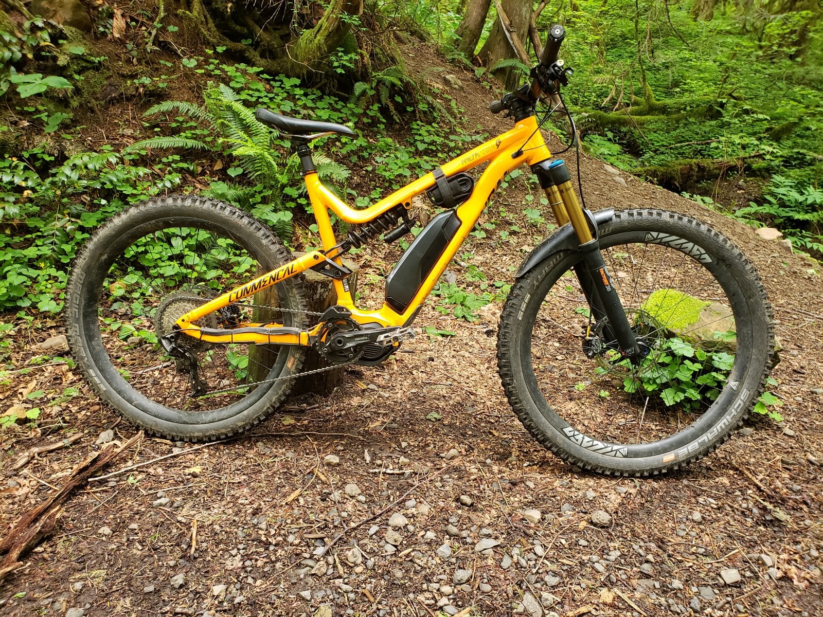

added a fox 36 29er fork with a magic Mary 29x2.6 tire and a mm 27.5x2.6 rear. bike tracks amazing now and eats roots up. I also like that it raised the bb height- I was always scraping my bb but not anymore. really happy with the changes and how this bike rides

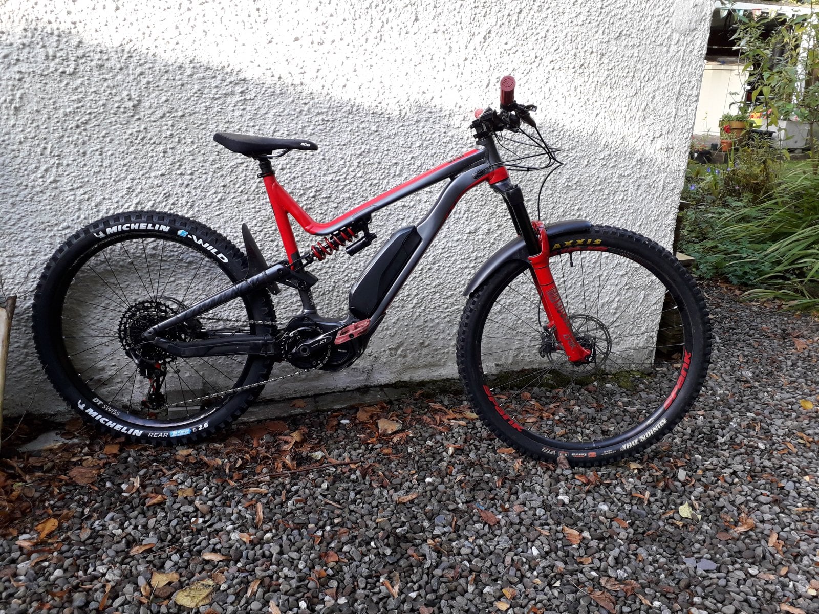

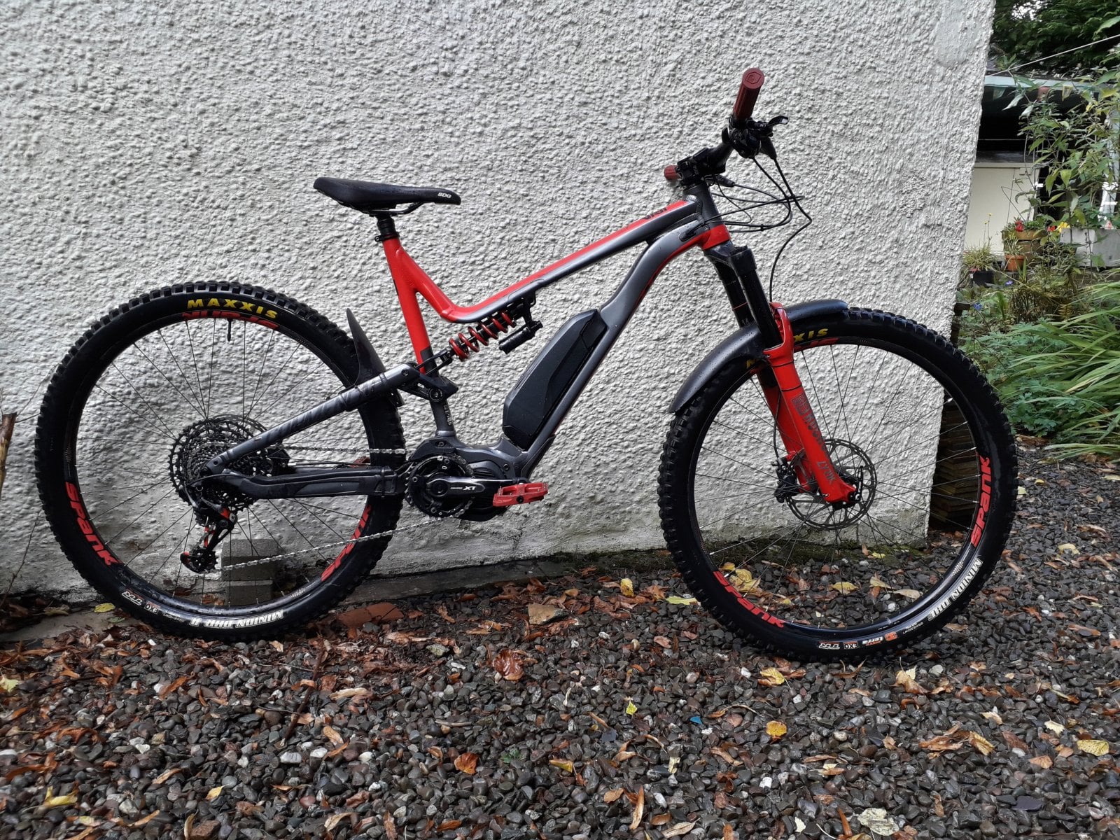

I am going the other way, I have a Meta Power 29, I am just about to put a 27.5 wheel on the back with a 2.6 tyre, trying to slacken the head angle a bit more and perhaps make it slightly more manorverable on steep/tight turns. My only concern is that the BB will be very low and cause some more pedal strikes although most pedal strikes are down to poor technique as you shouldn't be trying to put a full crank in when riding over very rough terrain or charging through a corner. I will measure the height of the BB from the ground to the centre with both the 29er and 27.5 rear wheels to compare.
It may be a case of running the bike as a mullet-bike for e-powered shuttle days and putting the 29er back on for long days out in varying terrain.
I will post some pics and info up when I make the change.

First ride out on the Mullet, felt great, no negatives, the slacker head angle worked for me on the steep chutes and felt better in tight corners too.

I purchased a Works Components angle set head set to use on it but the steerer tube has been cut that short from the factory that I can't use it, even with a stem with the lowest stack height it won't fit. The issue I was having was also down to struggling with the big wheel at the back and the type of trails that are now common place in Scotland being steep with very tight turns running all the way down them, the smaller wheel at the back helped and the lower BB felt great too, I never had a pedal strike on it and had no more belly strikes on the motor than usual (due to the depth of the holes either in front of or behind rocks and roots). I managed to get a wheel, tyre and NX Eagle cassette all new for £200 so not bad really. The bike now feels closer in ride dynamics to my previous Canyon spectral:ON and rides really well, I prefer it to my mates E-Sommet now which is another awesome bike.

My sx originally came with a 180 mm travel 27.5 lyrik. I went with a 170 fox 38 for my 29 wheel I added. Thought going a bit shorter in travel would help offset the larger wheel
