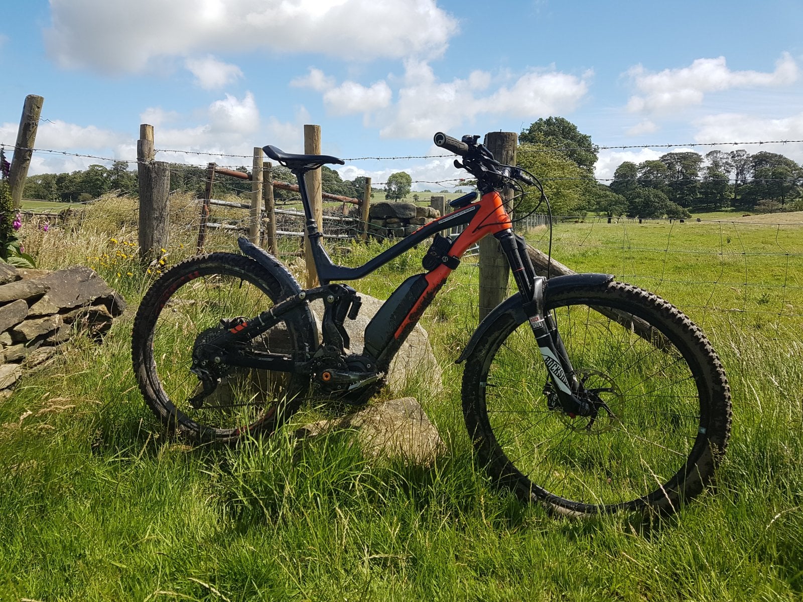

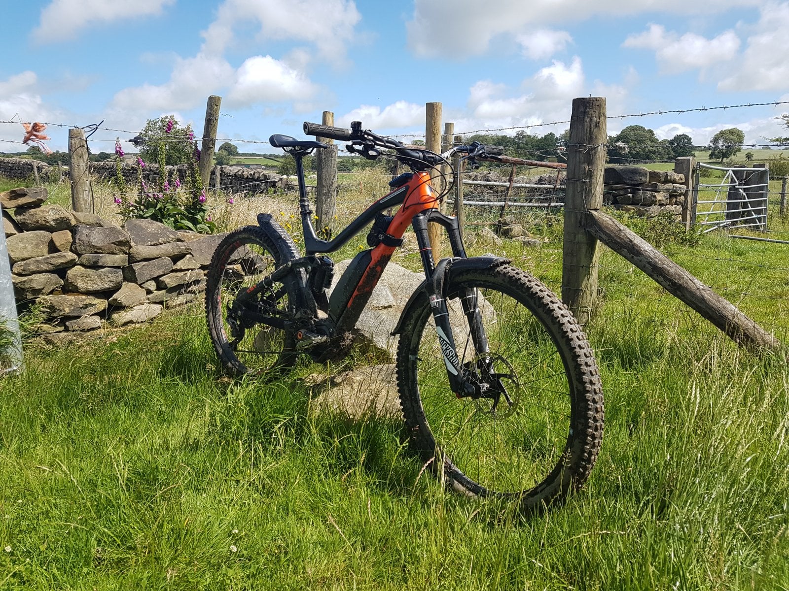

Finally got everything together to mullet the sommet, Yaris with the new 160mm 2021 airshaft, wheel I have nicked off one of my other bikes, seems ok riding up and down the street but first proper ride tomorrow if the weather behaves,

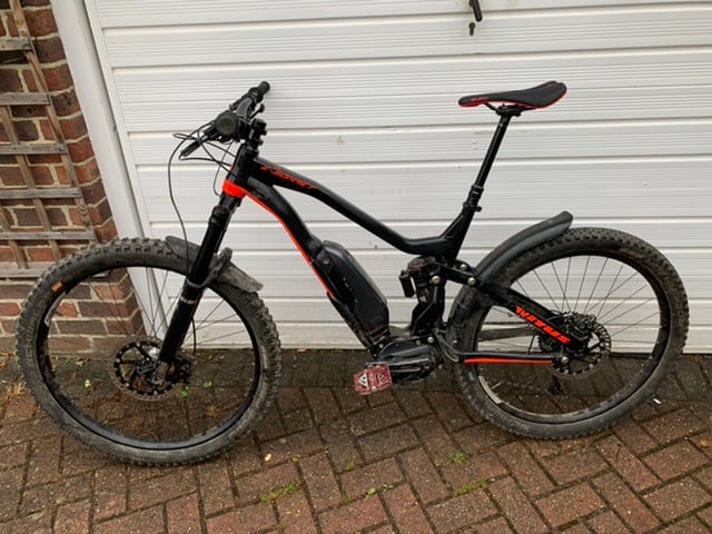

I thought about doing it on my E-Sommet using the Manitou Mezzer off my other bike but figured would have to drop to 150mm to keep similar geometry. Instead my 29er clockwork bike I have run a 27.5 in the rear which is great fun in the woods, my Gravel bike is also a mullet with 700c up front & 650b on rear

First ride and I can't honestly say I noticed a massive difference, my local trails are not the most demanding but I do have a steep,slippery rocky climb and it did seem better there

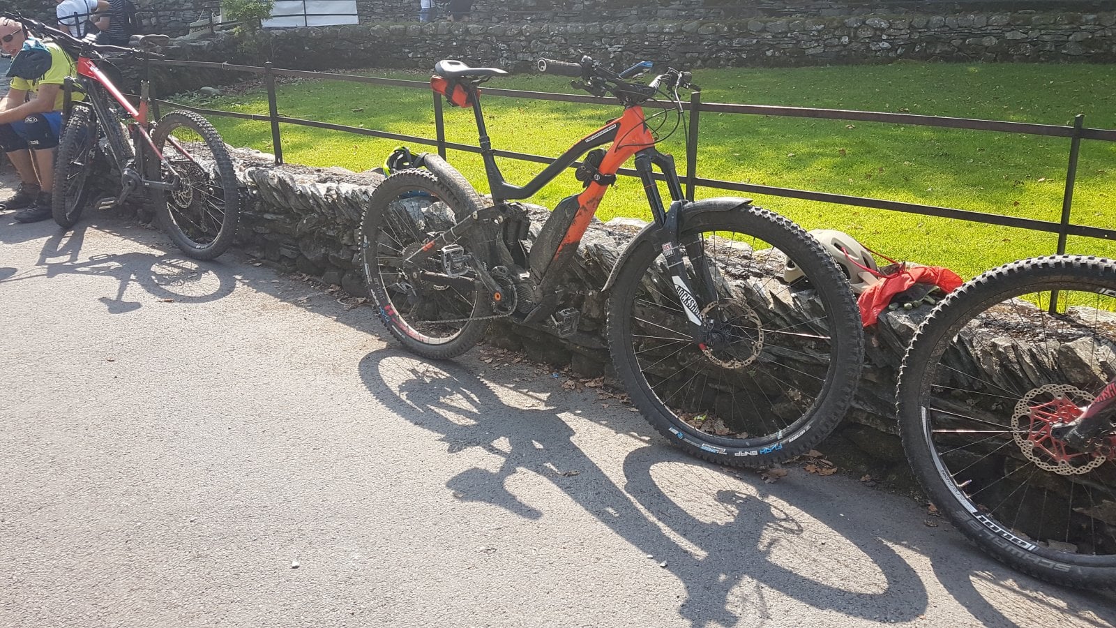

Had first proper test of the bike in it's mullet set-up on Wednesday, lots of rocky technical Lakes trails and I think the bike is better on these sort of trails with the 29 front wheel

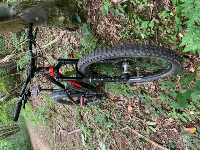

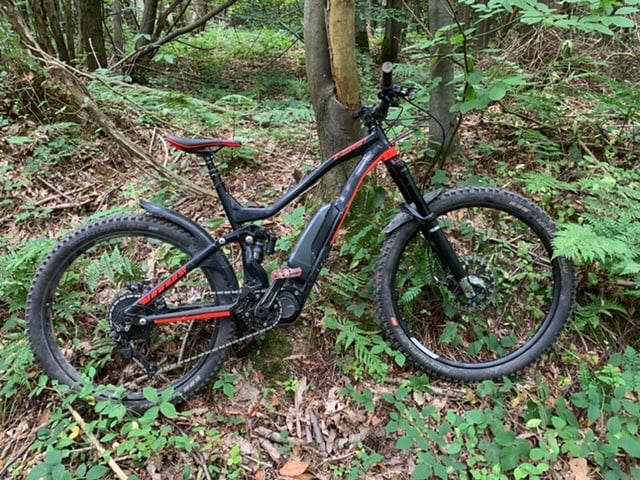

Decided to Mullet my e-Sommet took the fork off analog bike & upped travel to 160mm on the Mezzer, easy 1st ride towing the tag along round Bedgebury, it’s funny when overtake people then they see my son chilling on the back of the tag along we avg 8.5mph

Quite enjoying riding the mullet setup few pbs today, taking it to Wales in couple weeks & early ride round Surrey on sat
