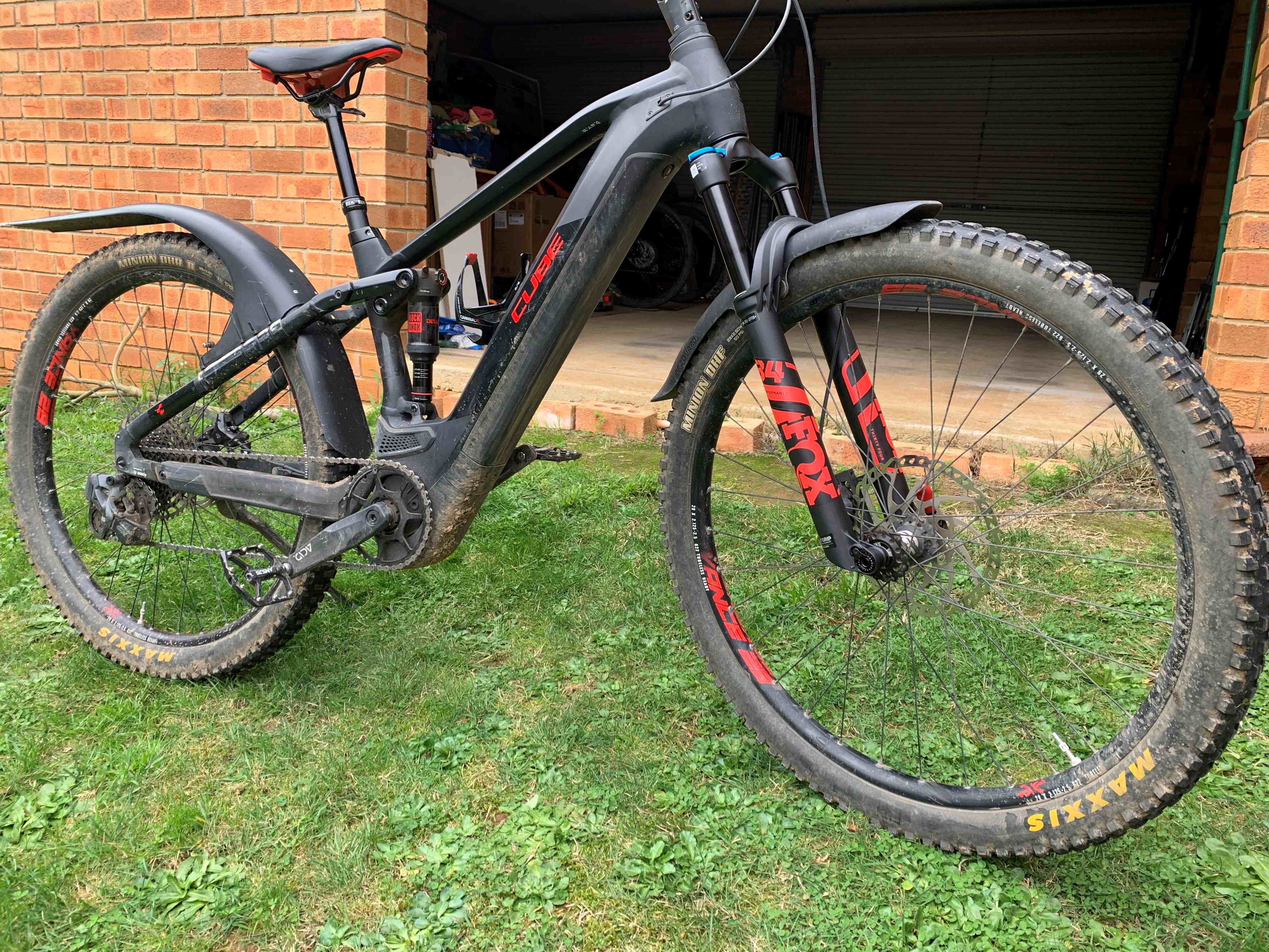

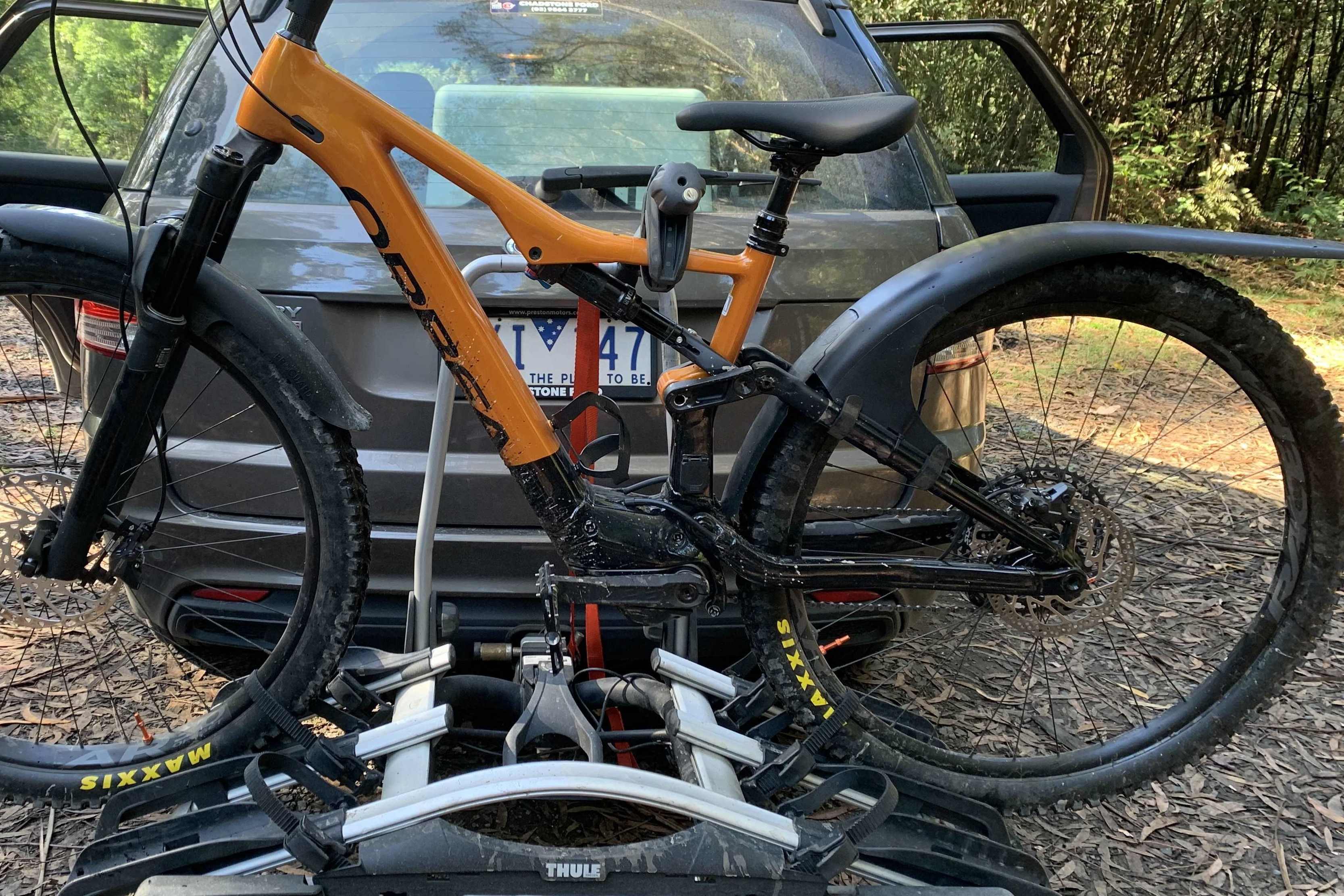

Even if it needs a little trimming or alteration the Mudhugger V2 should fit your bike. The tongue does a pretty good job of keeping mud off the bearings on my Rise. I've got the first version on my Cube and rivetted on a bit of old mudguard to act as the tongue - looks ordinary but most of my riding is in muddy conditions.

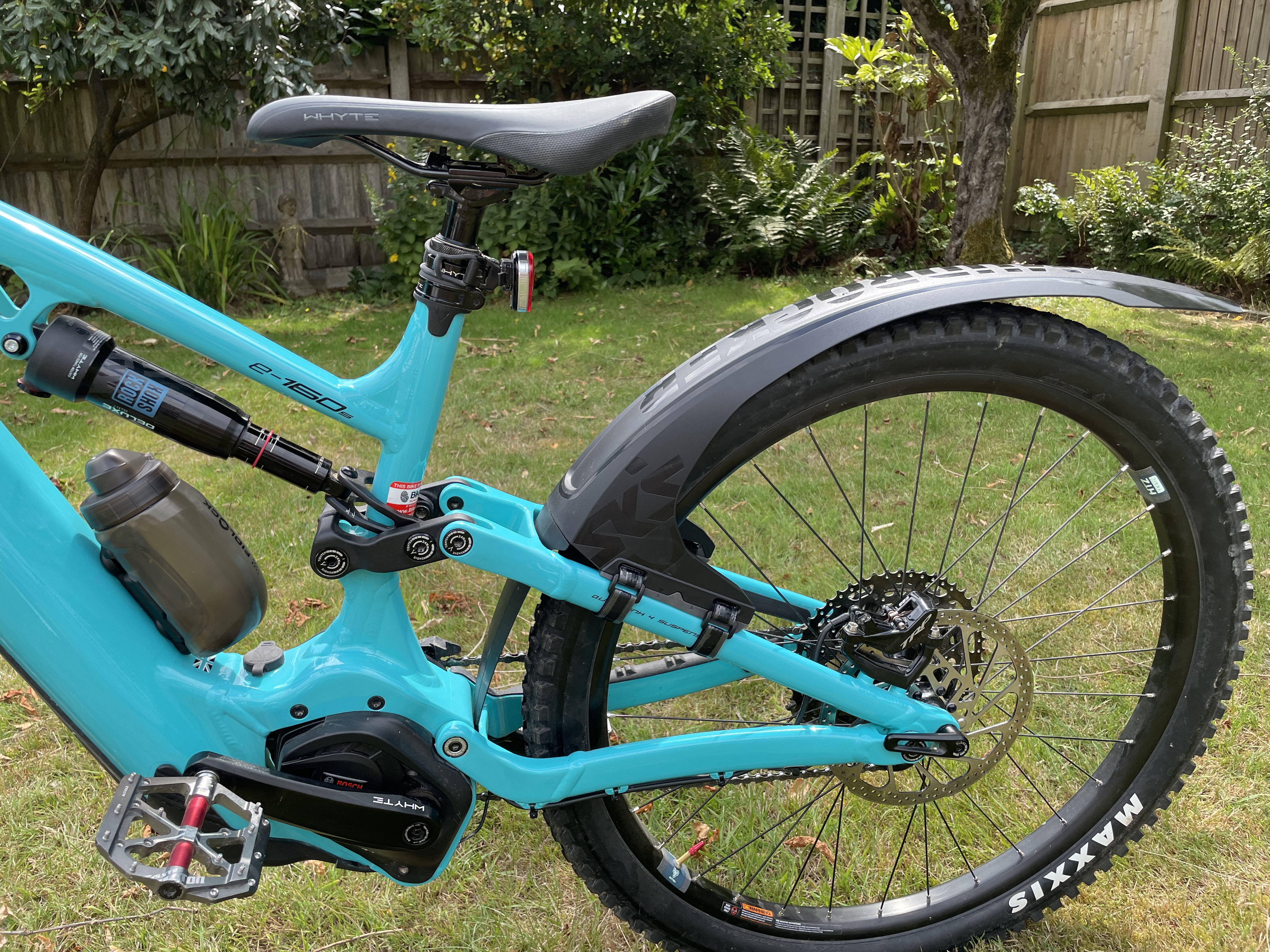

I have mudhuggers on 29er
You have to cut it slightly narrower where the seat stay bridge is and shorten it at the bottom or it will rub near the motor.
I just used a pair of really sharp scissors.
the part that slides through the seat stay bridge just clicks into the mudguard btw
I still get a few spots of mud on my back and when it's been raining when I hit like 15mph there's a big rooster tail shooting pretty much vertical up into the sky from the backwheel
with mullet I guess the rear mudguard covers the full length of the tyre though

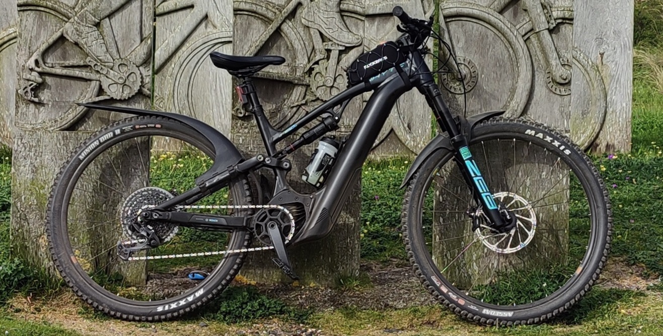

I'm the OP and decided to go with the SKS Mudrocker which I fitted today - along with a Mudhugger front.
Overall I am happy - it fits well on my 160S MX (Mullet) under the seatstay bridge so no issues when bottomed out and plenty of tire to mudguard clearance
But I have a few niggles:
1. The front extension piece could be longer to protect the lower bearings- I wish they had made it 50mm longer since the user can trim it easily with scissors.
2. The frame protection they supplied is only 84mm wide so it does not quite wrap around the seatstays. Luckily I had some spare 100mm material.
3. They only supplied 2 pieces of frame protection but you will likely need some for the seatstay bridge and the back of the motor where the extension may rub.
The Mudhugger 'bolt-on' front fitted just fine but it is annoying they charge an extra fiver for a small piece of plastic to fit the Zeb!

The size L mudhugger extends past the end of a 29" wheel and can be trimmed by about 2cm.
I'm sure mine is a Large mk2 and it definetly doesn't as shown in the picture I posted in this thread.
maybe mk1 were longer? but also it could depend on the angle of the rear suspension pivot beam thingy whatever it's called that the guard attaches to.
so one one brand it does but on a whyte E-160 it doesn't because of the shallow angle it sits on.
Like on the your Cube pic. it looks like the mudguard sits a lot higher on the frame than on my whyte
