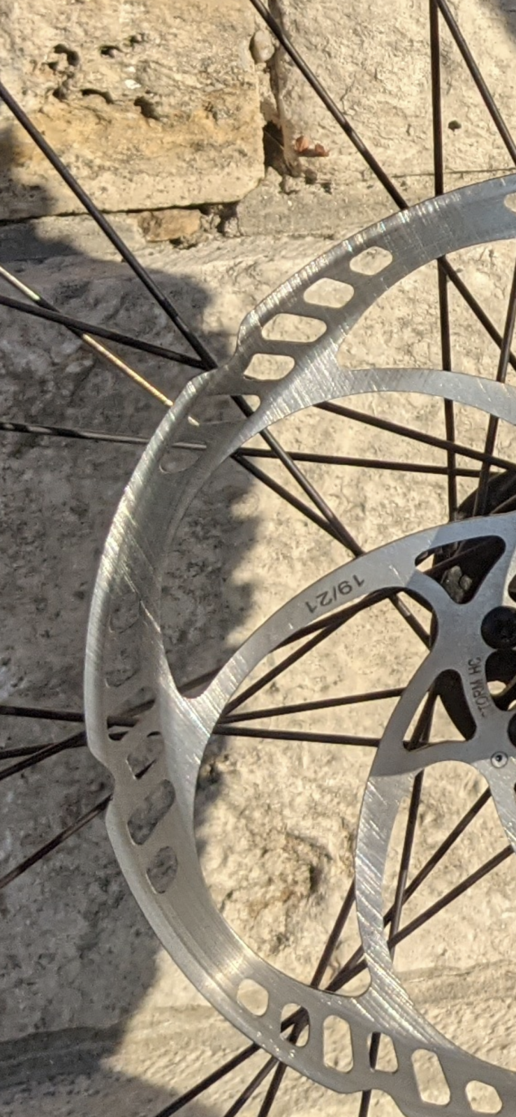

Btw, i noticed that there is a thin line around the rotor that hasnt been polished by the pads that much even though the pads seems to cover the edge of the rotor.
I'm attaching a photo

Yes center the caliper to the rotors.
By the looks of that picture, you're not using the full surface of the rotor. What size rotor is it and what's the post to post or adapter you're using?
Front: 203 mm Magura Storm HC rotors, QM42 magura adaptors, Fox 34 Rhythm fork
Rear: Same rotor, QM 9 adaptors, Santa Cruz Chameleon 2018 frame
I already replaced the stock pads with the one pad / piston performance p8 pads. The stock pads made the same noise.
I chose the adaptors based on the official charts and when you look at the brakes the pads seems to cover the discs properly. But I'll check it again and attach another photo as soon as I can.

Use this link
That disc is about 3mm out, my pads are at the top of the disc.
Double check the adapters are correct, you can't use a 200mm on a 203mm disc

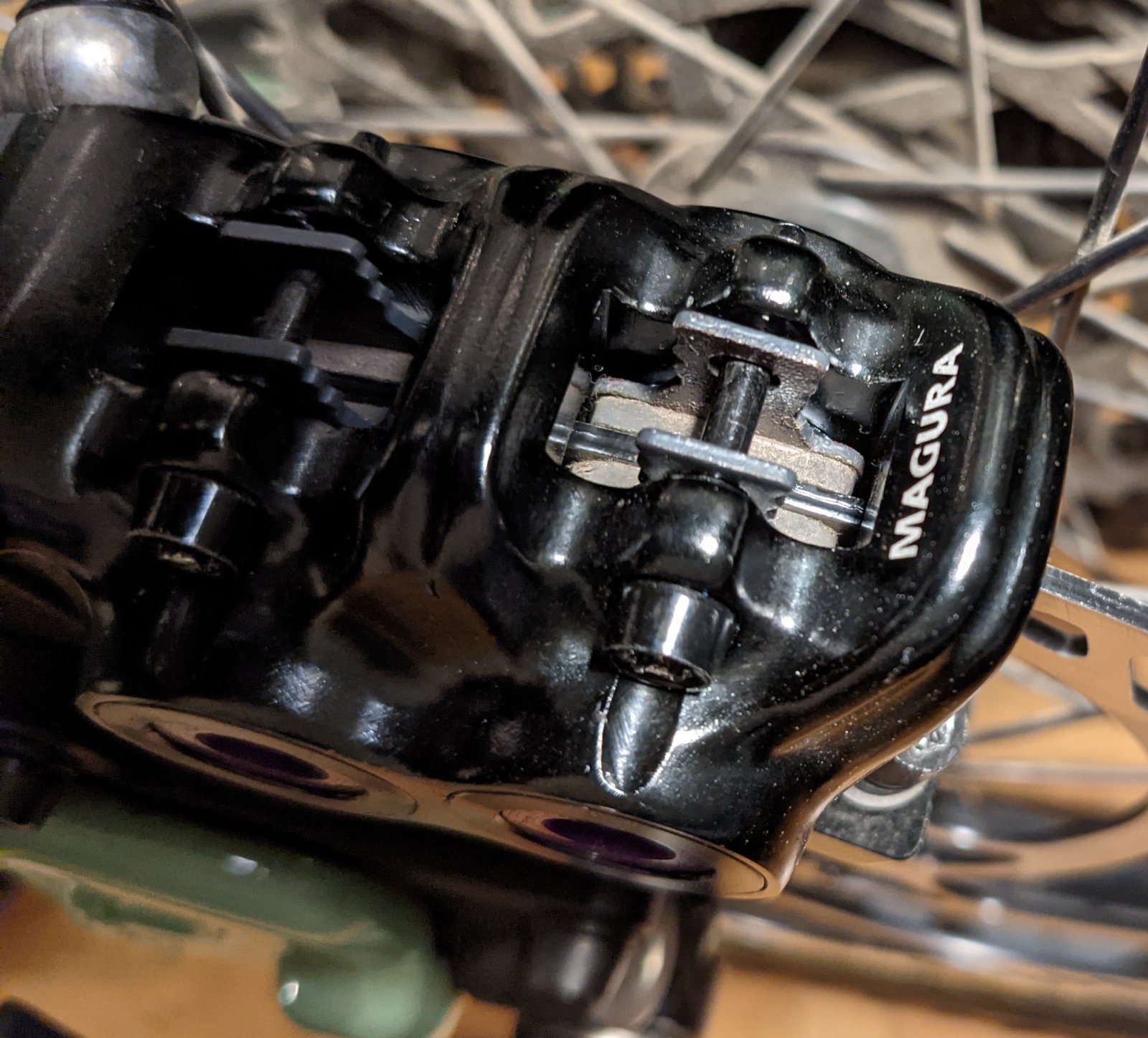

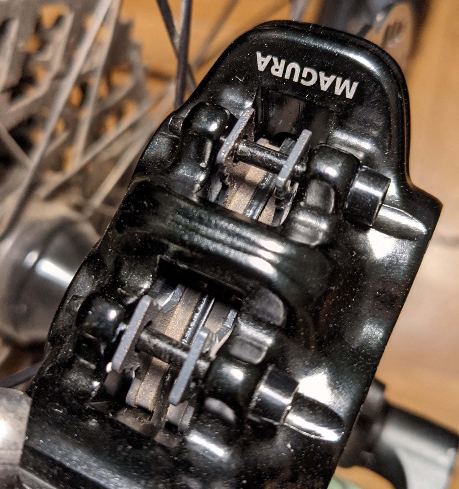

Something isn't adding up.
The picture of the rotor shows insufficient height of the pads and would suggest spacers are needed or incorrect adapter.
The caliper pictures look like they're in-line with top of rotors, maybe a bad angle?
Do you have any 1.5mm spacers to try? You'll need one on each side of caliper to raise it 3mm.
Are the adapters flush with frame?
Maybe a shot of adapters and calipers and side shot with rotor in?

Ever done a serious break in, everything seems well adjusted, but i miss a sharply delineated trace at the bottom and top, looks pretty new.
