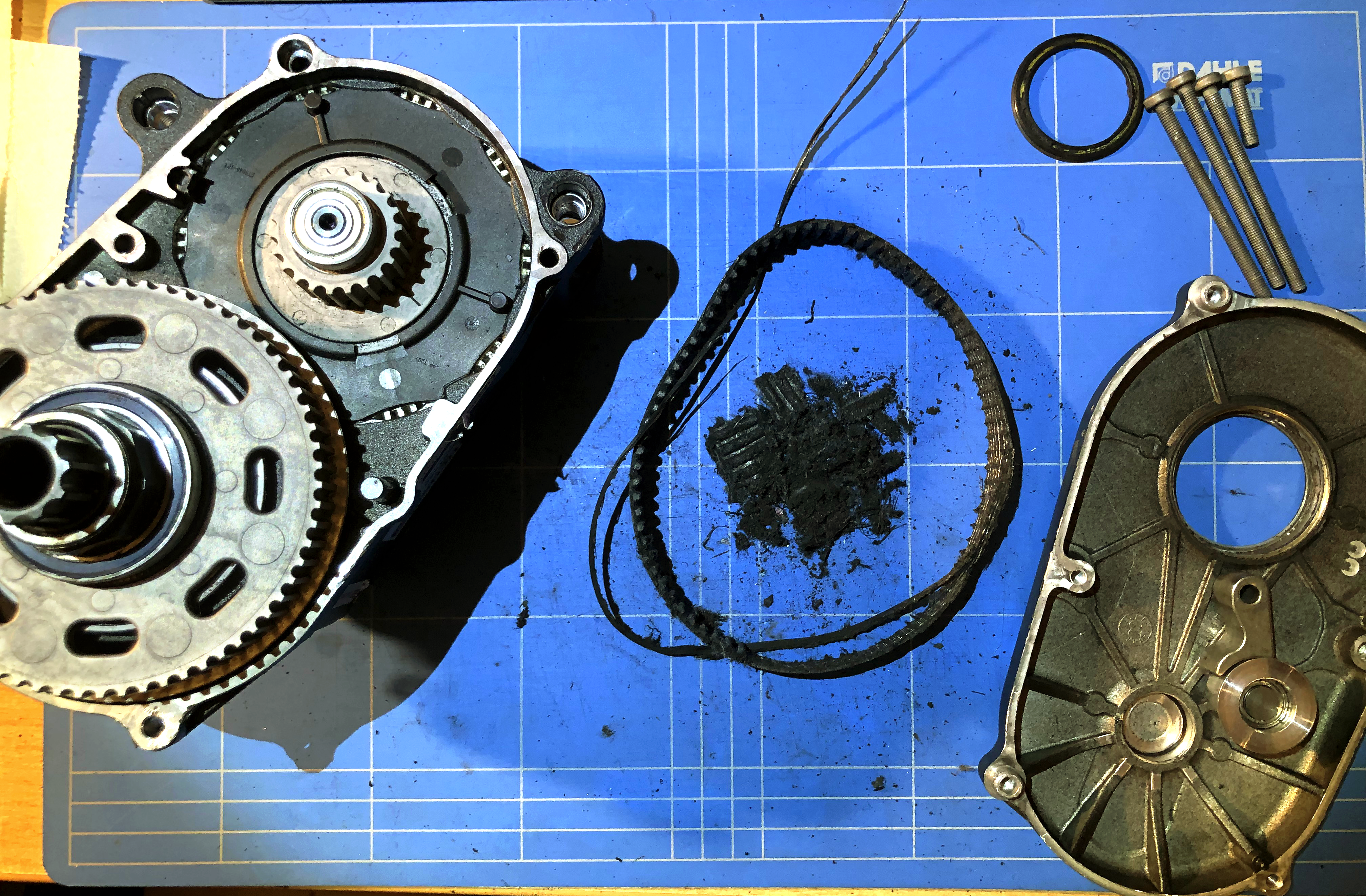

After neither Specialized nor my dealer have contacted me since, I finally opened up the motor. Which was harder than I anticipated, in the videos it always seemed to be relatively easy, but I had to pry somewhat hard, marring the material a bit. The bearing around the axle was very tightly fitted into the lid for me, almost like pressed in.
I did get it off eventually, and was presented with a catastrophic belt failure.
At least I now know that riding in bad weather conditions wasn't the reason for the failure, which is a bit reassuring (and I always avoided using a pressure washer anyway).
That belt is horrible!

So all you need is a new belt and the motor is good to go?
This and a new seal and a new crush ring, which are included in the belt kit.
At least I suppose it would work, I couldn't see any other damage and the cogs worked fine once the belt was removed.
The tension adjuster seemed to be fine as well, it's on the right in the image (on the lid).
