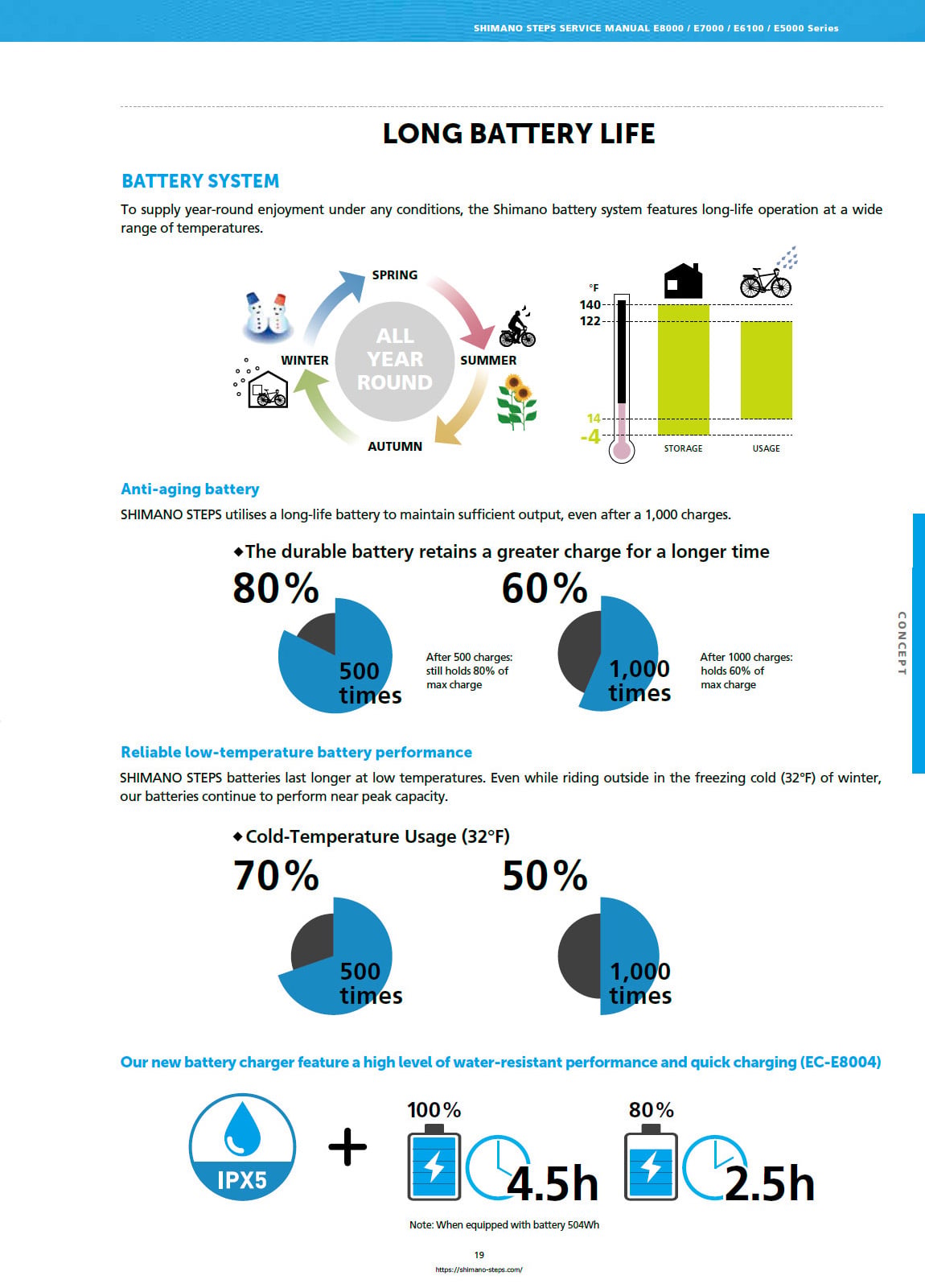

Spiff
Feb 27, 2019
448
263
Earth
My first emtb was in 2019and it had an e8000 motor. The data that came with it spoke of 1000 recharge cycles before the battery charge fell to 90%. I wish that I had kept that hard copy, because I sure can't find that on the internet anymore. Now people are mentioning 500 recharge cycles!
Here it is....

Interesting specs, 80% after 500 charges doesn't sound great. Is that the spec for today's batteries? I'm trying to baby my battery, keeping it ~60% when I'm not using it. I have it on a smart plug and charge it the morning of to 100% when I know I need it. I have never gone completely to 0%, I think the lowest I've gotten to is ~10%. I have a 900 watt battery so I usually am able to get at least two rides before worry about charging. With that much battery, I think the very worst case scenario of 20miles per charge at 500 cycles would equal over 10,000 miles so I feel pretty good about longevity...
Spiff
Feb 27, 2019
448
263
Earth
80% at 500 cycles is very good compared to the real Shimano batteries.
I had a Shimano 504Wh BT-E8010 that after 80 Cycles had a degradation of 76%, then Shimano removed the degradation number from etube diagnostic after V4.0.3 .
But it still could be read using STunlocker, and take into account that when reading degradation value from the battery, the data path is: Battery->Motor->Display->BT->Cell.
As battery FW is not upgradeable it was not possible for Shimano to "improve" the degradation number calculation in the battery, so Shimano fix was to release a motor FW upgrade 4.9.4 (For E8000, but EP6 and EP8 have a similar FW upgrade) that when degradation data was transfered to the motor, it changed the degradation number from 76% to 86% , so it was not covered by the battery warranty.
