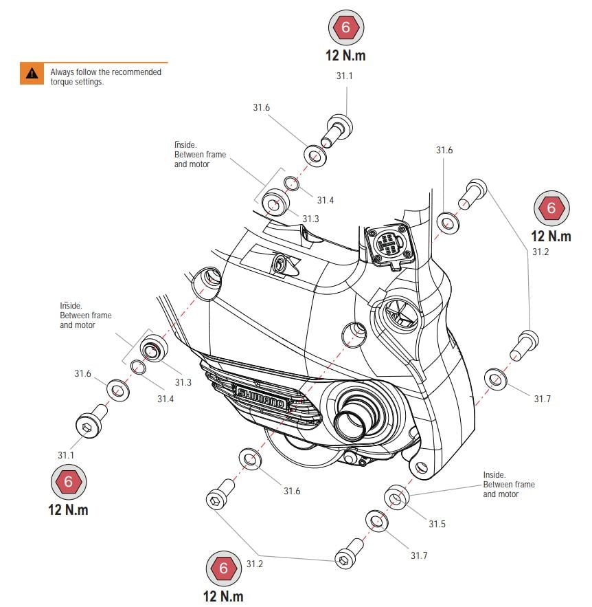

1) I like to drop the motor only a few inches when I replace my brake hose or dropper/shift cable housing. I do not disconnect any wires and I lower the motor onto a padded stool which I place several inches beneath the motor. There is enough slack in the wiring to do this. The motor's bottom is slightly uneven. I use a towel placed on the stool as padding to help stabilize the motor and prevent it from rolling off of the stool while I work. The whole process of removing the motor takes me a little less than ten minutes to do.
NOTE: To lower the motor, you must gain access and remove all six of the hex head bolts. Unfortunately, the chainring prevents one of the hex head bolts from being fully removed and it'll hang the motor up. The chainring must be removed in order to completely remove the bolt. It may be possible to remove the bolt without removing the chainring, but my guess is you'll end up damaging the chainring or the finish on the bolt.
I start by raising my bike up on a bicycle stand. I wrap a velcro strap around the rear brake lever and lock the rear brake. The locked rear brake keeps the front chainring from turning when you go to loosen the chainring nut. If you cannot lock your rear brake, i.e. the caliper has been removed, you can use a chain whip tool to hold the chainring while you loosen the nut. I use Park Tool's "LRT-2 Shimano Steps Lockring Socket Tool" to loosen the chainring spindle nut. There are other lockring socket tools available for sale on Amazon that work equally well.
2) Remove the drive side crank arm and chain guide. Place your lockring socket tool on the chainring spindle nut and turn it "Clockwise" to loosen and remove the spindle nut. Note that the shaft is reverse thread and to loosen the nut you must turn the nut clockwise.
3) Pull the derailleur swing arm forward to un-tension the chain. Remove the chain from the chainring. With the chainring nut removed, pull the chainring off the drive spindle with a slight pull. Once the chainring is removed, you now will have access to all six motor mount hex bolts.
4) Jiggle the motor loose and "Slowly" lower the motor down a few inches and onto the stool. Make sure the motor doesn't fall off the stool. There are three aluminum spacers used with the six bolts to mount the motor to the frame. One or more of the spacers may fall out when you remove the motor from the frame. Two of the spacers will have a small machined shoulder. These two spacers mount inside the frame at the front of the motor. The third spacer is flat on both sides and mounts at the back of the motor, non-drive side.
5) With the motor lowered, you now have access to all brake hose, cable housing and electrical connections. Inspect the shifter and dropper cable housing for wear. If they look bad, now's the time to replace them. Also check your wiring to make sure none of the insulation has been rubbed off from vibration.
6) The angle where the lower downtube opening meets at the frame motor mount is sharp. You want your brake hose and dropper/derailleur cable housings where they exit the downtube and make the sharp bend and transition up and over the top of the motor to be snug, but not so snug that the brake hose and cable housings will chafe and rub against the downtube opening. At the same time, you don't want so much slack in the hose and housing that when you go to re-insert the motor, you mash the excess slack in the hose and housing against the frame and motor. This too will cause excess rubbing and chafing on the hose, housing and motor wiring. I like to give the brake hose and cable housing a finger's width of slack between the downtube and the top of the frame where the motor mounts. The goal is to make sure the hose/housing isn’t so long you smash or kink the hose when reinstalling the motor or you inadvertently pinch the brake hose or cable housing if it bends too tightly or sharply out of the downtube and back up over the motor. In other words, too tight and it will rub, too much slack and things get mashed.
7) Prior to mounting the motor, have your Nm torque wrench, blue thread locker and non-IPA beer handy. Make sure the threads on the motor mounting bolts are clear of bulked up thread locker. If they are, clean them up with an old tooth brush. Make sure the six threaded bolt holes on the motor are also clear of debris by blowing air into the motor mounting holes.
With your fingers, reach up into the frame and make sure the front two motor spacers are pushed all the way into their respective sockets at the front frame motor mounts. Lift the motor up into place. You will have to wiggle the motor a little bit to line up the first few bolts. The rear non-drive side aluminum spacer can be fussy to get into place. I've found it much easier to hold it against the motor and slide both the motor and spacer into position at the same time. Apply a small dab of blue thread locker onto each of the six bolts and install. Do not tighten the bolts until all of the bolts have been threaded into place. Torque the bolts to specification as listed in the "Blue Paper" Rise owner's manual.

Good write up, thanks for posting. FWIW it IS possible to drop the motor with no damage without removing the chainring. But it was one of the most stressful evenings of my life and not to be recommended. You will also need a sacrificial allen key to be cut down to fit behind the chainring. The very snug fitting bolt that hangs against the back of the ring on removal will not come out untill all the other bolts are loose and you are able to wiggle the motor ever so slightly which gives up the 1/2 mm of play needed to cant the bolt over and out.
I now have the correct chainring tool and hope to never have to go through that again :)
