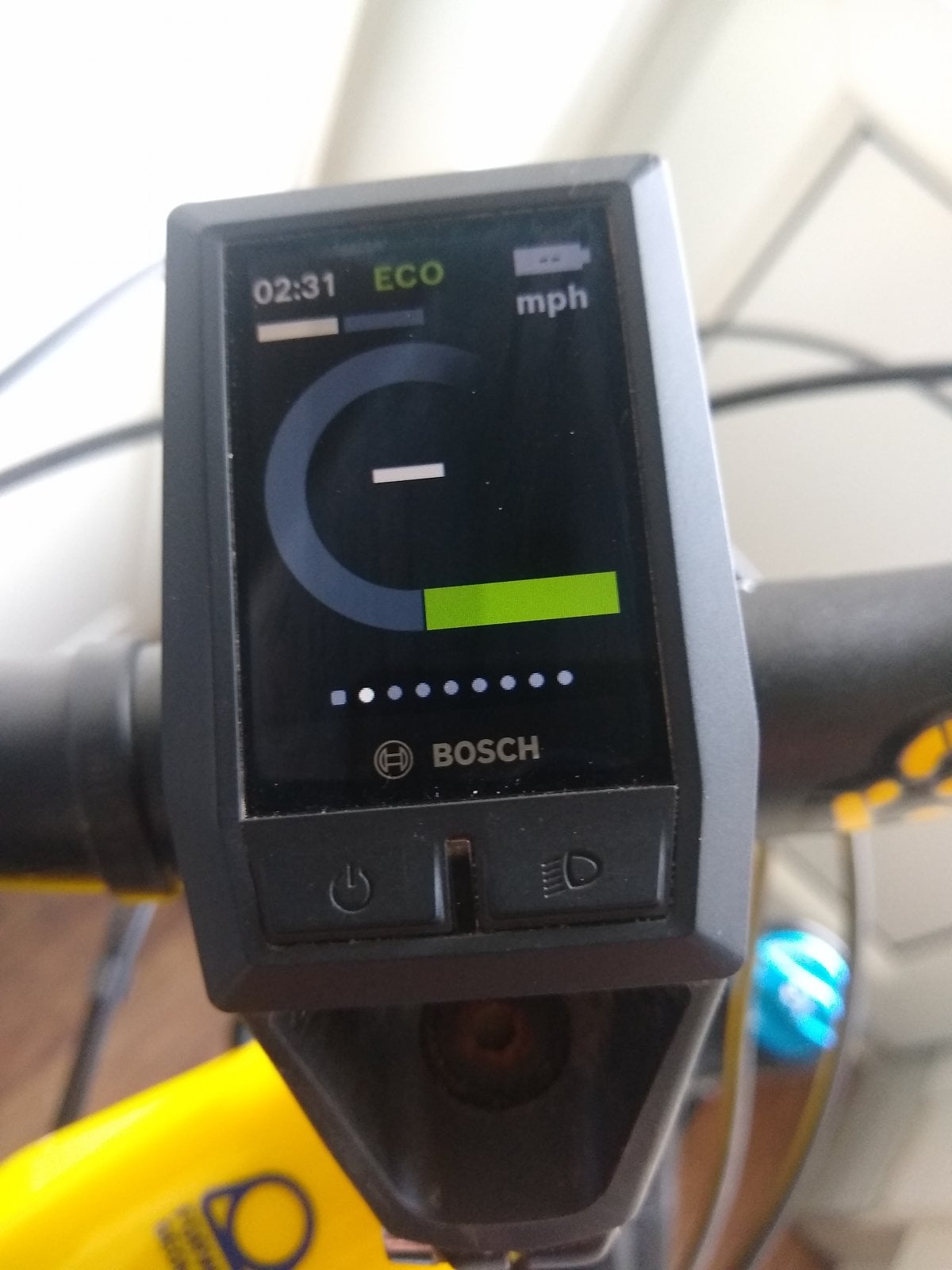

3 miles into my snowy ride today the motor assistance cut out. My kiox display is still on but it shows a dash in the battery icon instead of a battery %, this is what you see if the battery isn't in the frame, so it's not recognising the battery for some reason.

This is what I see on the display, I'm not sure if I would have had an error code 503 if this was just related to the sensor?

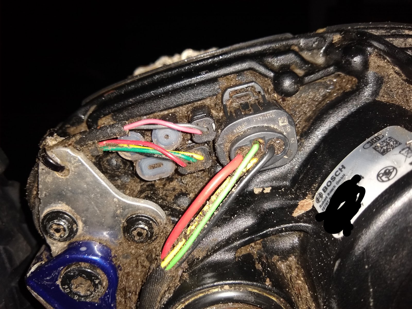

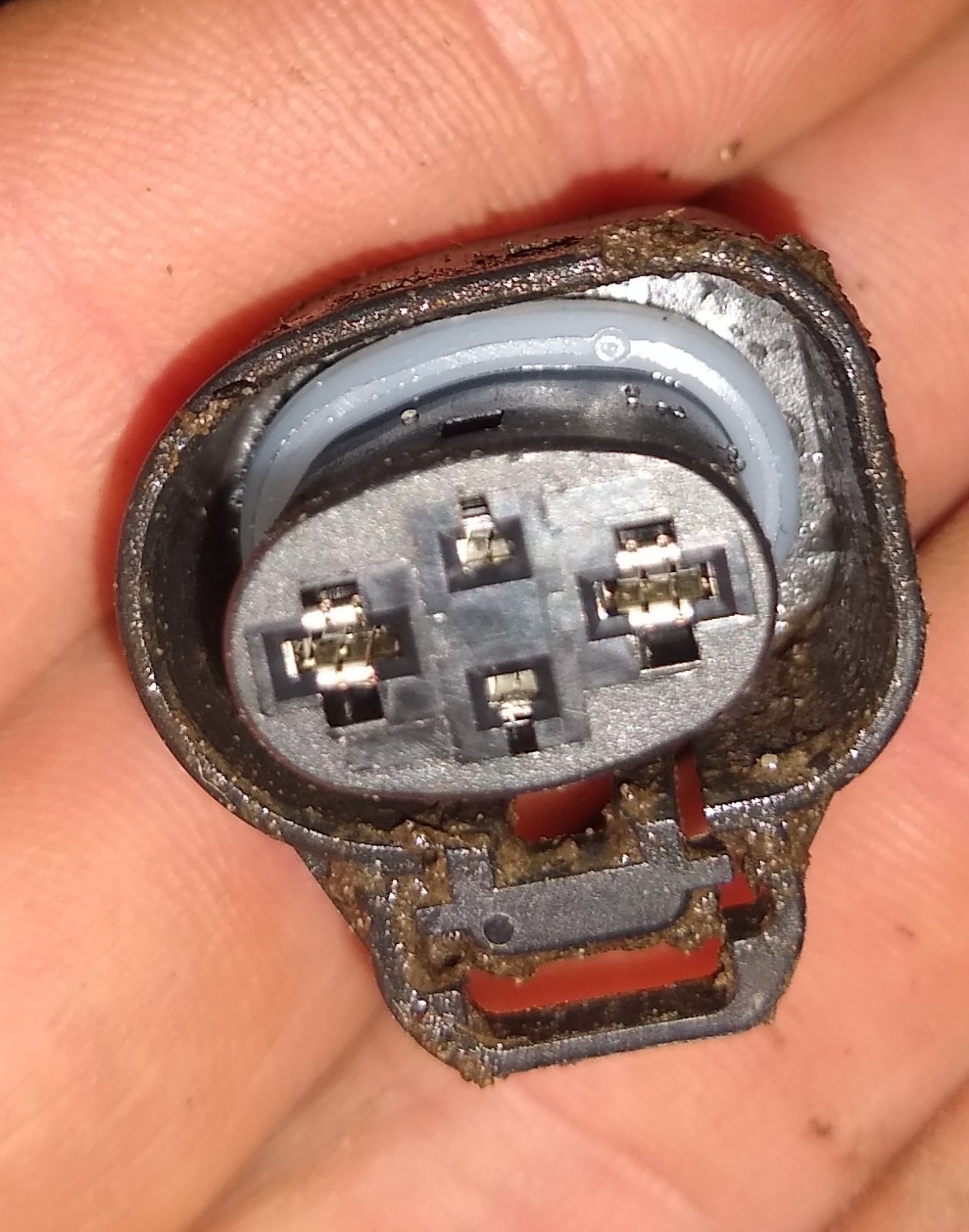

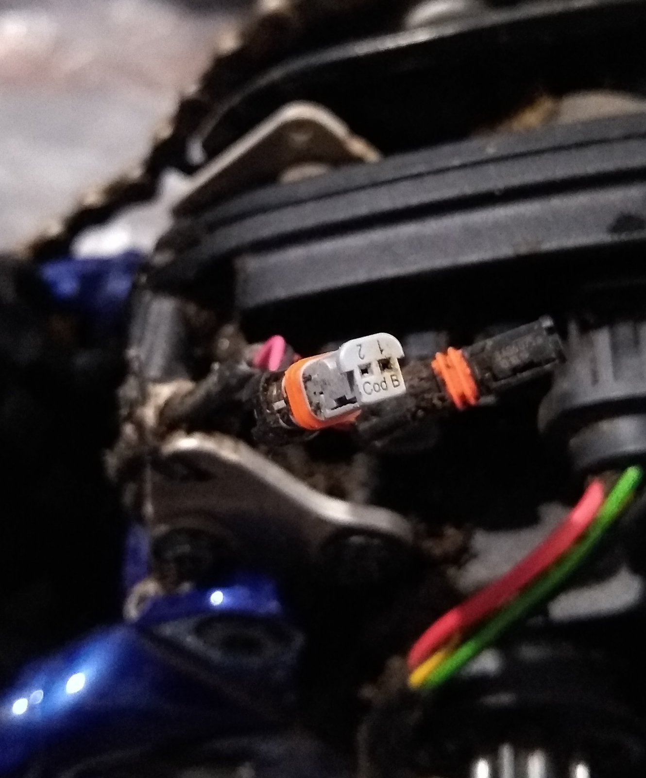

Motor covers off - there's a fair amount of mud around the connections. I've given it a bit of a clean out and have had the connectors off and have a little spray on contact cleaner in them, allowed to dry and refitted (motor upside down in pic)
The biggest connector (assume going to battery?) had a bit of mud under the plastic cover, but the seals seem to have kept the rest out
One of the smaller connectors looks a bit dodgy? Not sure of that's a bit of mud in there or if this would cause the issues I'm having
The battery mount all looks pretty clean. I've wiped some contact cleaner on the pins with cotton wool buds and gave the battery connectors a spray
Cheers for the suggestions, it might have to go back under warranty if I can't solve this.

My motor on my Orbea is similarly full of mud round where the wires plug in. The bosch dealer told me that as long as the connectors are plugged in fully they are fully water/dirt proof, so I don't think the dirt round that area is the issue if its all plugged in OK.
Maybe that bit of dirt inside that 2 pin plug is a problem though.
What about the connector that fits into the battery, ie at the battery end of the wiring. is that clean?
You could try plugging the charger in to bike (not into the battery directly) if it won't charge the battery then that probably narrows it down to a problem with the main battery wiring or conevtions

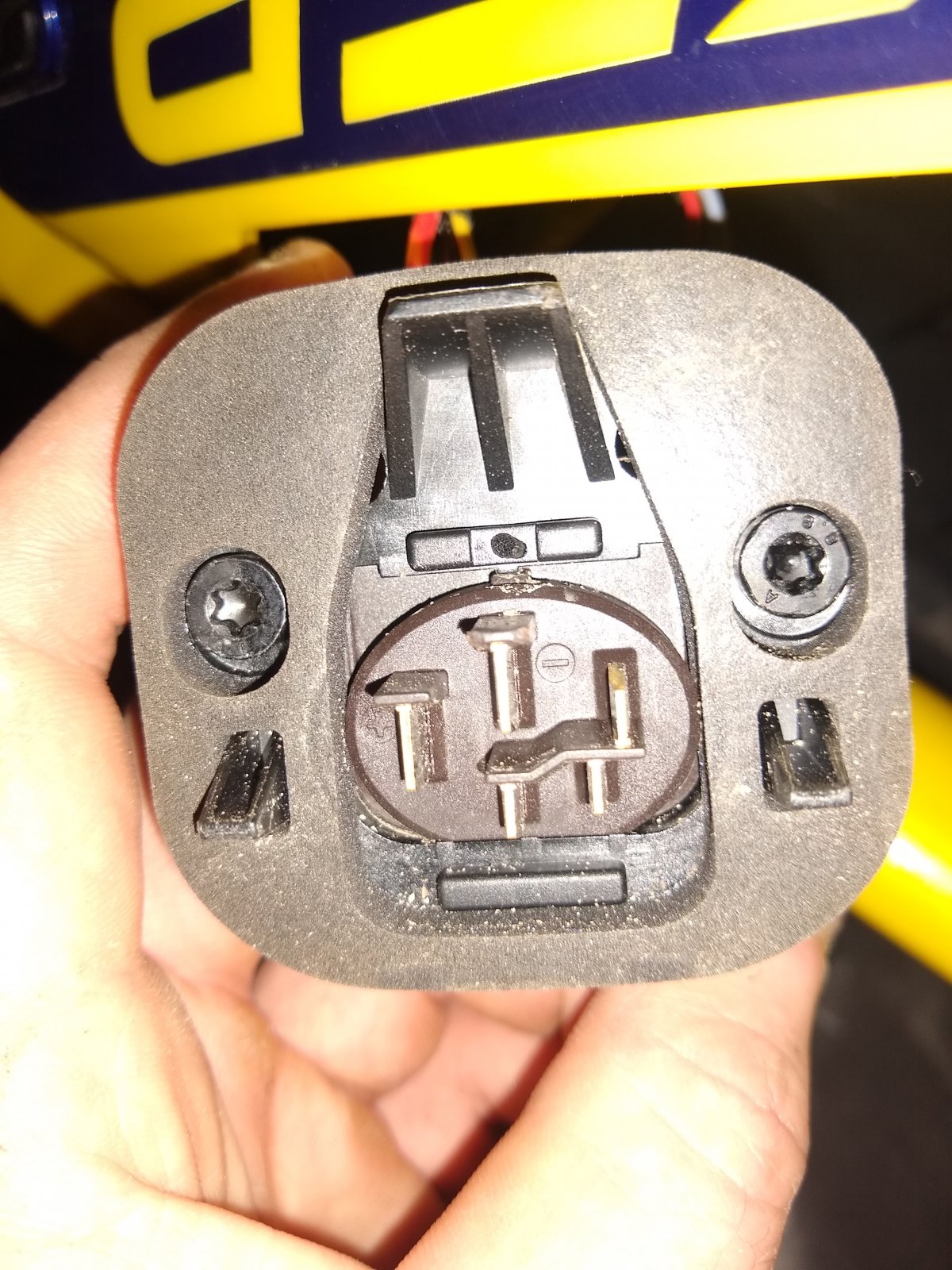

The connector that goes into the battery is the 3rd/4th pic in my last post and all looks like new.
I've just tried the charger and it charges up fine while in the bike.
So possibly the cable between the motor and battery is playing up?

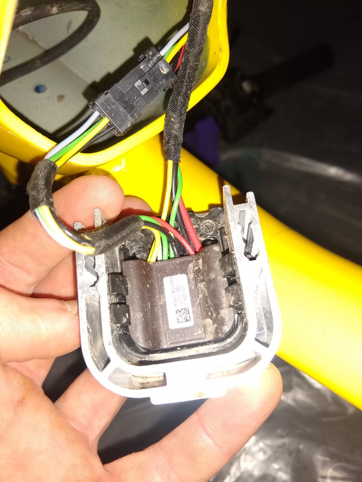

I reckon because it's charging OK, it's more likely to be an issue with the cable that goes from the motor to kiox.
I guess it still could be a problem in the wiring between motor and battery, but given how expose dthe kiox is, I'd be looking for a problem there. Maybe another look at the kiox mount, see if it's making contact properly, can you push it in harder, wiggle it etc
