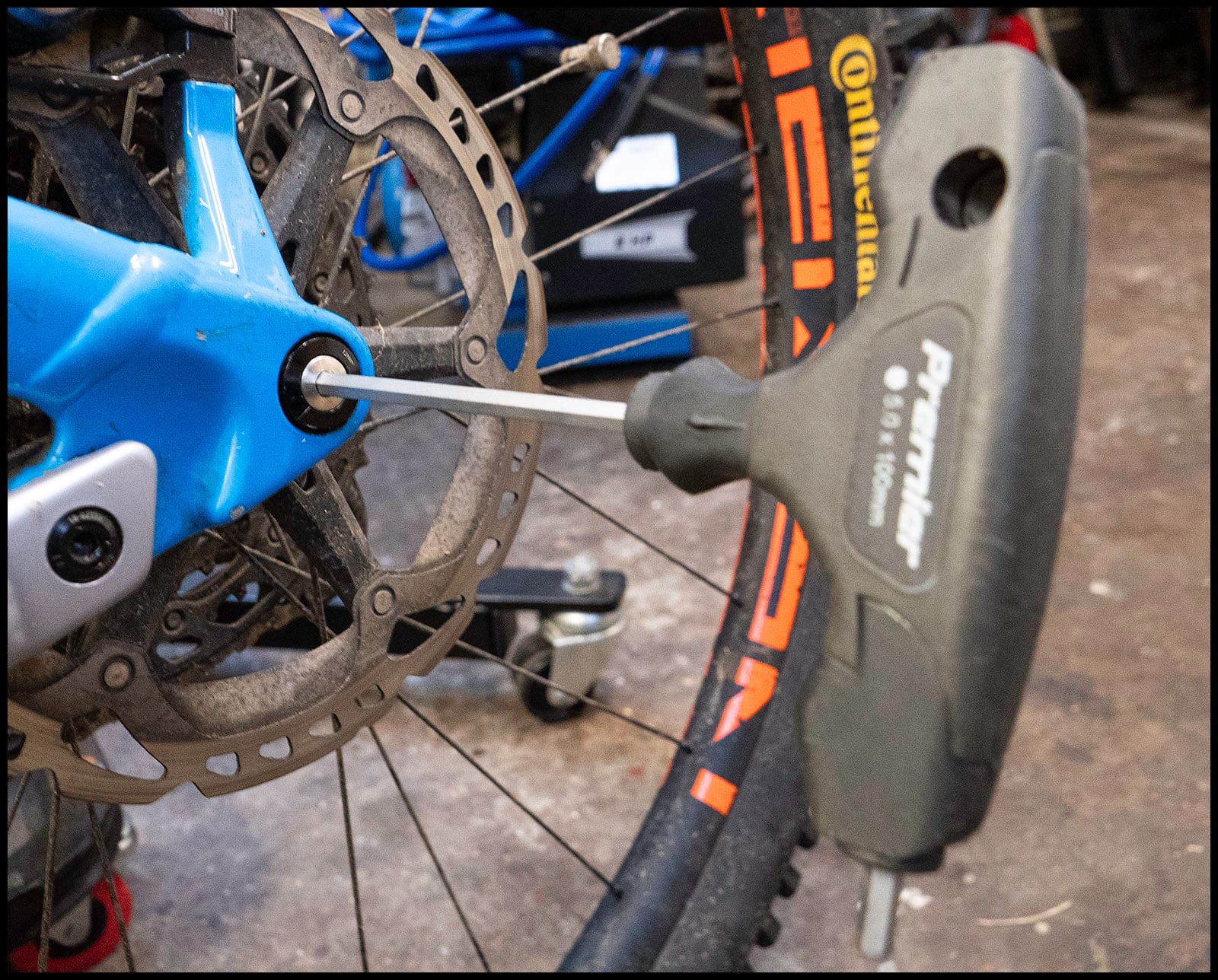

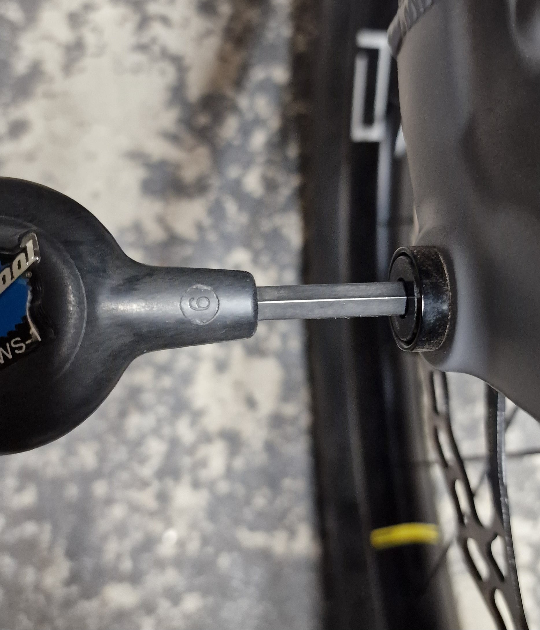

But yeah, I’m a bit confused. The axle should come out from the left side,ie the disc brake side, and is indeed marked 10Nm. I tried a 5mm allen T key – but it was too small, so I tried a 6mm allen T key but that was too big. I don’t seem to have a 5.5mm allen T key, but have a 5.5mm plain allen key which goes in but has loads of play. It just doesn’t feel right so I don’t want to put any pressure on it.

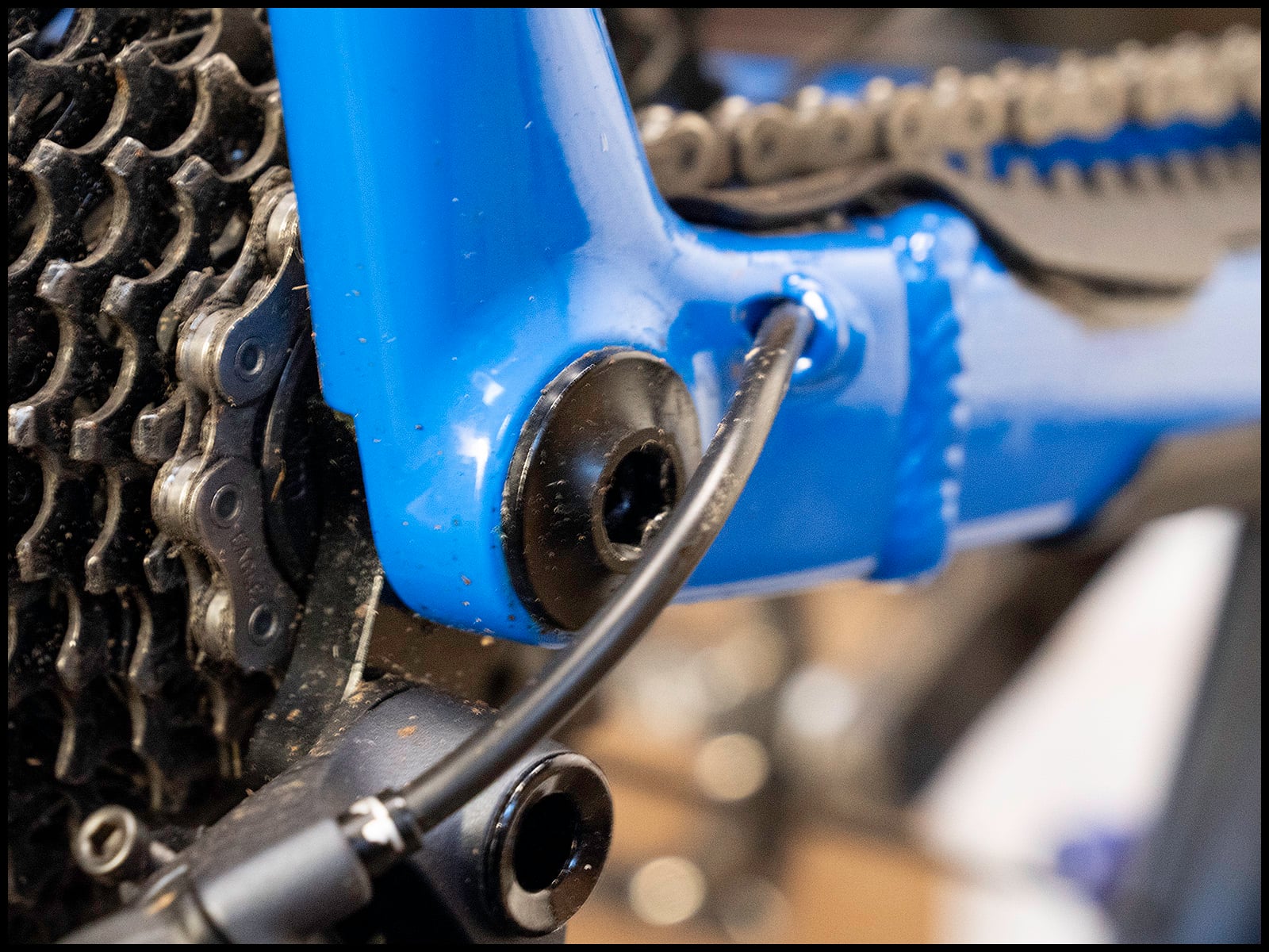

I looked at the other side. I presume that is an insert that the thru axle threads into – is that correct? It looks like it might be threaded in but the 8mm Allen head is very shallow (I’m thinking if that is threaded in maybe I need to grease it just in case it ever needs to be removed.

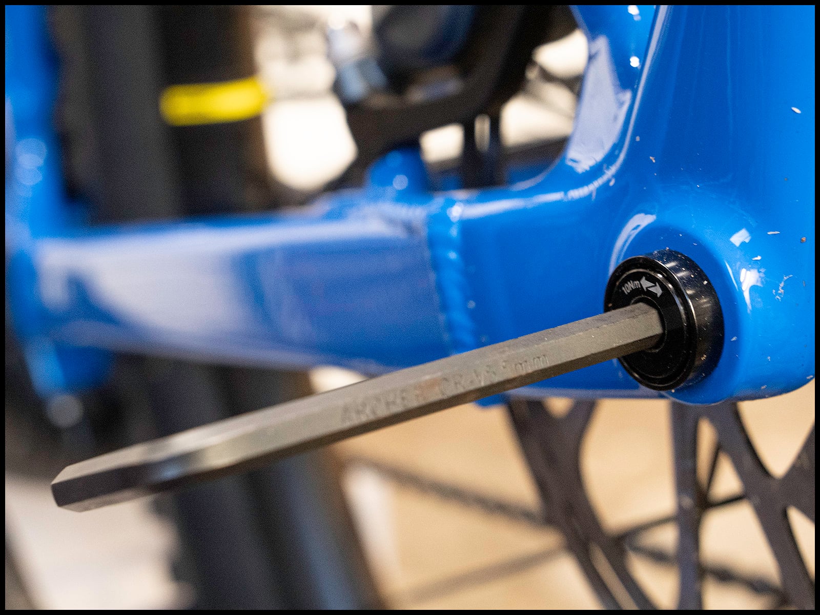

So then I dug out my Sealey Torx set. To my surprise a T40H fits snugly into the thru axle. So is a T40H torx required to remove the thru-axle.
