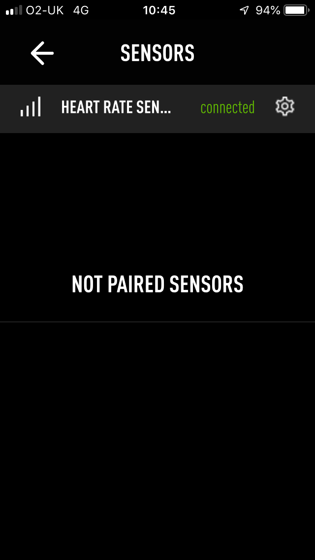

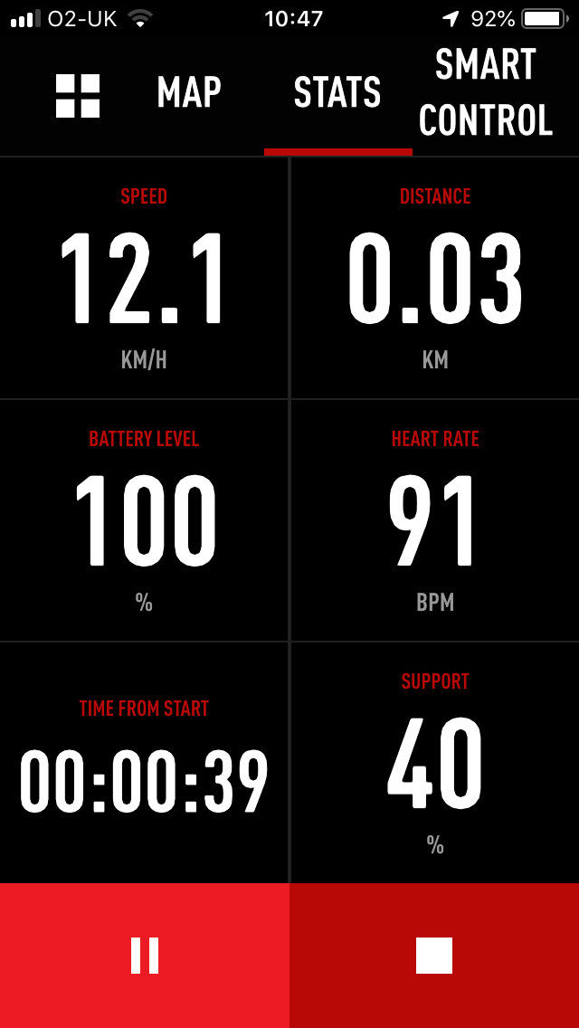

Hmmm, sorry to hear. I can dig into this for you - please confirm which phone and MC version you're running. Did you pair the HR sensor with the phone or with the MC app? You need to go into the MY SENSORS part of the MC settings and connect there (apologies if this is what you already did) - you can then check that the HR link is working as expected by going to STATS during LET'S RIDE and then configuring one of the cells to display heart rate (not average HR by the way) and monitoring this as you ride. If you see the numbers changing/looking right then MC is definitely picking up the strap and data - you could do a further test by using HR Smart Control and setting the threshold to 130 or 140 and then making sure as you increase HR the bike delivers more power. If you could record a ride in Mission Control once this is working and upload to Strava with no data it would be good to confirm. I may PM you and ask for the .fit file from MC and Strava separately to raise a ticket with our engineering team if you confirm this remains an issue.
iPhone SE (not the new one) ios 12.4.1
MC 2.3.0
Heart Rate connects fine and displays ok :)
I did two rides one with smart control and one without, still no hr data in strava :-(

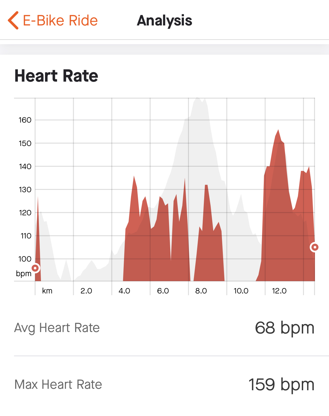

I have exactly the same problem. It started happening recently, perhaps with the latest update of the Mission Control app? Not sure.
I use an iPhone 11 Pro and a Wahoo Tickr Fit. The sensor is paired with the Mission Control app, and it shows as "connected" in "My Sensors". The heart rate tracks properly on the "stats" page, both exactly as in the screen shots by @James_MTB. Until recently, when I had things lined up to that point, heart rate data would show in Strava after the ride / data upload.
However, that has stopped working - there's no more heart rate data in Strava. I checked the .fit file (the one you can send to yourself via email in the "My Rides" UI) via GPXsee. It has a "heart_rate" column, but the values are all zero.
@Specialized Rider Care I would be happy to send over the .fit file. I can also send .fit files from when it DID work.
UPDATE: The last ride that had heart rate data is one I recorded on 5/24/2020. The HR stats (Average/Max/Min) show up when I click on that ride in "My Rides - History", and they also show in Strava. The .fit file for that ride has heart rate data.
All rides since then do not have HR data, neither in the Mission Control app, nor in Strava, even though heart rate showed properly in the "stats" UI during the ride. The .fit files for those rides have zero in the heart_rate column.
Not sure whether it's a coincidence or relevant, but all rides I did when I had named my bike ("Green Levo") also have no heart rate.
